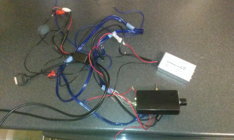

As I was sat in traffic today, I decided to pull out the headunit to see what lurked behind. This was prompted by the poor ice install from when I got the car.
I found many wires spliced together, and held with electrical tap. This is not for me, so I yanked it all out. I no longer have an iPod connection, but I am happy to sacrifice this for safety.

Bodgers , if your not going to do a good job in the first place DON'T do it . I bet your glad to get that spaghetti junction out . Could you not replace your head unit with an aftermarket one that has iPod & steering wheel control compatibility etc .

French electrics!
Seriously, can you see how the ipod was connected & do it properly again?

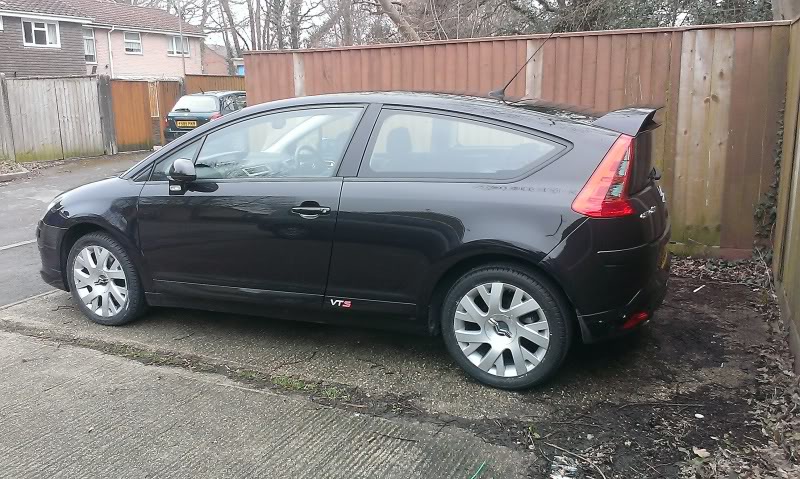

New rubber purchased today as the fronts were pretty low. I did a deal on 4 Avon ZR5's, and changed the profile from 205/50/17 to 215/45/17 as they are significantly cheaper.
Does mean I am left with 2 marshalls with 4mm left in the incorrect size mind you....Make me an offer if interested.
Captain Slow
- Posts: 220
- Joined: 10 Aug 2012, 10:56
- x 3
Re: C4 VTS 180 Blog
Gah! The sensor to fix the lights is the wrong one!
In other news I removed the rear flaps today. I think it looks much better.
I have also just returned from a 220 mile round trip, and can't quite explain how much of a difference the tyres have made to this car. Beforehand, the ride was frankly appalling. It would crash over every slight imperfection in the road. Now the ride is much smoother. Don't get me wrong, its still bumpy, but nowhere near as bad as it was. It really is like driving a different car. So much happier
