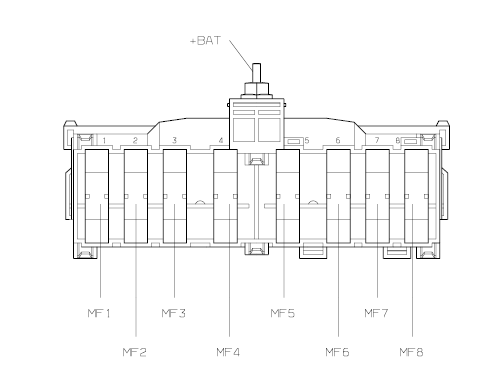

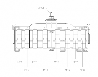

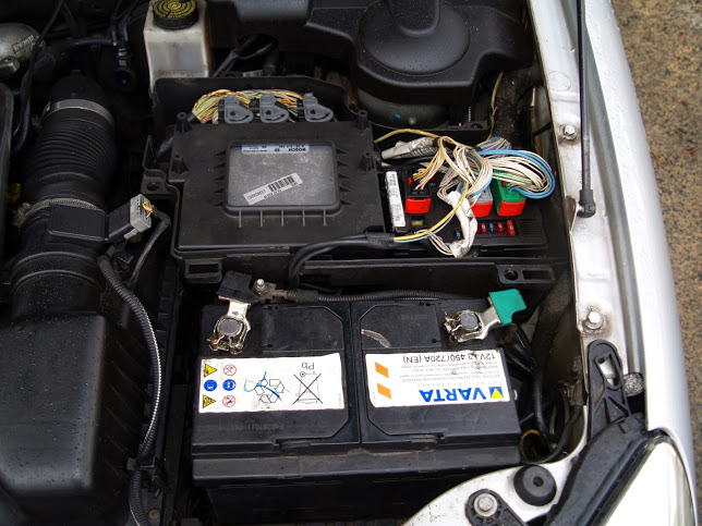

Behind the battery is the main fuse box. You need to disconnect it (follow the disconnect/reconnect procedure).
Carefully unclip the fusebox and lift the front, there is a row of Maxi fuses. Check for which is blown (if any) and replace.
My handbook does not indicate which is the relevant fuse unfortunately, as they should only be accessed by a trained Citroen mechanic
The height sensors are attached to the anti roll bars front and rear. Note that a very small adjustment to them produces a pronounced difference in the ride height.

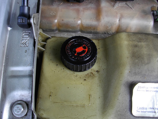

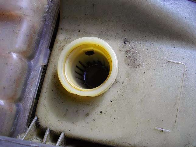

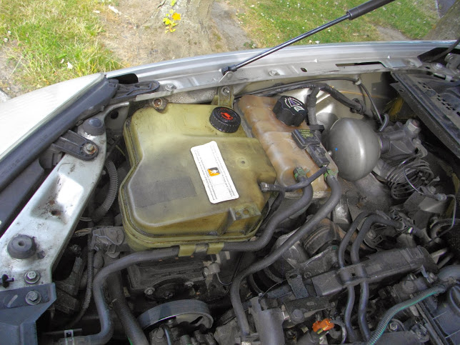

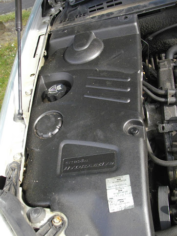

Further to that but most probably not necessary is the location of the LDS reservoir.

thanks for taking the time to put photos on i would never have found that one if i had seen that 3days ago i would have saved a lot of time and trouble .

Relevant Maxi Fuses on a 2005 C5 MK II:
MF7 70A power steering electropump unit (Engines EW10A (RFJ) - DW10BTED4 (RHR))
MF8 40A central electronic block motor
Maxi Fuses:
Maxi Fuses:
