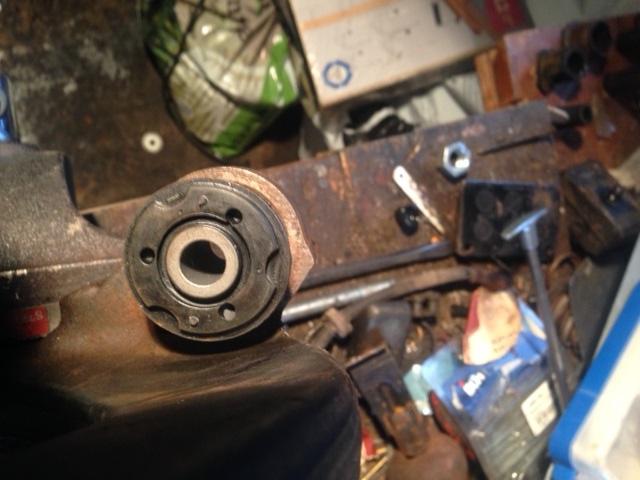

What about the FRONT bush, the on with no clamp ? Should it be installed in certain position ? I mean there are three "holes" in the rubber, should they be in certain position with the wishbone arm ? A diagram or picture would be nice

I got no aswer to my question so I decided to install the bus as seen in this picture. I thought that MAYBE knot on the wisbone arm is some kind of markfangorn wrote:What about the FRONT bush, the on with no clamp ? Should it be installed in certain position ? I mean there are three "holes" in the rubber, should they be in certain position with the wishbone arm ? A diagram or picture would be nice
In the picture the bush is yet not pressed in so it can look weird,,,

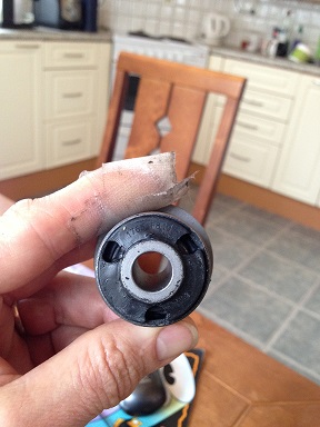

Those "top hat" shaped bushes are not usually critical, though in some applications they can be.
Having done a post-mortem on mine (they're cheap, so not worth saving used ones!), I'm confident the Xantia ones are of the non critical variety.
They're tougher than usual for this type of bushing, having a third metal component between the inner and outer surfaces. The only thing to be careful of is not to tighten the center bolt until the suspension is at normal running height.
Hope that helps

That's the problem I have had with mine! It's this metal sleeve in between the inner and outer ones that's causing mine to "clunk." I'll remember to set the wheels on the road before tightening the bolts on this rear bush next time!sparksie wrote:Hi Fanghorn
Hope that helps
