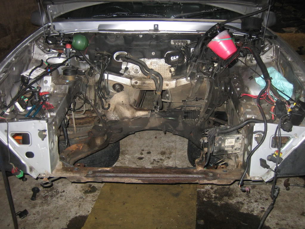

Been out and had a good spanner this evening...
The nosecone is nearly off and the rads are dangling
But by golly, the XM is a bit of a rat's nest electrical-wise. Looks like the ES9 installation in there, unlike the Xantia, was a real Friday afternoon job and the wiring looks like another Stevie Wonder/Ray Charles job.
Got to admit, it's bloody awful
No wonder XMs were prone to the odd electrical issue. No bloody surprise really
As I say, the front is nearly off but the wiring to the rad fans seems to be a deterrent to removing the front completely or am I missing a trick?
The car is in my opinion borderline restorable. It appears very rusty in places and determined to find the extent of the crustiness I unkindly attacked all structural bits with hammers and pointy things and despite lots and lots and lots of surface rust all the structural bits are as sound as a pound.
The coolant rad is a bit suspect. It looks like it's leaking a bit but not so bad as it won't at least do for a bit yet.
I can't see how to avoid depressurising the A/C system as the condenser is going to have to come off to get the engine out or am I again missing a trick?
She looks bad and is bad in places but the general overall condition means the restoration is on for now unless a big showstopper rears it's ugly head.
On the corrosion side of things, I can only assume the whole of Scotland is made of salt if the surface rust is anything to go by. The poor car looks like it's been living in the sea for a few years
Still, hopefully caught in time...

Hi Jim,
Glad to hear that you have made some progress with the car.
The wiring for the fans will undo somewhere along the ways, its not obvious at first, but will appear later.
When I did my conversion, I removed the whole A/C system, its the easiest way, and it will give you more space when lifting the engine out. Although some people will pull the A/C rad over to the passengers side to give clearance.
Xms can rust a bit at the front end, the most common place is the support brace that runs behind the front bumper, not the end of the world, other front end rust is the brackets where the wings and bumpers mount to.
Its not uncommon for late Xms to need a bit of welding, but re-application of gravitex will keep any more rot at bay for a while.

Sounds like your having fun Jim with the Xm , for your rust issues give this a try , apparently very good stuff http://www.bilthamber.com/deoxgel.html

I couldnt find anywhere to undo the rad fan wiring so just let the front but hang loose!.
Sounds like the angle grinder is called for to clean back the rust!
Whilst the front is off make sure to clean and protect the metal bumber insert, as robert sais, I have seen what happens when there is nothing left.
Whilst the front end was off I did the front crossmember as this was rusted I assume due to moisture from the air con and heat from the rads.
Dave

Unless it changed for the ES9 implant, Jim should be able to take off the nosecone like a 605 - complete with headlights, air horn and fans. There's only a few wiring plugs to disconnect.
Anyhow, seeing as you're nine-tenths into doing it the hard way, here's the fan disconnect details:
Flick off the two metal U clips (watch where they go!) and then prise open the plug flip cover above. Then there's a right-angled plug you wiggle back out. Once this is done, the wiring ought be off fully.
Here's my muddy one recently:
Took several hours to dismantle and clean it all, and there's still minor "glass" repairs needed. Oh well...
