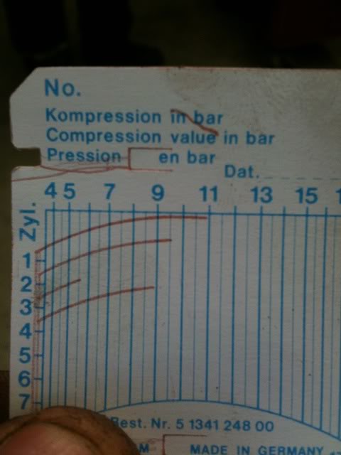

Cylinder 1 very oily and it had most compression :P

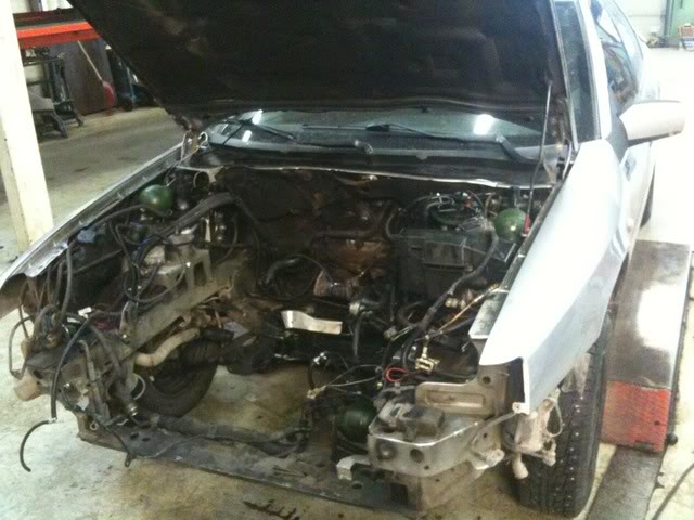

Some progress:
BX 16V -89 "lowrider" , Xantia HDi -99, Visa 14TRS -86, 2CV -71 ("daddy loaners" : Dyane -74, DS Super -72, C5 2.0HDi -07, 2CV Mixte -62, 2CV4 -72)
Posts: 54699
x 8153
No. 3 cylinder looks a tad low Jeth...
My goodness, you work quickly :D You have not let the grass grow under your feet there!!!!
(a quaint old English expression to describe someone who works fast...)

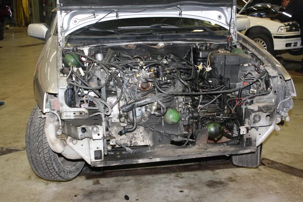

And then engine came out:
Posts: 54699
x 8153
Putting a positive spin on things Jeth, you now have an ideal opportunity to really clean the engine bay and make it look nice :wink:
Looking forward to hearing news of what let go inside the engine...

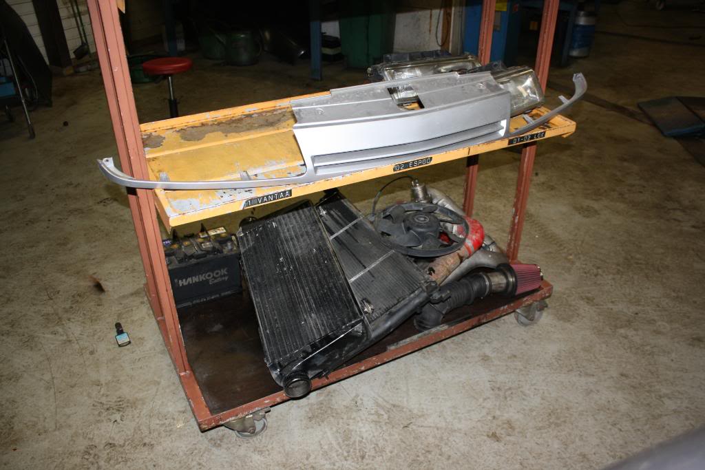

Project has been standing still for a while now, I did open the engine, piston rings and pistons etc. are looking good, only headgasket had blown really badly..
Oh well, now that engine is stripped im building it with new stock parts, and sadly selling it after getting it running :/
Already sold VEMS and turbo I used on it..
