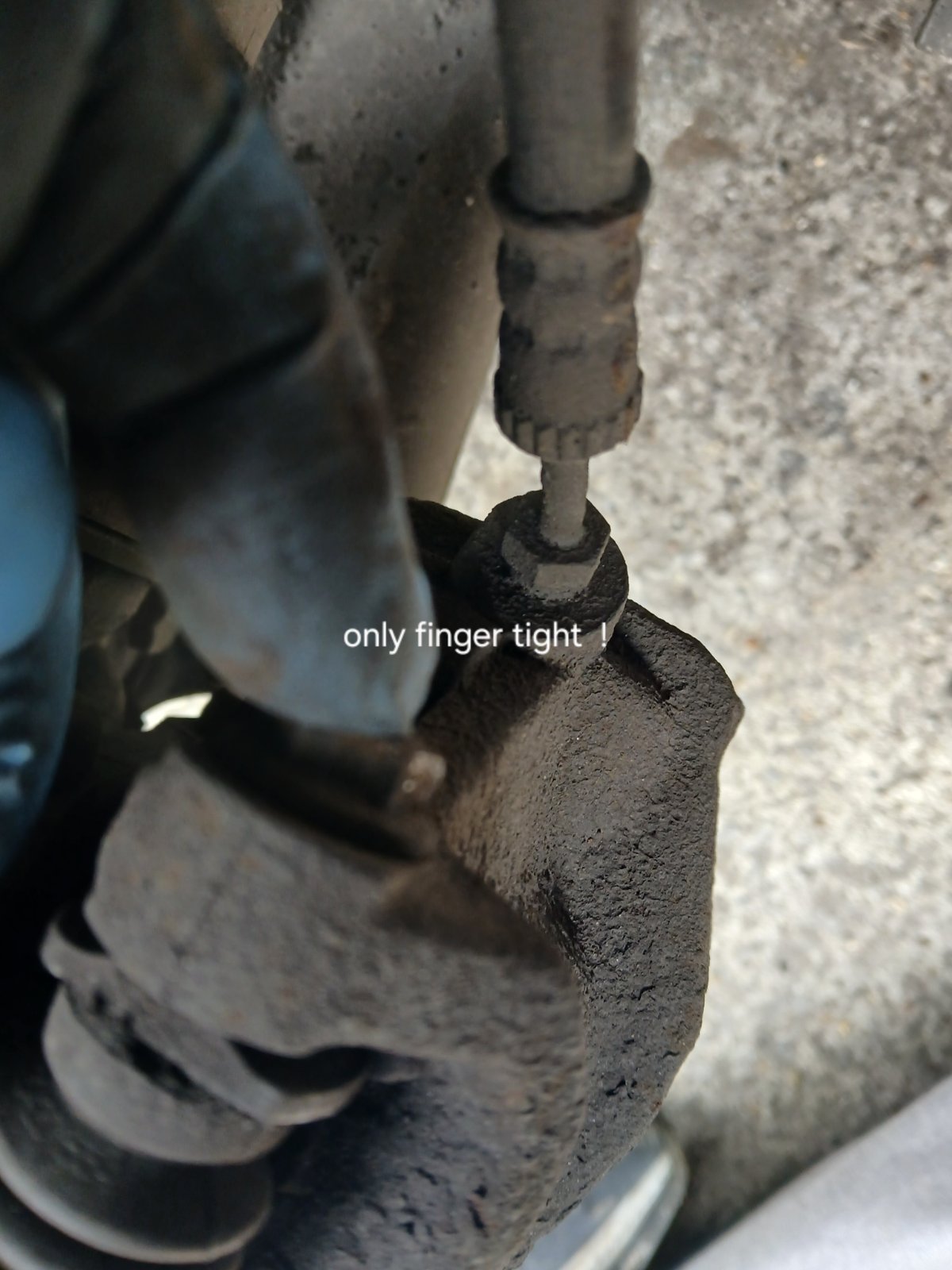

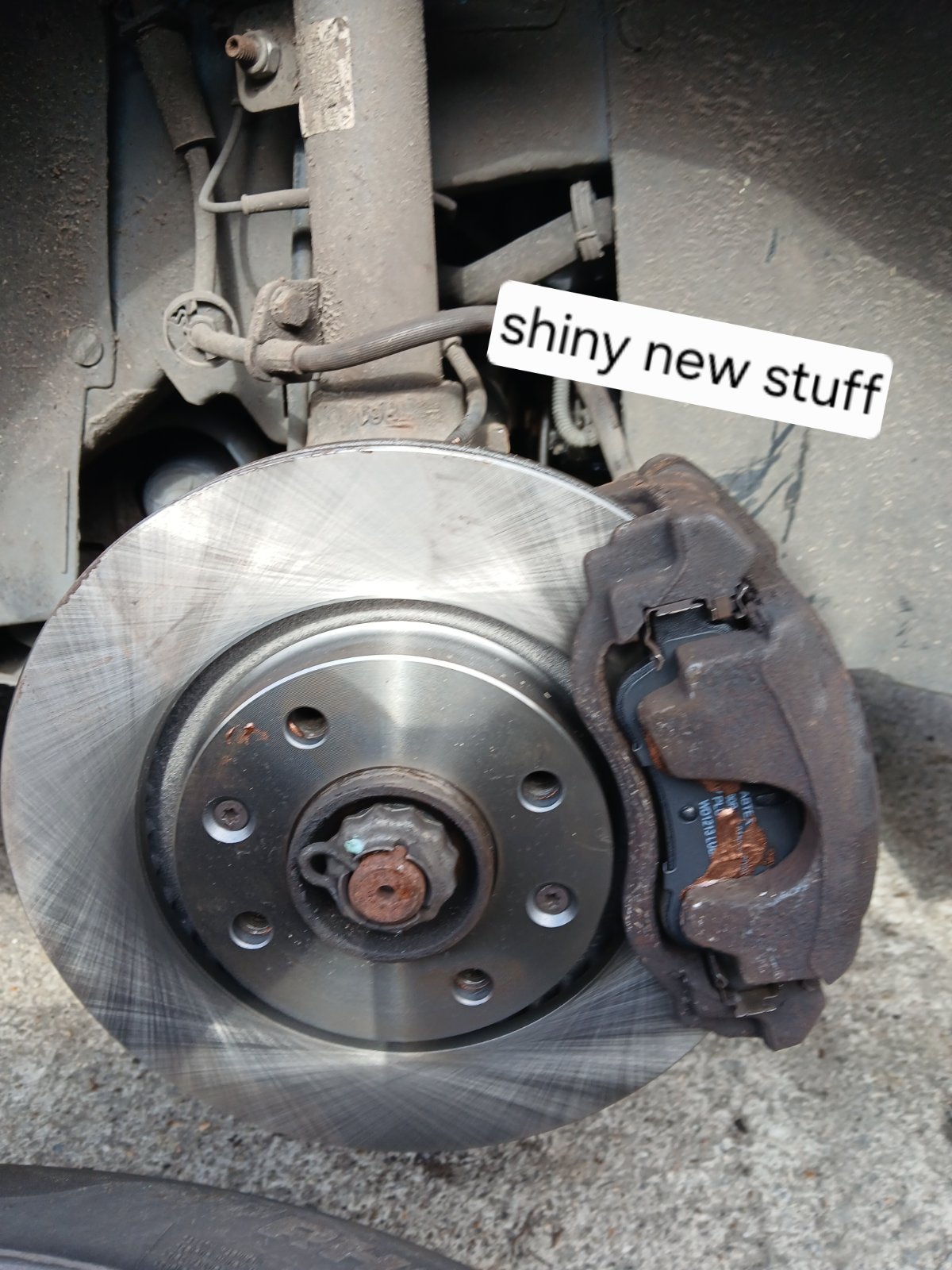

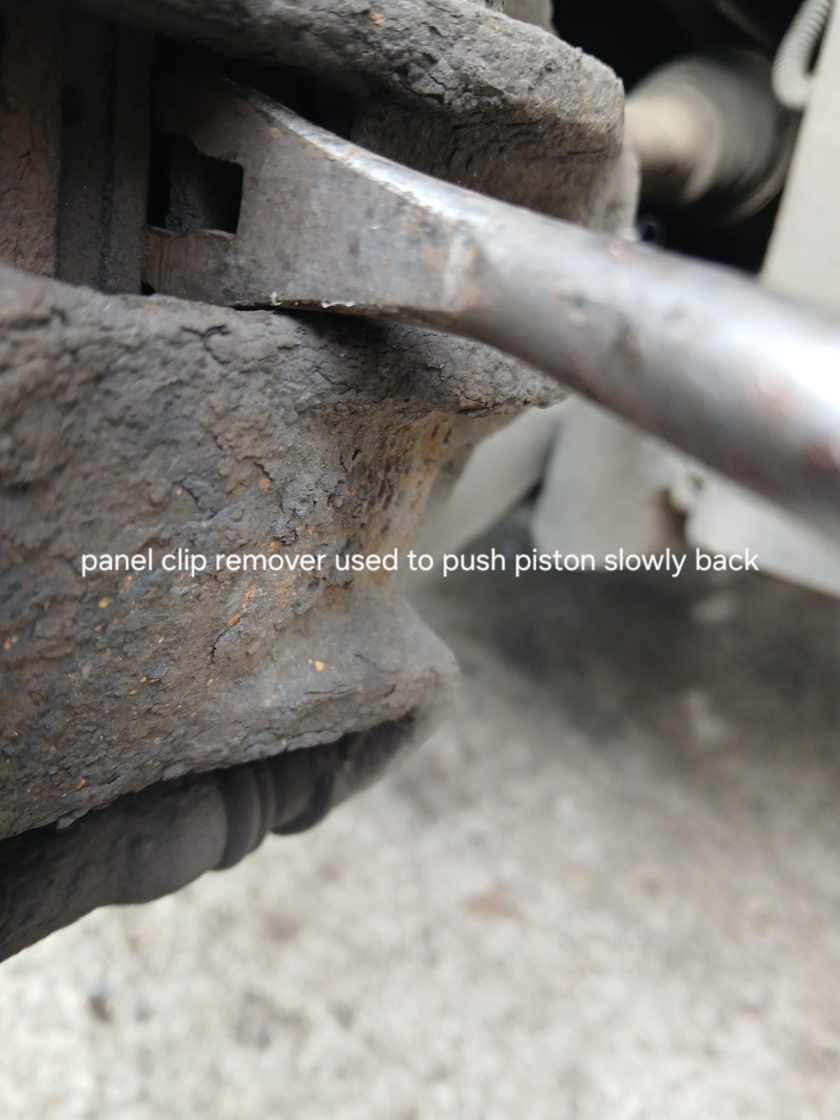

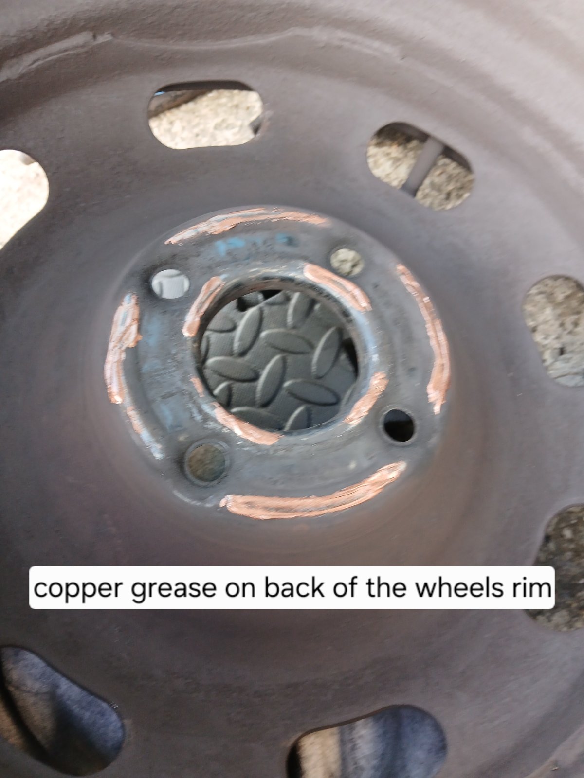

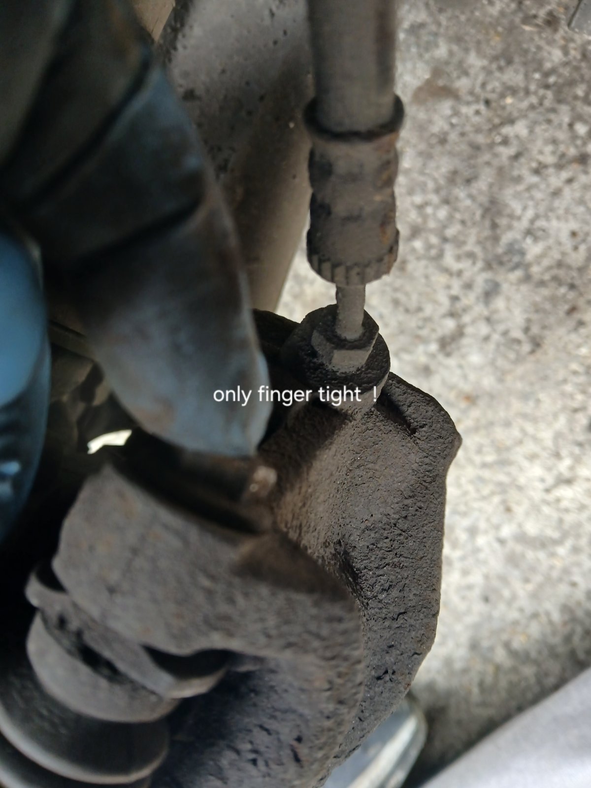

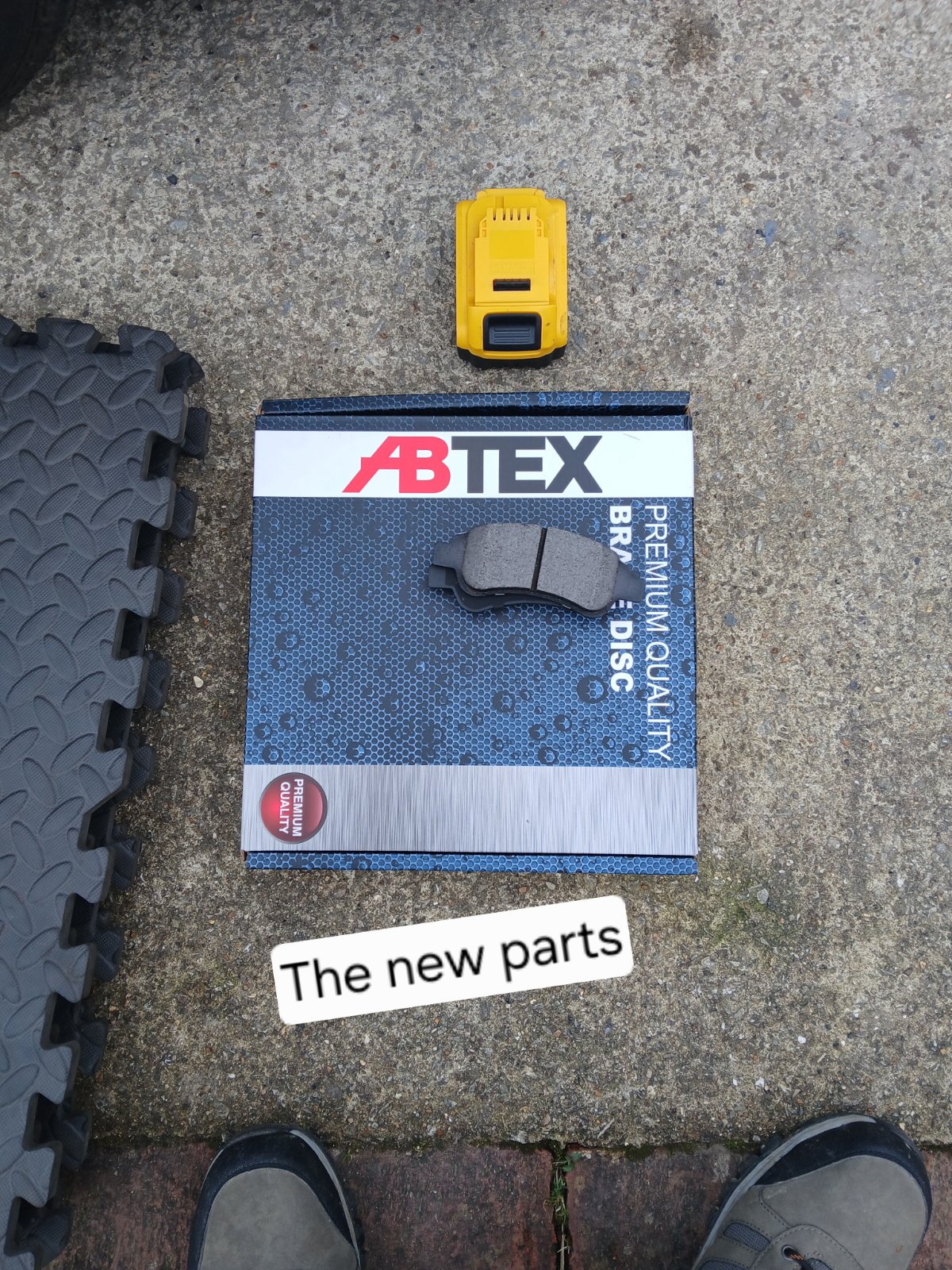

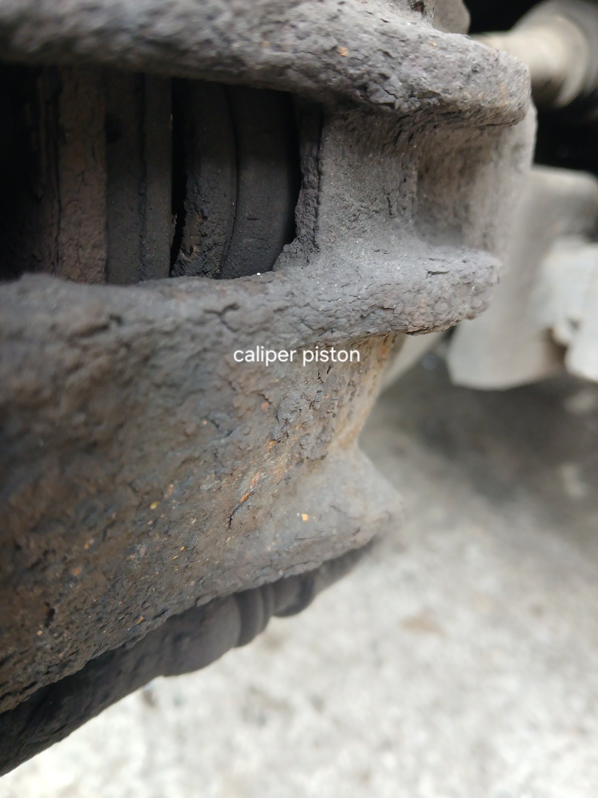

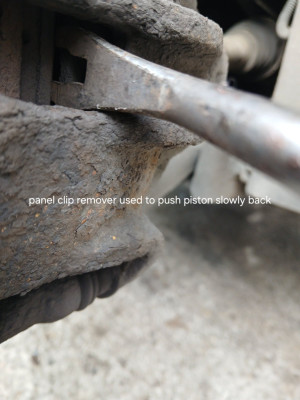

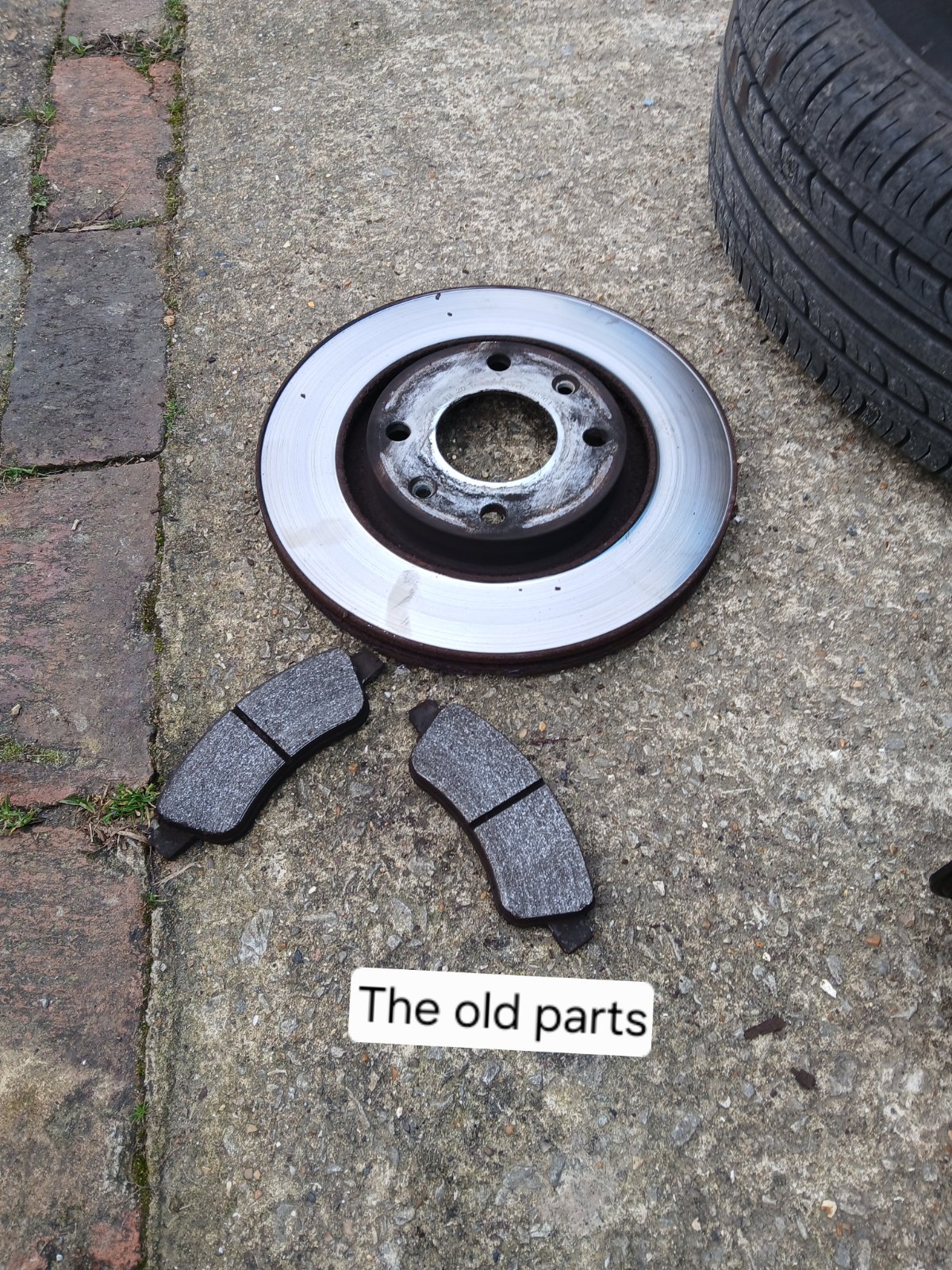

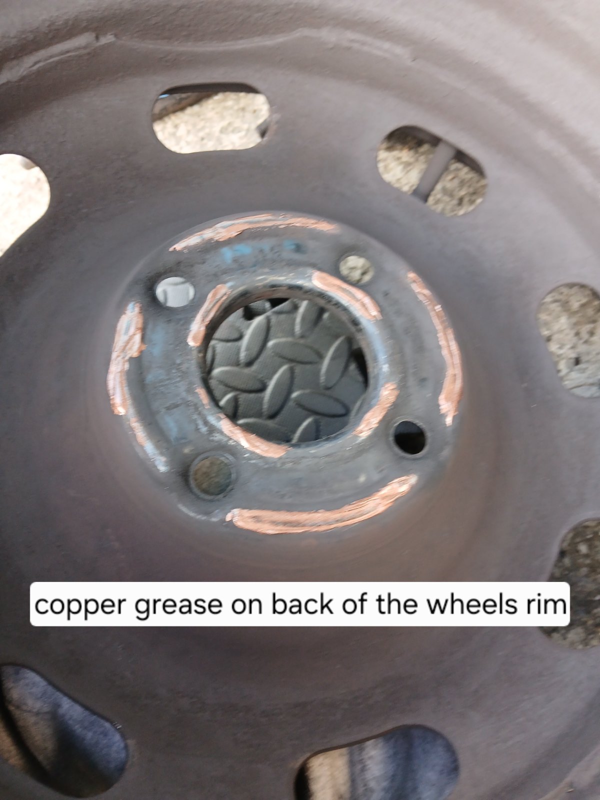

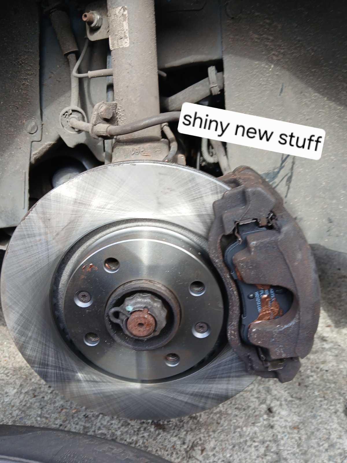

So one side brake pad caliper housing bolts were finger tight !
.... photos explain things. Both front and and back are all done , the front pads have bedded in nicely and the braking is uniformed .

Re: Peugeot 207 1.6hdi (New edition to the fleet)
Gosh! Only finger tight... Well found Husky
Definitely was Jim. One of them omg moments that's for sure
Indeed yes and if I had a pound for every one of those I've had I'd be quite wealthy....
Eek!
When the green 306 HDi first came into our possession (after a test ride= fine! And about an hour's drive home = fine!) it went into service as Sarah's daily transport for her short commute (about 5 miles each way) a relatively new driver at the time it was somewhat of a culture shock versus her brother's Chevrolet Kalos 1 litre, but in typical fashion she took it in her stride....
... Until the fourth day of use when it quite literally ground to a halt. As it turned out, all four front caliper mounting bolts were loose, so loose in fact that a couple had left and allowed the caliper to rotate a fraction and wedge itself against inside of the rim!
A short while later I had opportunity to look at it's rear brakes. In defence of whoever had "fixed" it brakes (presumably at some point not long before we bought it), they had not left all those loose too!
