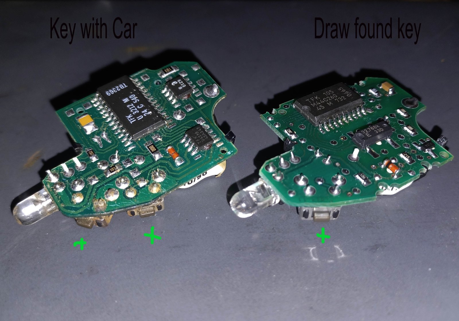

Keys, remote etc....the key I have with the car (two button) does not work (I think)
I have done the phone camera trick....the red LED works but there is no "flash" from the clear/IR LED. This is true for both buttons, yes/red LED....but no flash
The found one does flash & red LED but is a single button key....is the "found" one a S2 car's key ?
Thoughts ?
Any one got a S1 two button key they do not need with a good rubber pad ?
China, are the keys (£1.50 ish) worth getting ?
Thoughts ?

The single button key will be from a non-uk car, but maybe your car will accept it.
The faulty 2 button key fob likely just needs the chips re soldering.

I purchased the china cheapy 3 yr ago for a 206 , used for spare , coded ok , cut ok & did the job, tbh the quality of the key wasnt to bad. For the price its worth a try.

Cheers on the key.....going to splash the cash on one, need to budget for the £2.50 + free shipping !
