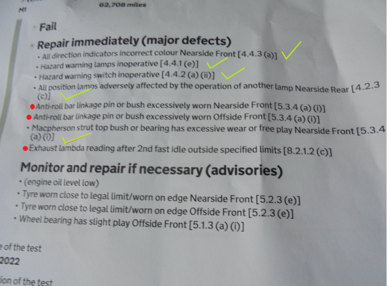

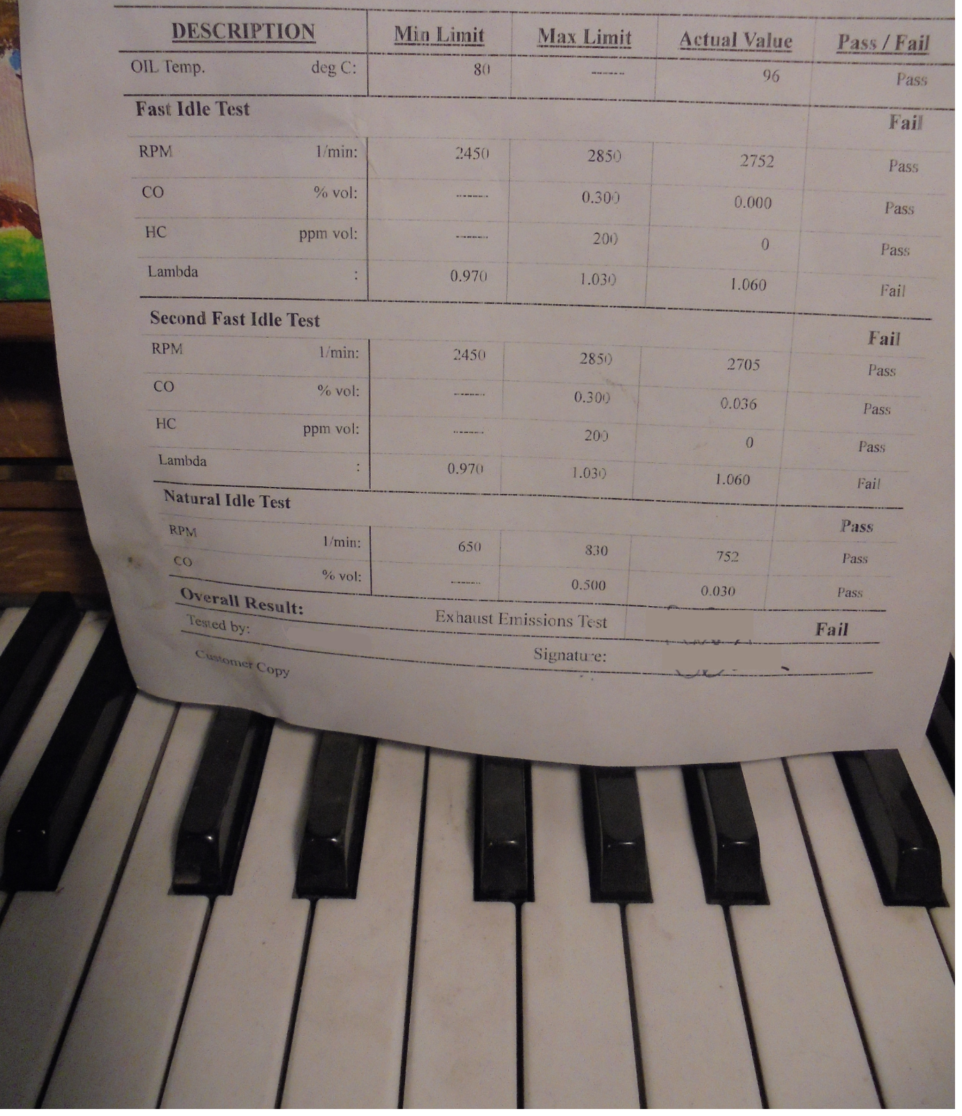

Do you have the full exhaust emissions print out? Lambda > 1 = excess air, and may indicate a vacuum leak somewhere. If the CO is OK, then the CAT is working.
Mine got an advisory for a number plate not working, but every time I have looked at it, it has been on!!
Strut top might need the strut out and dismantled to fit a new bearing?

Thanks Richard, l will photograph the emission test results and post them up later, out and about just now, and if yourself or others could help me with the interpretation that would be very helpful.RichardW wrote: 10 Feb 2022, 14:43 Do you have the full exhaust emissions print out? Lambda > 1 = excess air, and may indicate a vacuum leak somewhere. If the CO is OK, then the CAT is working.

Found some comments re Lambda emissions test fail on the lean side. (BMW M3 forum)
Might be something as simple as a minor exhaust leak. I did put a backbox on it in prep for the MOT and never bothered with any gungum on the joint, and the pipe joins to the new box were a very poor example of the art of welding.
I presume stuffing a probe up the exhaust pipe is the test method used, rather than direct interrogation of the lambda sensors and a post cat leak may return a lean reading.

Here's the MOT emissions test results

Def either running lean or there is an air leak into the exhaust, the CO and HC are almost non existant. Are there any running problems? It could be a vac leak D/S of the MAF confusing things. You could do with getting it on a diag machine to see what the O2 sensors are doing and what the fuel trims are. It could be sucking air in at the back box, but they normally leak out there.... What sensors were put in? Cheap aftermarket ones can cause all sorts of mayhem!

Thanks RichardRichardW wrote: 10 Feb 2022, 22:32 Def either running lean or there is an air leak into the exhaust, the CO and HC are almost non existent. Are there any running problems? It could be a vac leak D/S of the MAF confusing things. You could do with getting it on a diag machine to see what the O2 sensors are doing and what the fuel trims are. It could be sucking air in at the back box, but they normally leak out there.... What sensors were put in? Cheap aftermarket ones can cause all sorts of mayhem!
No discernible running problems, plenty enough poke, starts well, idles well after initial start up and temporary fast running from cold, starts fine too when warmed up. Haven't changed the spark plugs for the last 25,000 miles, no misfires/hesitation or anything. Cant be sure which O2 sensors were fitted but no running problems or fault codes cropping up.
I don't think even if you can adjust fuel trims, which I don't have the diagnostic tools to do, it would be worthwhile.
The Cat seems to be doing its job, despite its outward appearance after 18 years so I'll not be throwing a new cat at the problem just yet.
Fingers crossed, I will be heading for the possible exhaust leak, or vacuum leak (although no consequent running problems/starting problems) a bit of injection cleaner, some Esso Synergy Supreme+ 99 Unleaded fuel, and maybe a largely pointless Italian tune up on the way to the test centre for a free retest.
Cant really see how with zero ppm HC (not sure how that happens) and CO well within limits that a marginal excess of oxygen is a problem at all, never mind a failure in a MOT test.

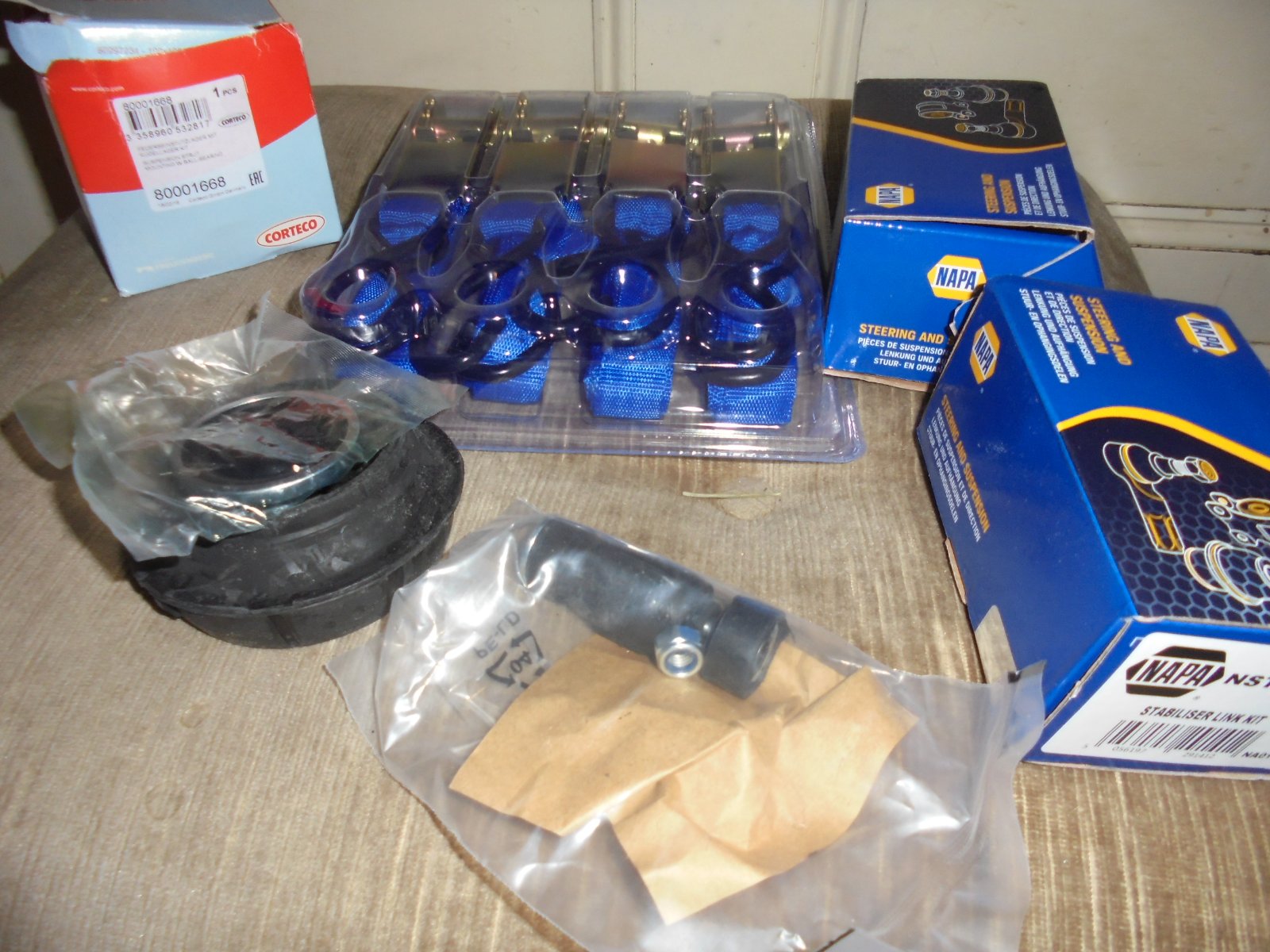

One of the jobs, now where is that T27 Torx bit...depends which one is fitted some are a meatier T40.
Anti Roll Bar Links not much over £5 each. Not your normal drop link on the Clio.
I like Autodoc's videos. Usually give a decent view of what's involved in the job and ther's plenty of them for the Clio 2.

From that video it looks a bit more fiddly than swapping out double ended conventional drop links! Easy enough with a 2 post lift and transmission jack handy but more of a pig on an axle stand methinks. Case of perseverence I'm sure. Good luck!

The major problem, apart from the near zero temperature in the alfresco "workshop", may be a rusted top of the bolt with the torx head, but there does look reasonable access to grind off the nut at the bottom if the nut and bolt won't loosen.

Collection of parts and tools for the mechanical bits. Just over £30 at local factors.
Those ARB links look particularly "light duty". Pleased I could get a new set of spring compressors for £6 ish at Yorkshire Trading.
