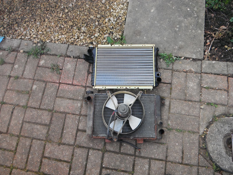

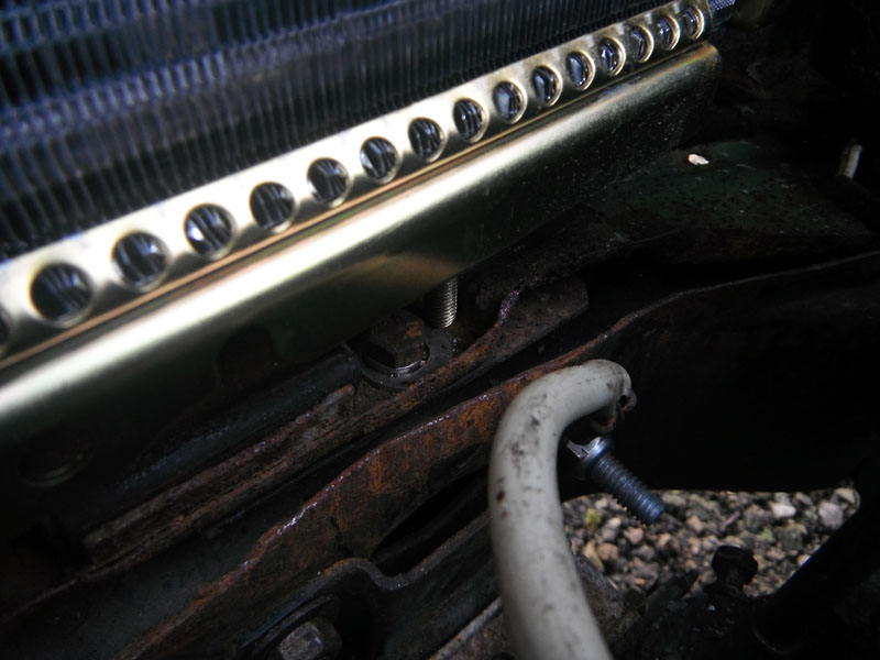

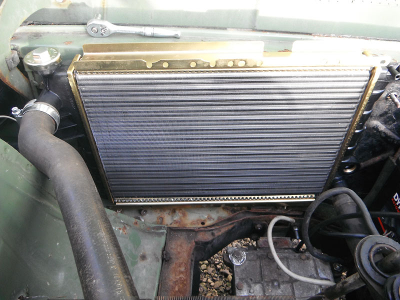

One thing I did do was compare my brand new early R5 radiator with my old late R6 radiator properly. I knew the new rad probably would fit as I'd seen videos of cars running with them fitted. It's surprising how similar they are in size and should be able to be modified to fit without too much grief.
Both hoses line up exactly, the temperature sender looks to be the same (didn't have a big enough spanner/socket to find out exactly) and the only issue really is having the one long bolt sticking out the bottom that I need to chop off or drop in the bolt hole it lines up with. To fix to the 6 I'll make some little clamp type brackets for the top and bolt it securely in that way.
