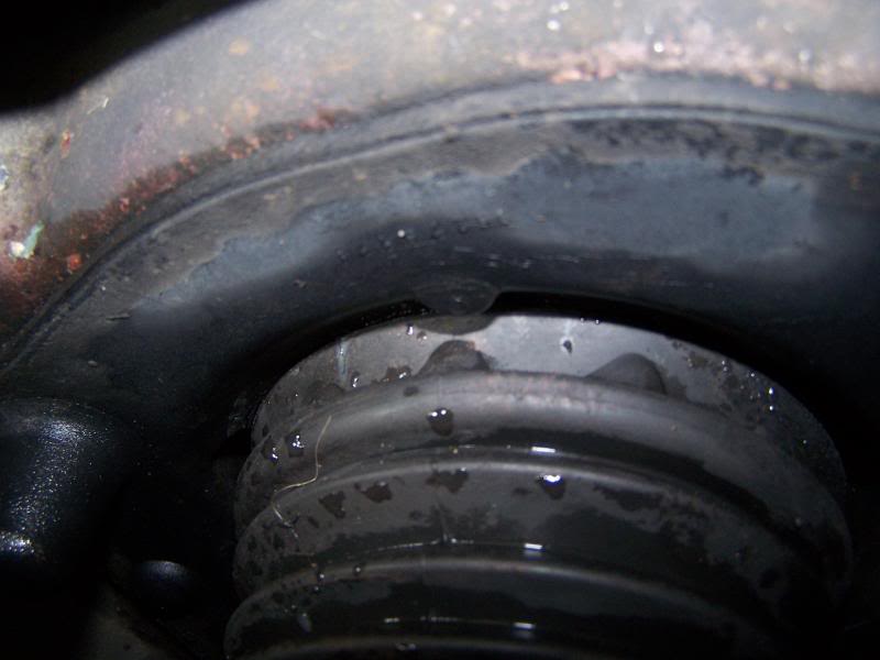

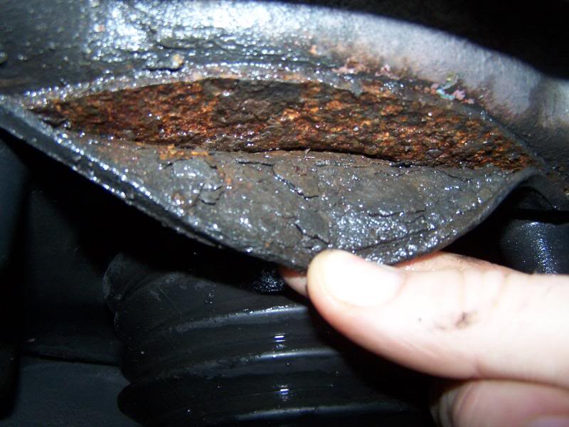

Hope GSF can supply these at a good price as I would like to do the near side on mine. The rubber has come away and is flapping around, it does look a bit rusty under there. It would need to be in the next week or 2 as we are all off to Norway on the 14th Aug.

I realise it's easy to say, and hell I know myself the usual circumstances,
but the safety, reliability and useabilty of your Xantiae need to be weighed
against the limitng factor of just going out and fitting a new strut top
= COST!!
In a worst case scenario, a real road trip/holiday would be ruined and
could develop into a farce should you have one fail on the run - for
peace of mind at least; a through examination of the top, particularly
around the strut top at the wheel arch circular cut out from inside the
engine bay would be my area of attention and obviously the underside
collar - the flappy loose rubber covering may now actually stop trapping
moisture against the vulnerable metal underneath - it needs as much
thickness of metal there as possible!!
All the best,
Andrew
