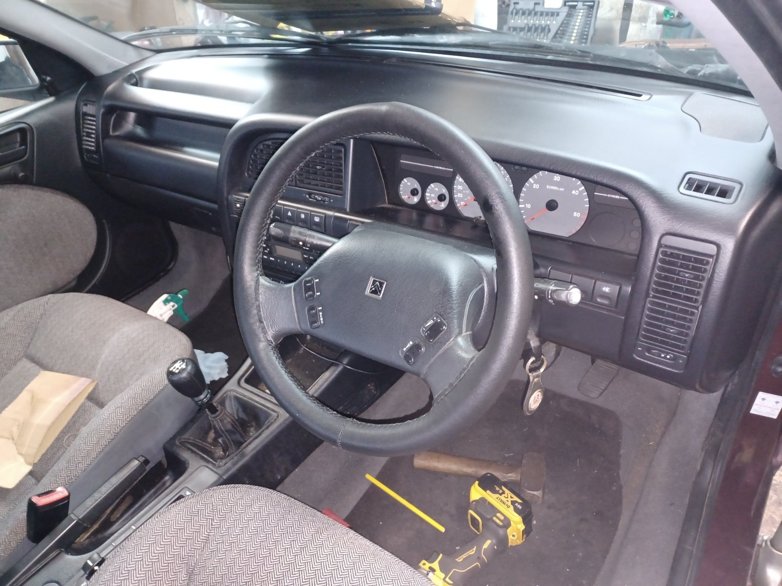

Steering wheel is off, no screws as there is no Airbag on a sinker, the front cover just clips on....all finished with the sewing the new #leather# cover now so ready to go back on......that will reduce my hand-sanitiser usage ! I removed it as sewing the cover with it on was a total PITA.
Both handbrakes now released...I think one side (F_R with the mystery short cable) is playing up, I will lift them both, fully push back the pistons and swing them both down in place again.
Lets see what that does to their operation and if the "sticking" goes away.

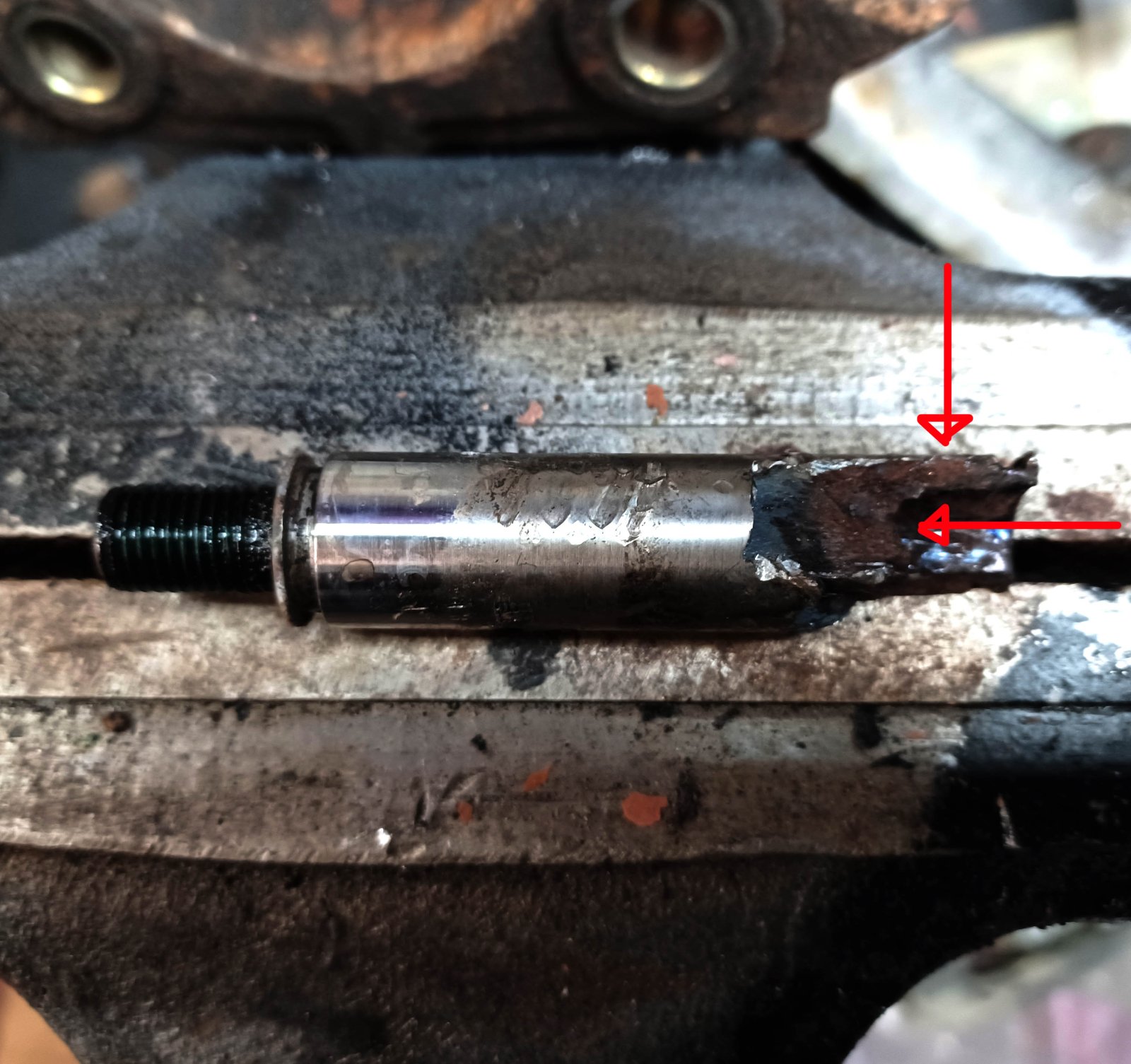

Re: Xantia 1.9TD....wake up and back on the road after 10 Years
Finished the steering wheel........turned out OK

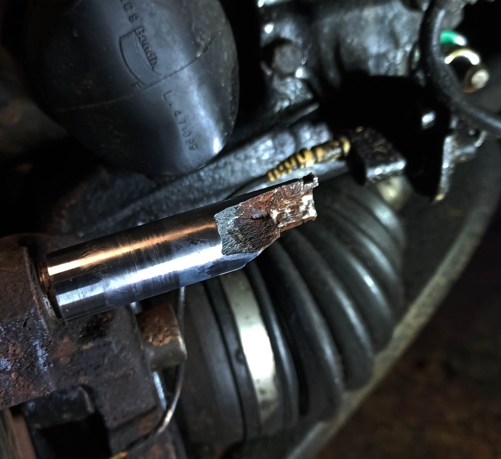

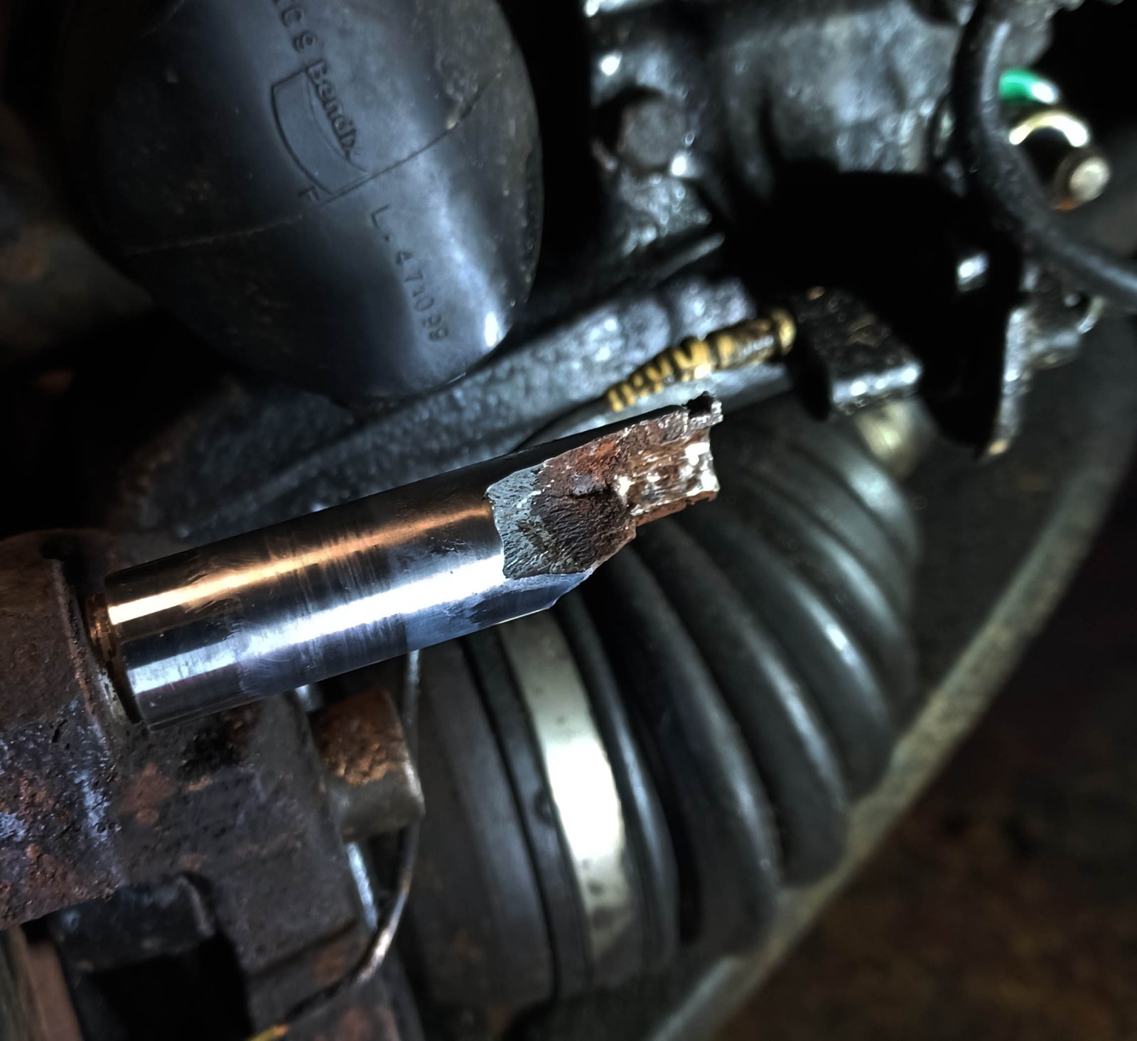

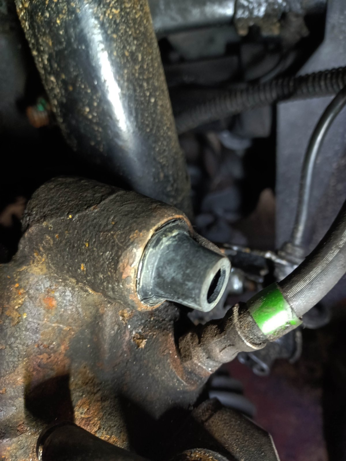

OK, so I found something......bu@@er !..........I had a go at the binding brake caliper (RHS)
Took the locking pin/pads out...OK

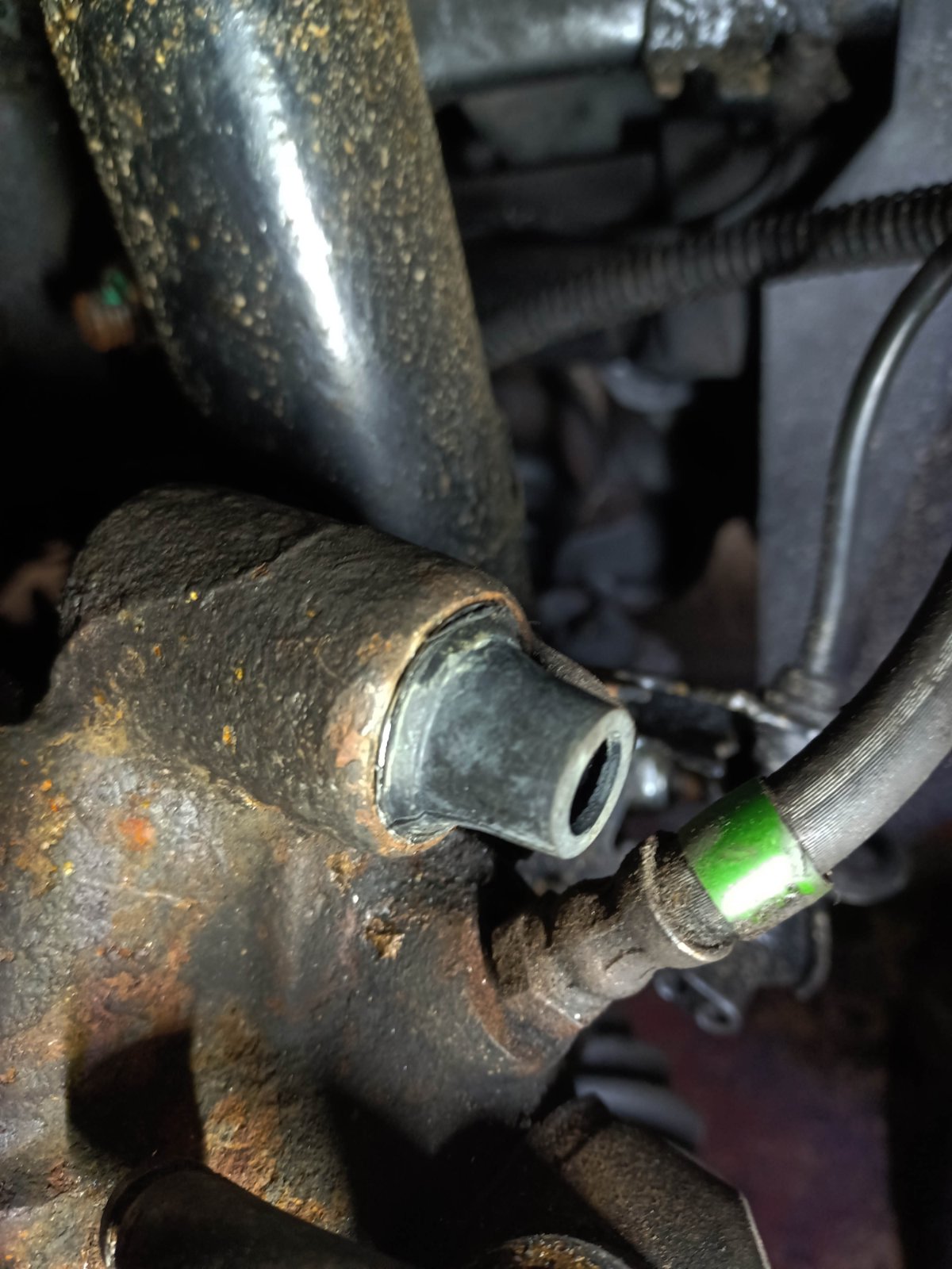

The caliper did not seem to slide very well....so I decided to remove it and inspect the slide pin.....that is where the fun started.

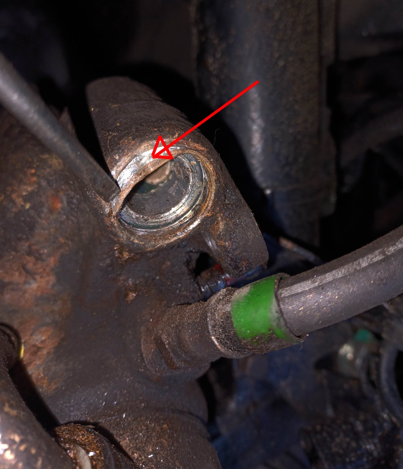

I inserted the hex socket, seemed "loose"....but preceded, it just slipped ?? I checked its size in the other side, perfect.....had another go with the same result so I got my head in and squinted, huumm, it looked strange so I tried to slide the caliper off the pin, no go, it stuck !
I noticed the boot was split so I removed all the rubber I could grab...........then I noticed the PIN was flared out at the end and had a fracture running down it !
I grabbed the edges with some small pliers and two bits came away with a small bit of tugging.....bu@@er !

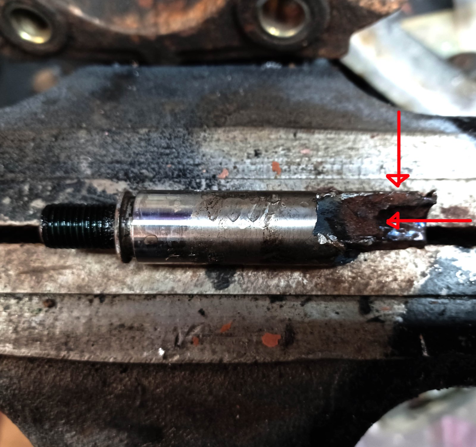

I removed the caliper and with mole grips/a lot of head tried to remove the pin.....no chance.....so I removed the carrier and took it to the bench where more heat, my vice and a hammer got it moving.
This is what I found. Note, the rusted area extends out to the edge of the fracture, I suspect at the last pad change a socket has been hammered into the hex, maybe they used a Torx in error With the slider pin removed I cleaned up the caliper, removed the remains of the now destroyed outside slider seal. New seal refitted, a new slider from my spares shelf to go with it has also been fitted.
