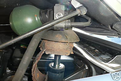

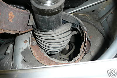

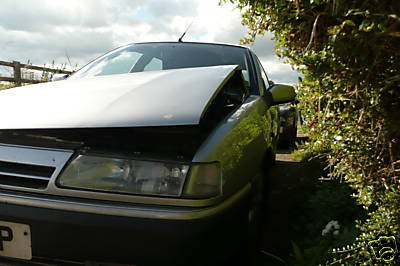

"Coming over a hump back bridge, the front n/s suspension strut ripped
free of (obviously rotten) mounting and drove up into under side of bonnet."
Like I said - this problem isn't going to go away any time soon...
