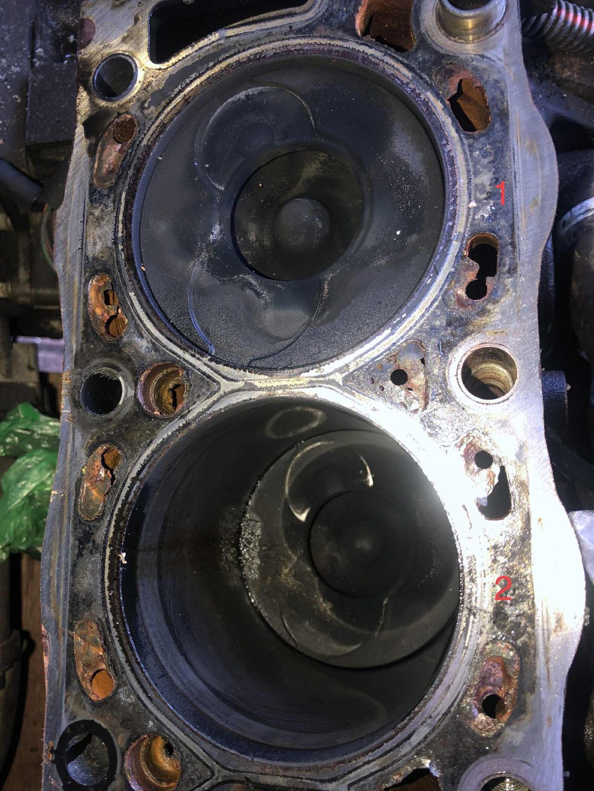

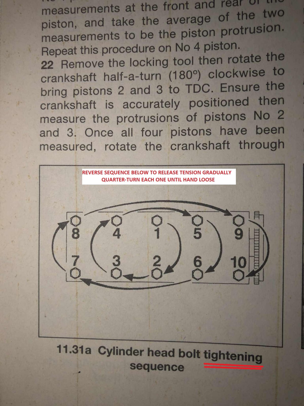

Injectors and Fuel Rail removed, I was finally ready the head bolts were slackened (E-16 Torx - Female star socket) by half a turn (Haynes B-o-L) but the last one wouldn't budge and started to chew-up (they’re not very deep heads considering the torque values) I had a brew and reasoned (guessed) that the head lifting slightly was enough to increase it's torque load too much, so I re-tightened the first nine bolts back down and then managed to loosen the stubborn one a quarter turn, once cracked off I reverted but would say a quarter turn each bolt in the correct sequence REVERSE of attached image would hopefully avoid that last bolt giving any trouble: Once all the bolts are fully removed I was finally ready ....

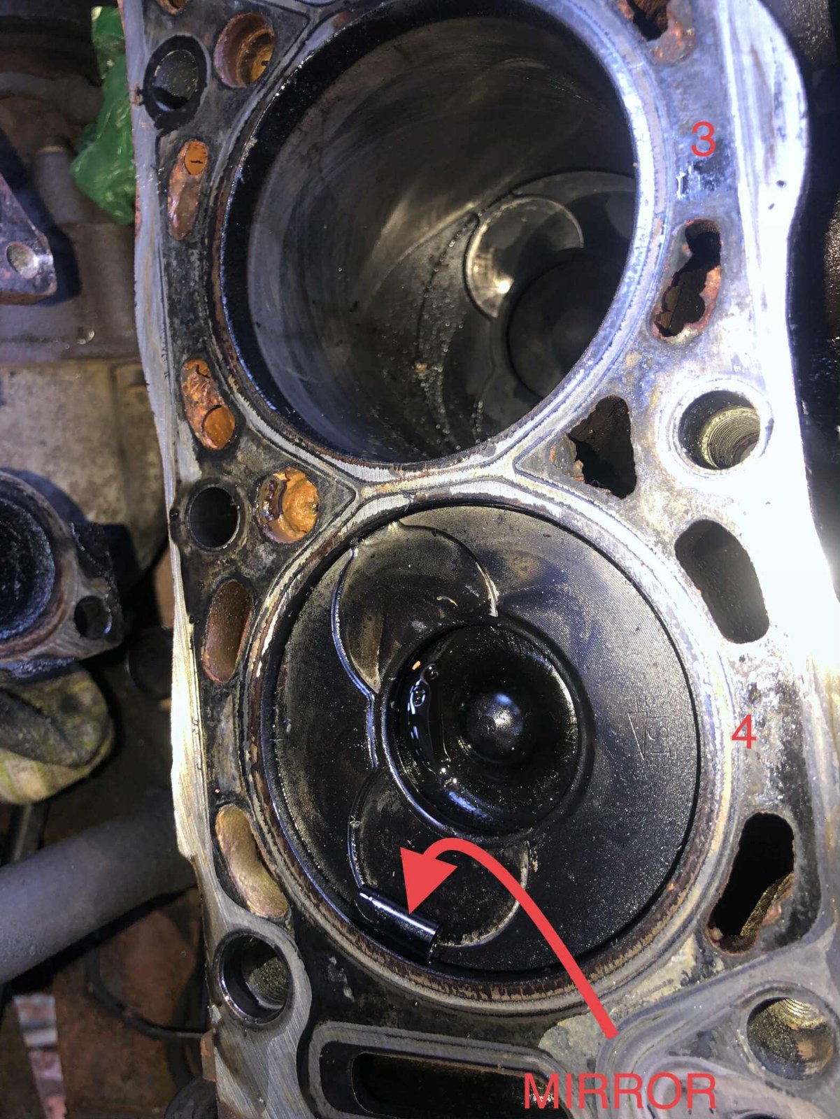

I'd cunningly left the hoist eyes in situ and used long socket bars through these to wobble the head loose to clear the dowels Jim mentioned, then with an assistant holding obstructions out of the way, I lifted and rotated rearwards to clear the engine mount, then once over that I pulled forward to release the studs from the exhaust and it was free ... much joy as I released the trapped borescope mirror that was slightly squashed but still intact, more importantly No. 4 Piston was still intact
Tomorrow will hopefully be a more thorough inspection of the reason for compression loss on No.4 including the other side of the Head Gasket, then valves and piston bores (look good initially as I can still see honing marks on No. 3 bore).

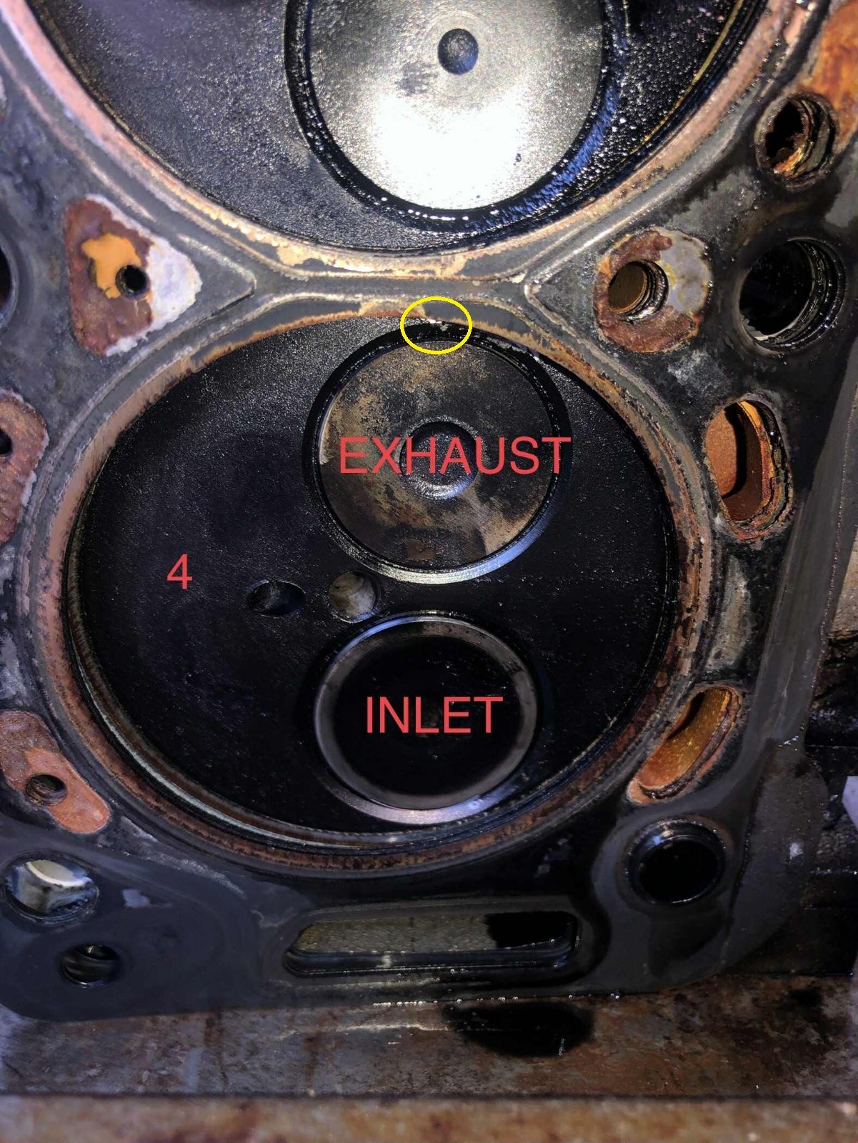

On initial inspection from that view the only part I'd be suspicious about is the apparent break in the cylinder coating ringed in yellow!

Cheers Mick I also need to keep in mind it wasn’t a ‘clean lift off’ so there may be some spots where I’ve slid and scraped/scratched the faces …not saying that’s the case with your spot as it’s hard to confirm from my bath and Mrs wouldn’t be too happy if I brought it with me for a scrub

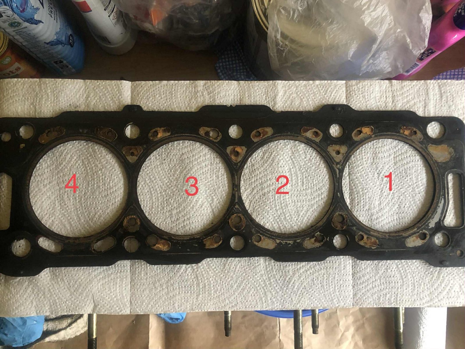

What was the headgasket like?

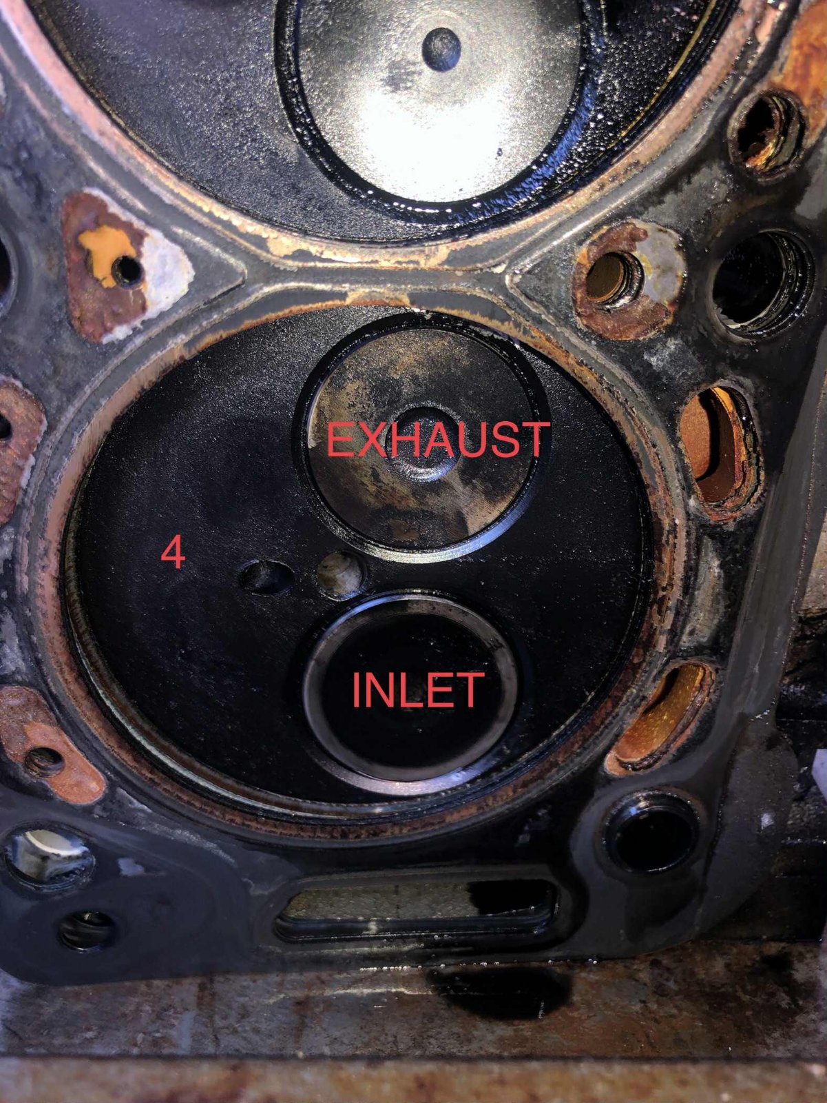

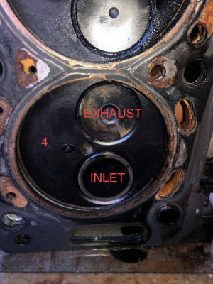

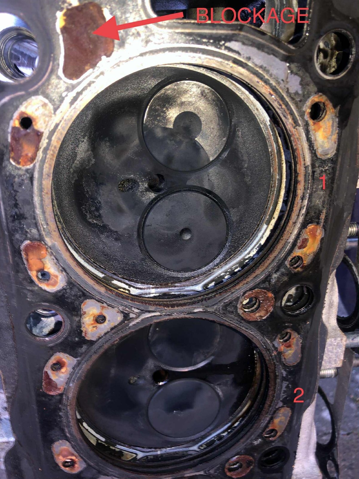

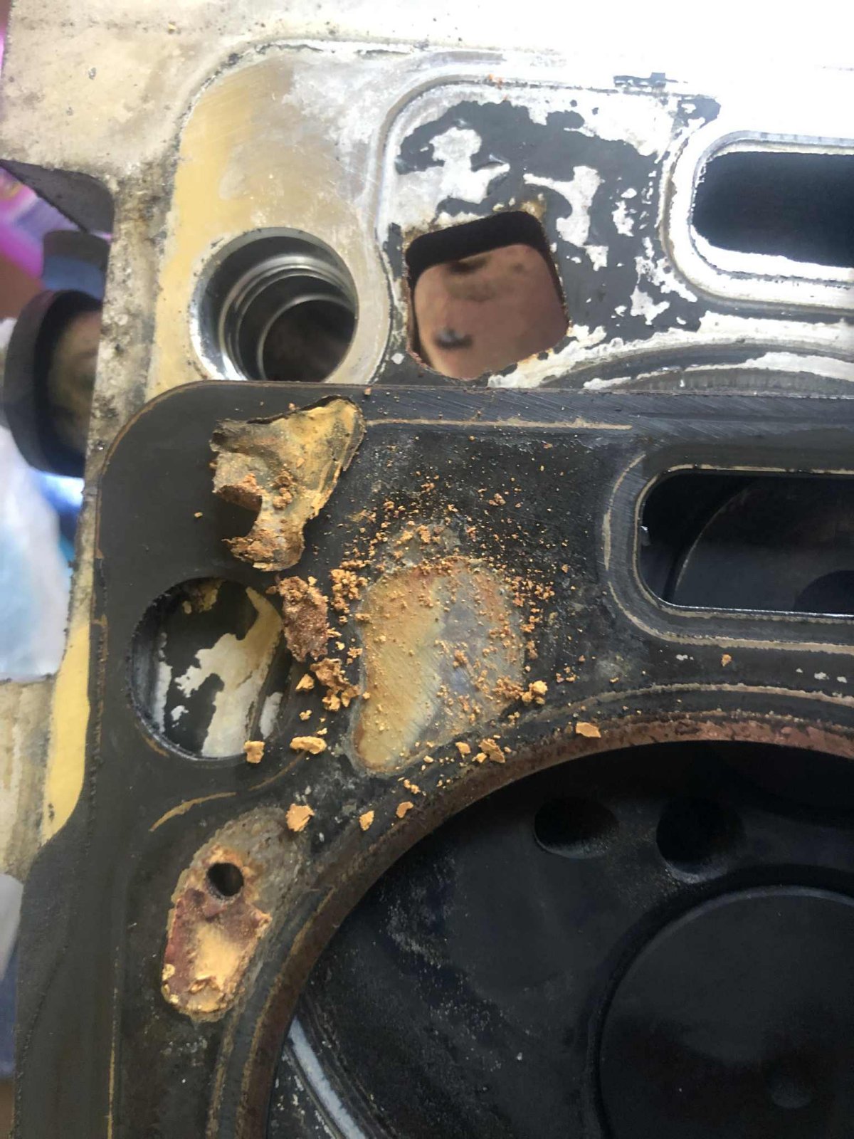

I’ll upload some better photos tomorrow after checking both sides but initially it looks ok ….
Anyone see anything dodgy here

Whilst out for a run earlier, I was thinking about this Gary...
For what's it's worth:
That coolant passage blockage looks significant and may answer a lot of questions. The blockage occurred, pressure built and that blew out the core plug.
Then local overheating may have caused the head to warp a little and caused the gasket to let go - hence low compression and leakage into the neighbouring cylinder that would account for all the smoke, even when the suspect cylinder's injector was disabled.
When cleaned up, check the head very carefully for warping and it may be a good idea to have it checked for possible annealing in that area too.
Just my thoughts. May be total rubbish...

Sorry .....False alarm Jim ....That Coolant Port for whatever reason isn't actually cut out of the gasket ....whilst there is fine orange silt in the coolant I drained, corrosion seems to be minimal.CitroJim wrote: 06 Jan 2026, 07:28 ....
That coolant passage blockage looks significant and may answer a lot of questions. The blockage occurred, pressure built and that blew out the core plug.....
