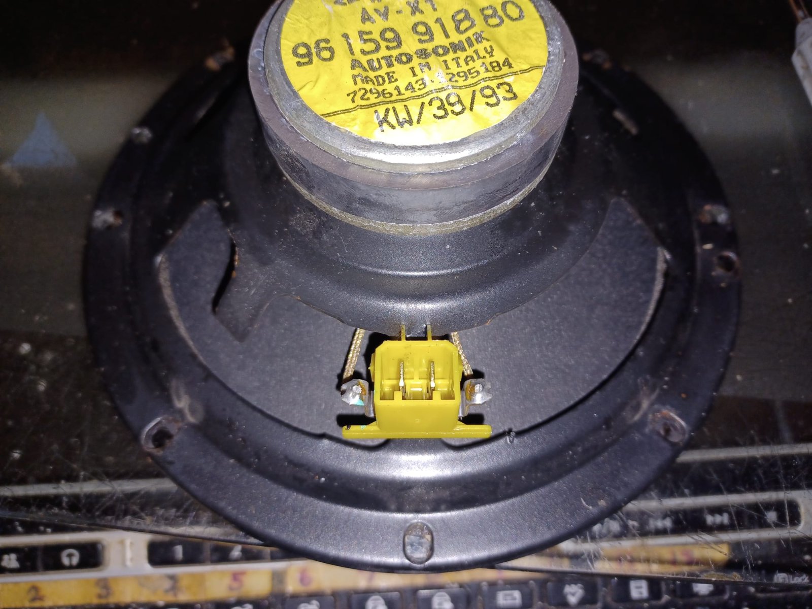

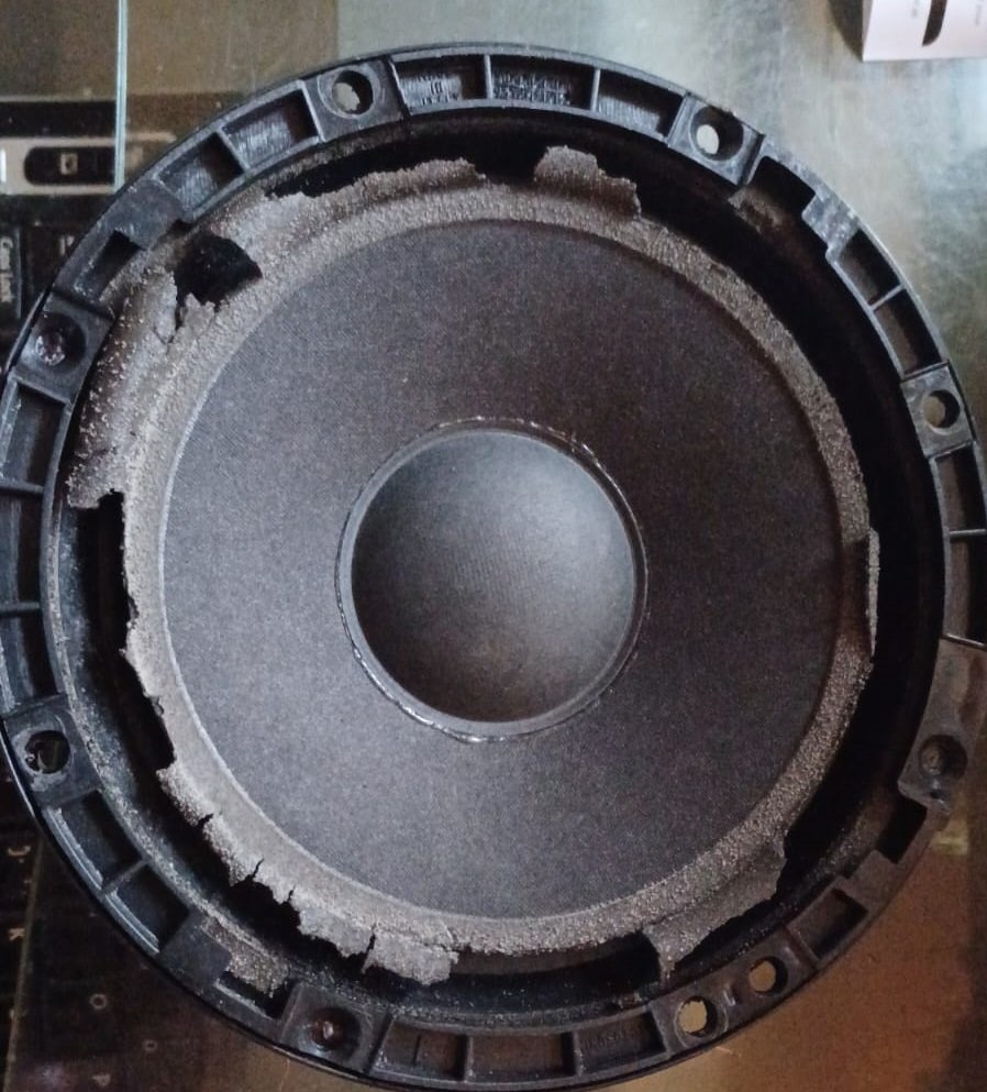

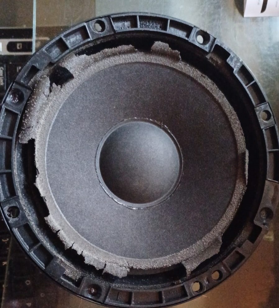

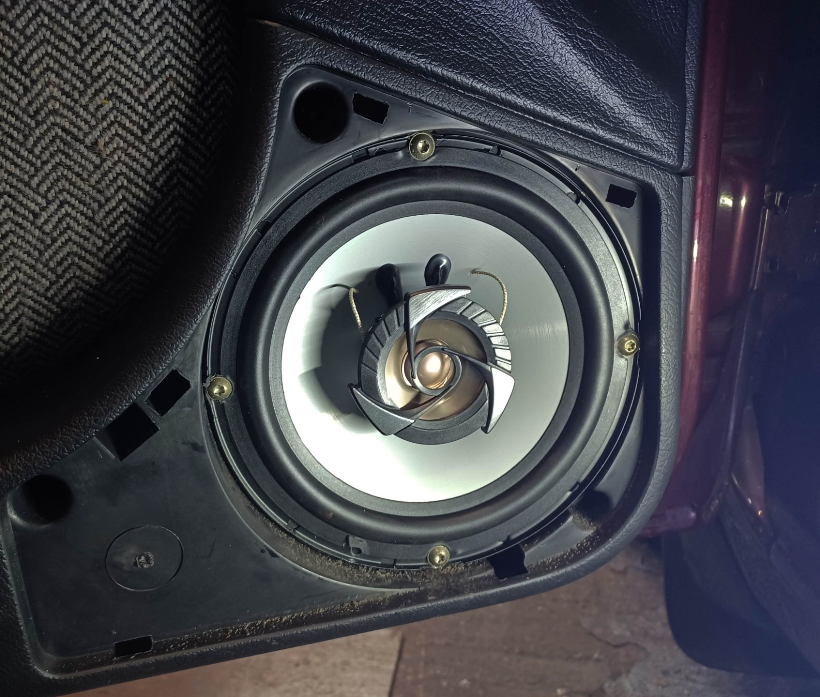

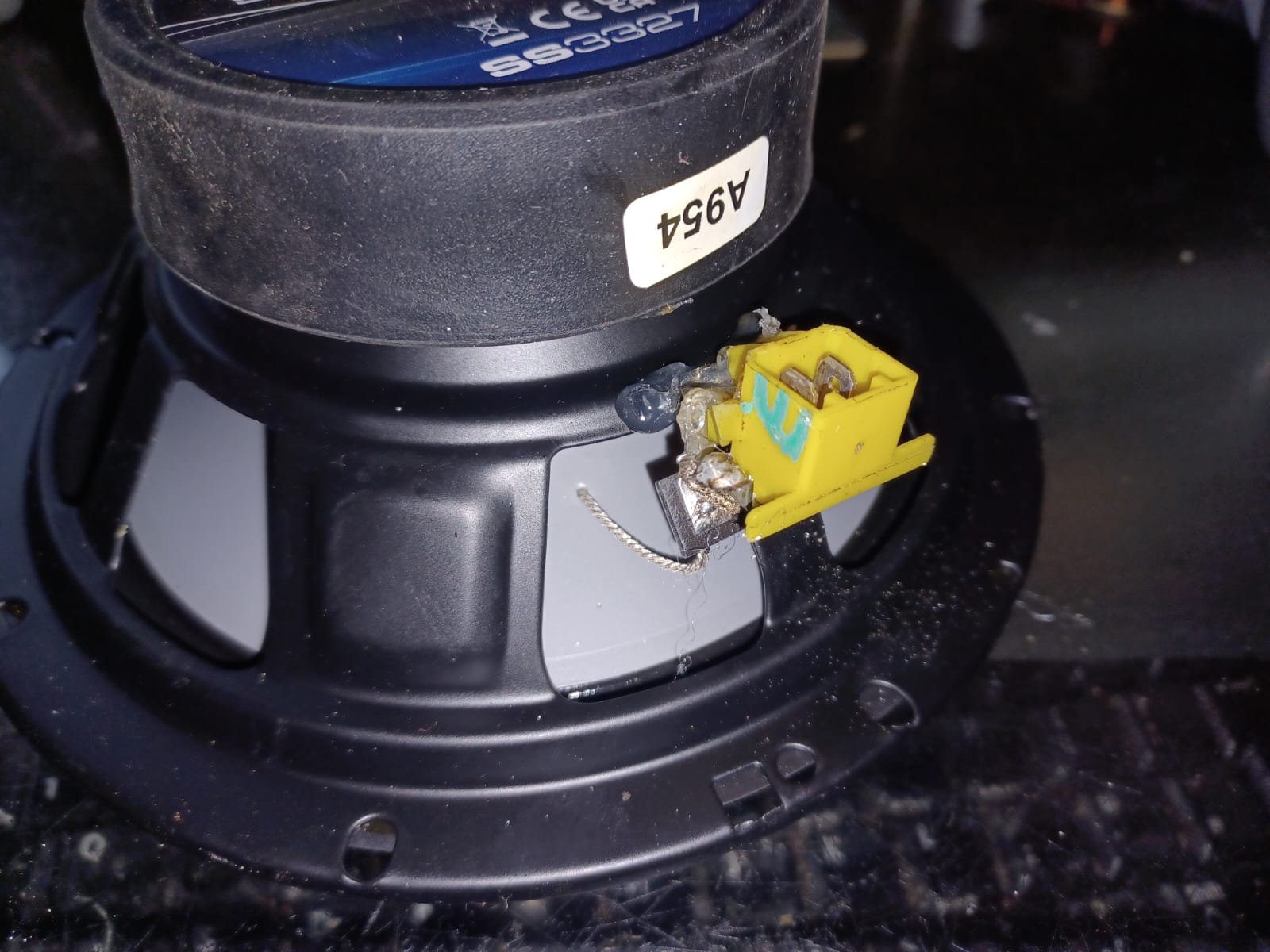

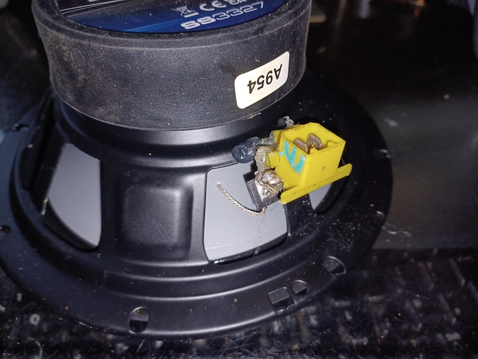

Replaced the speakers (there are only front ones, the rear door card has no place for one, not even a cover) as the cones were totally dust.
I decided to snip off the male connectors together with the braided wires that go to the working parts of the speaker cones.....I then used these braided wires to solder the connector to the pads on the new speakers. I secured the connectors to the new speakers with hot-melt glue.
old new
old new
- Posts: 20365
- x 7867
Re: Xantia 1.9TD....wake up and back on the road after 10 Years
A good solution to keep the loom standard, well done
Huskyxantia
- Posts: 3512
- Joined: 30 Jul 2018, 22:11
- x 783
Nice speakers has it made differnce to sound , pretty good size match too.
Husky.
