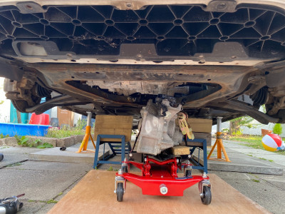

Looks good and stable. In supporting the motor/inverter/charger stack a bit of carpentry may be required to put your jack on a platform underneath the car. Sturdy pallet with a bit of thick ply and something to prevent the wheels of the jack rolling. The stack looks like it would have a tendency to rock back due to the angle of the car, and may have to be prevented from doing so with a bit of bracing at the rear maybe against the bulkhead. Not sure if with the motor you are left with a front and offside mounting to help mitigate against this.
Before the disassembly, is there a good opportunity to get a listening tube and if possible pinpoint the source of the noise if it can be recreated as per your first videos.
I know fix is more important to you than diagnosis at the moment, but I am sure the better access now would be able to confirm your thoughts.
On the driveshaft extraction front with it nicely up in the air now off the wheels is a bit of an assistant standing on the brakes necessary to undo the hub nuts or are they already slackened?
Looking at a few videos, and my own recent experience of doing a coil spring, rather than disconnect the lower ball joint, undoing the 2 easily got at Strut mounting bolts from the hub carrier allows the hub to be swung out to remove the driveshaft from the hub. May be an easier route.

There are three "engine" mounts, only the front offside mount is attached to the motor, the rear middle mount and front left mount are both attached to the gearbox via removable cast alloy brackets. (Which I have removed in my pictures of the "new" gearbox)NewcastleFalcon wrote: 20 Jul 2021, 08:36 Looks good and stable. In supporting the motor/inverter/charger stack a bit of carpentry may be required to put your jack on a platform underneath the car. Sturdy pallet with a bit of thick ply and something to prevent the wheels of the jack rolling. The stack looks like it would have a tendency to rock back due to the angle of the car, and may have to be prevented from doing so with a bit of bracing at the rear maybe against the bulkhead. Not sure if with the motor you are left with a front and offside mounting to help mitigate against this.
So the stack will have to be supported only by the front offside engine mount together with a beam/stand or similar under the motor as close as possible to the edge of the motor to ensure the centre of gravity doesn't go too far past the support edge. (I think the front offside mount does have some support in both up and down directions to allow a small amount of cantilever support but not 100% sure...)
I could build my saw horse frame and wrap a chain around from the top to hold it with the chain lift, but I'm trying to avoid that as I'd be unable to close the bonnet if there were any showers. It's probably the way I would do it if the car was in the garage with a roof beam available above and no chance of rain indoors...

It may be an idea to put a gazebo over the front of the car to keep the rain away if it does turn on you Simon. Cheap enough to get hold of a canopy style on ebay or even in B&Q, and it will always be handy for BBQ cooking afterwards

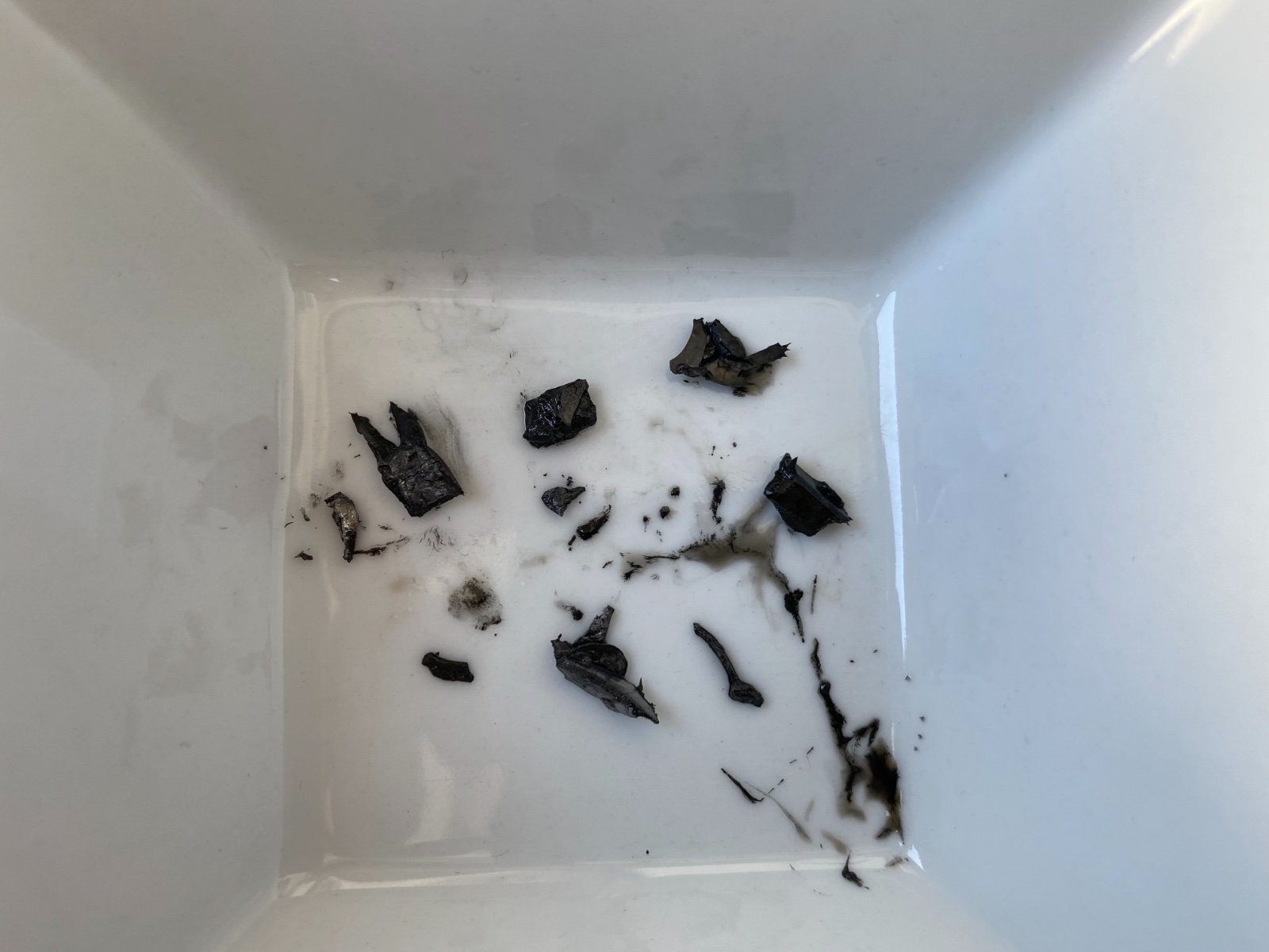

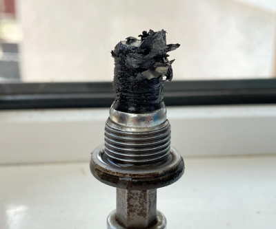

Draining the gearbox before removing the driveshafts and found this on the drain plug. Yeah, not very healthy looking...
Multiple large curved sharp metal shards around 8mm long by 3mm diameter. That's not going to buff out with an oil change....
Looks like I made the right call on the gearbox. Now to see if I can get the driveshafts out.

When you get round to giving the old gearbox a post-mortem, the cause should be easy enough to spot on that evidenceMandrake wrote: 21 Jul 2021, 13:18 Multiple large curved sharp metal shards around 8mm long by 3mm diameter. That's not going to buff out with an oil change....

Thank goodness for the plug magnet!
You absolutely made the right call, Simon.

Looks a lot like drilling swarf ??white exec wrote: 21 Jul 2021, 19:09 Thank goodness for the plug magnet!

That must have stung on the way out!!

I have to agree there Simon, it posts the question: Is that the result of the fault you are yet to identify or is it the cause? Could it possibly be a manufacturing cock-up which left the swarf in the bottom of the box from new and it has taken this amount of time to cause the actual failure you have still to identify? We look forward to looking inside!!Mandrake wrote: 21 Jul 2021, 19:14Looks a lot like drilling swarf ??white exec wrote: 21 Jul 2021, 19:09 Thank goodness for the plug magnet!
