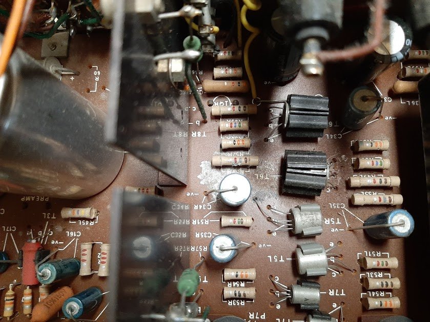

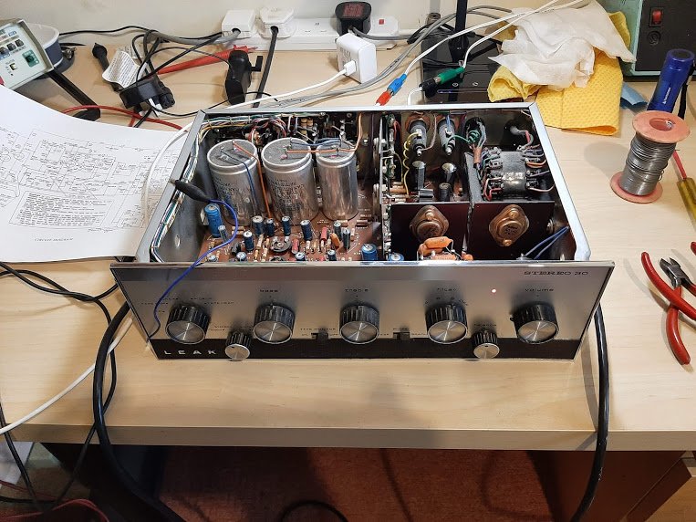

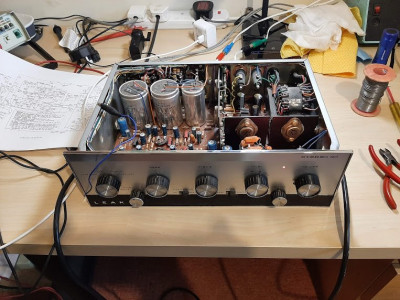

A bit of amp. work today
One of my Leak Stereo 30s died on its right channel...
It's rarely used as it lives in my bedroom and partners a Leak stereo Troughline tuner... It only sees any use if I'm ill and confined to bed and that's (thankfully) very rare indeed nowadays
I do like to run both it and the tuner up on occasion to keep it in good condition. Something I do with all my vintage kit...
The fault was very quickly traced to a 'tin whisker' in T5R, an AF118. The AF11x transistor family are notorious for growing 'tin whiskers' and the quick and dirty bodge is to lift the screen wire. The whiskers grow and short either emitter, base or collector - or indeed all three - to the can which is grounded via the screen wire...
In this case I was able to successfully 'blow' the whisker using my AVO on high ohms range
This is only a stop-gap until I source a replacement... The AF118 is a bit of a rare beast and has no direct equivalent. It's an RF transistor was an odd choice for Leak to use it as a pre-driver in the power amplifier section... Nobody can shed any light on why they did... Maybe Harold Leak got hold of a job lot that fell off the back of a lorry...
For a while I'd noted a bit 'crunch' noise when it was first turned on from cold... This problem was traced to leaky coupling electrolytics putting a bit of DC on the volume control tracks... A couple of new capacitors and all is now good...

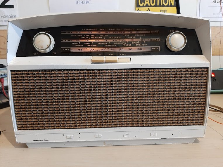

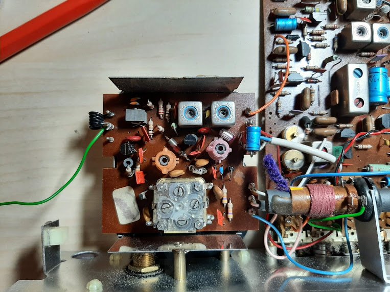

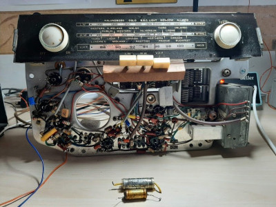

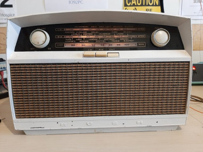

A bit of radio work yesterday
A Bush VHF80 with a bad case of modulation hum and rough audio on VHF...
A couple of capacitors sorted it
And a bit of extra HF decoupling on the VHF tuner HT supply went a bit further to reduce the modulation hum to nothing...
It is now preforms well and sounds very nice indeed
Even if it looks a bit rough!

Cetainly untidy, Jim!
Remember working with several of Sony's first Umatic VCRs back in the '70s. The pcb's in their 1810 recorders looked as if a troop of boy scouts had marched across them - stand-up/loop-down discrete components all leaning at crazy angles - a real eyesore. One day, we had a Panasonic equivalent on the bench, and the difference was striking: everything tidy and vertical.
Not knocking the Sonys through: terrific and acclaimed machines. We eventually ran three 1810 (and later Type 5) recorders and almost a dozen Type 5 playback units in the school, all still operating when I moved on in '88. 27" Trinitrons on Unicol stands were our choice for classrooms. Oh for the compactness and cheapness of later DVDs!!

white exec wrote: 12 Mar 2021, 06:56 Cetainly untidy, Jim!
I know exactly what you mean Chris, I found very little to please the eye in most Japanese domestic stuff of the era... Looked great on the outside and horrid internally! The Japs really knew how to make things look elegant, stylish and classy on the outside...
Sony were bloody good and despite the internal rats nests not too difficult to repair on the rare occasions their stuff failed... Unlike some other Japanese stuff!
You can see why the Jap stuff completely eclipsed the British stuff - on looks alone... The British stuff worked well but did not have the sharp looks...
They were always good sets Peter. I would think they must have sold well, both the VHF80 and it's wooden cased sister, the VHF81... I have three VHF81s in my collectionPeter.N. wrote: 12 Mar 2021, 10:06 I recognise that Jim, we used to sell those when they were new - I was much newer too.

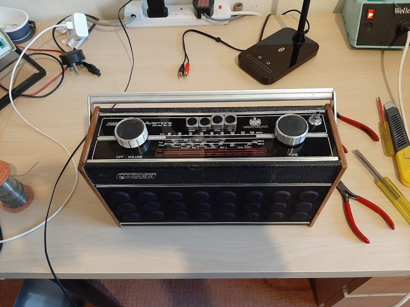

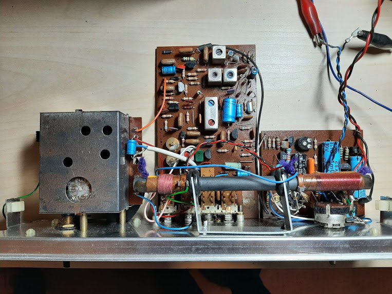

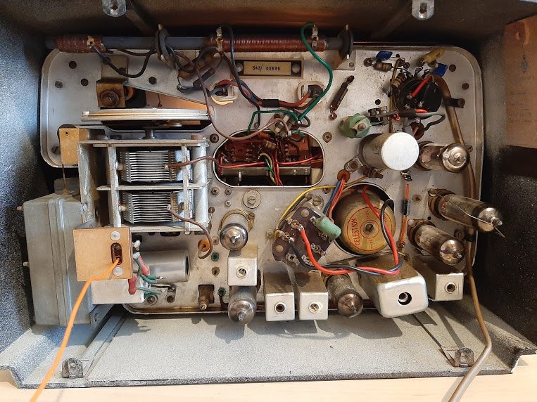

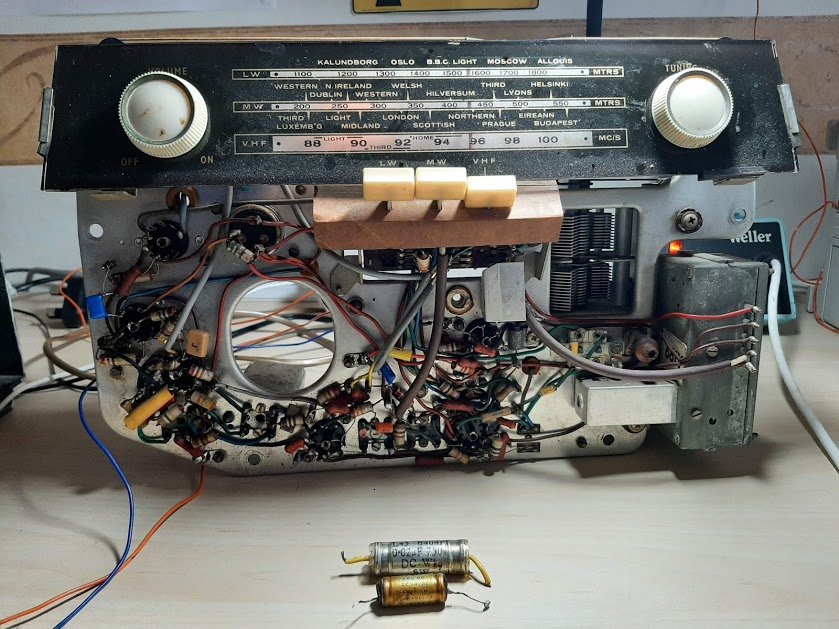

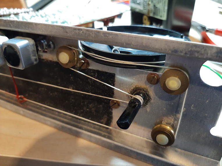

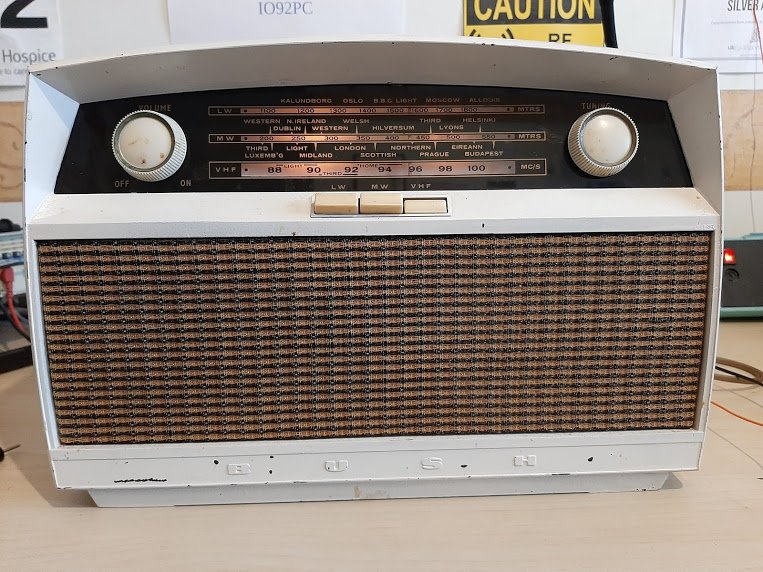

I've been fixing a product of a famous (and classy) old British radio maker today... A Hacker portable with a very noisy tuning capacitor leading to very unstable tuning...
It was necessary to open up the metal screening box around the tuner module to fix it...
And to do so I needed to unlace the tuning drive cord... Not a job I relish...
I took a load of photos so that I could re-lace it at the end
The repair was a complete success
