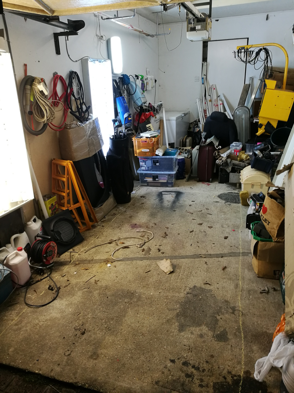

Given that my garage is still something of a work in progress I decided that a quick check was in order...
Yep! It will fit! The yellow box drawn in chalk on the floor represents the overall dimensions of the Invacar (even though mine will be slightly more compact just now due to missing bits of body!). Obviously there's still a lot of junk to get rid of - but the car will physically fit into the garage and allow the door to be closed at least.
Does highlight the reason that the garage really hasn't been used for anything other than a junk store though...There's just over a foot of clearance to the left, and maybe two and a half or three feet to the right...and this is a car that's only 4'6" wide (and 9.75' long). With a car that's a more normal width in there you'd have to be nigh on two dimensional to get in or out.

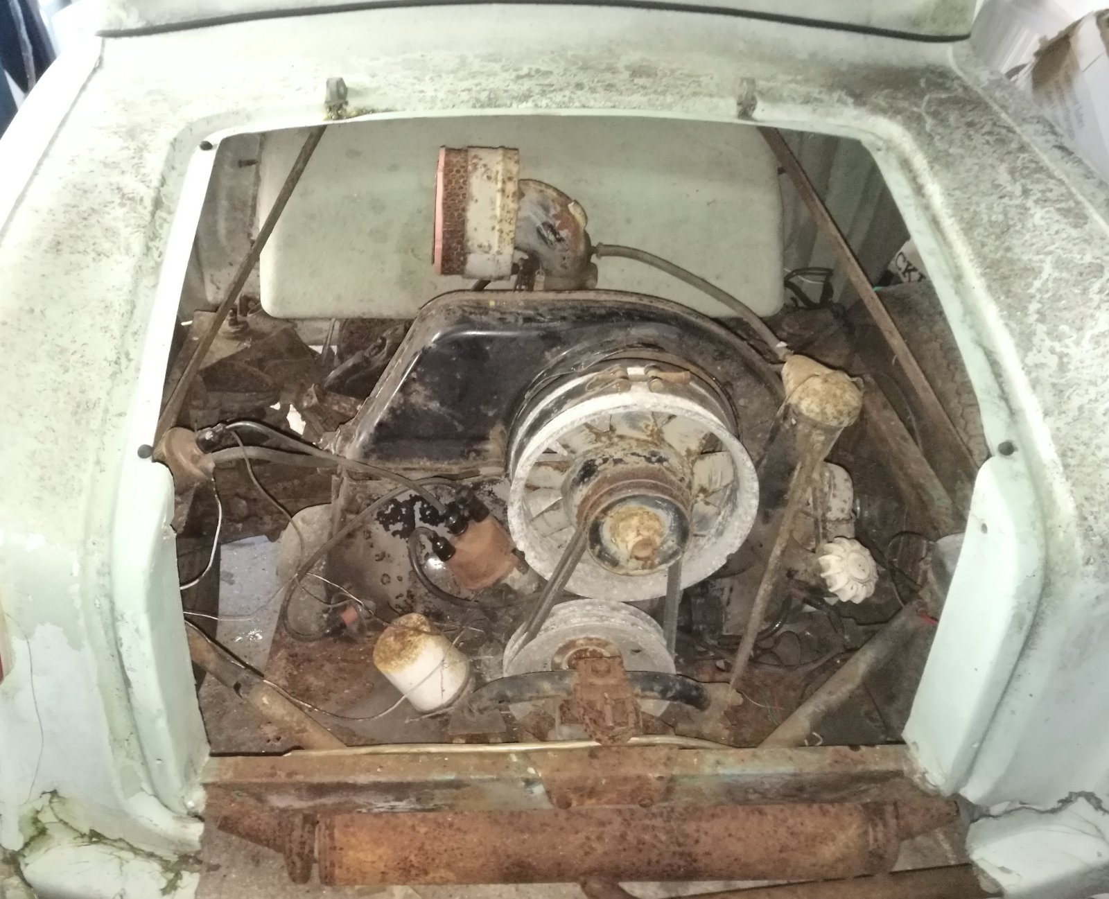

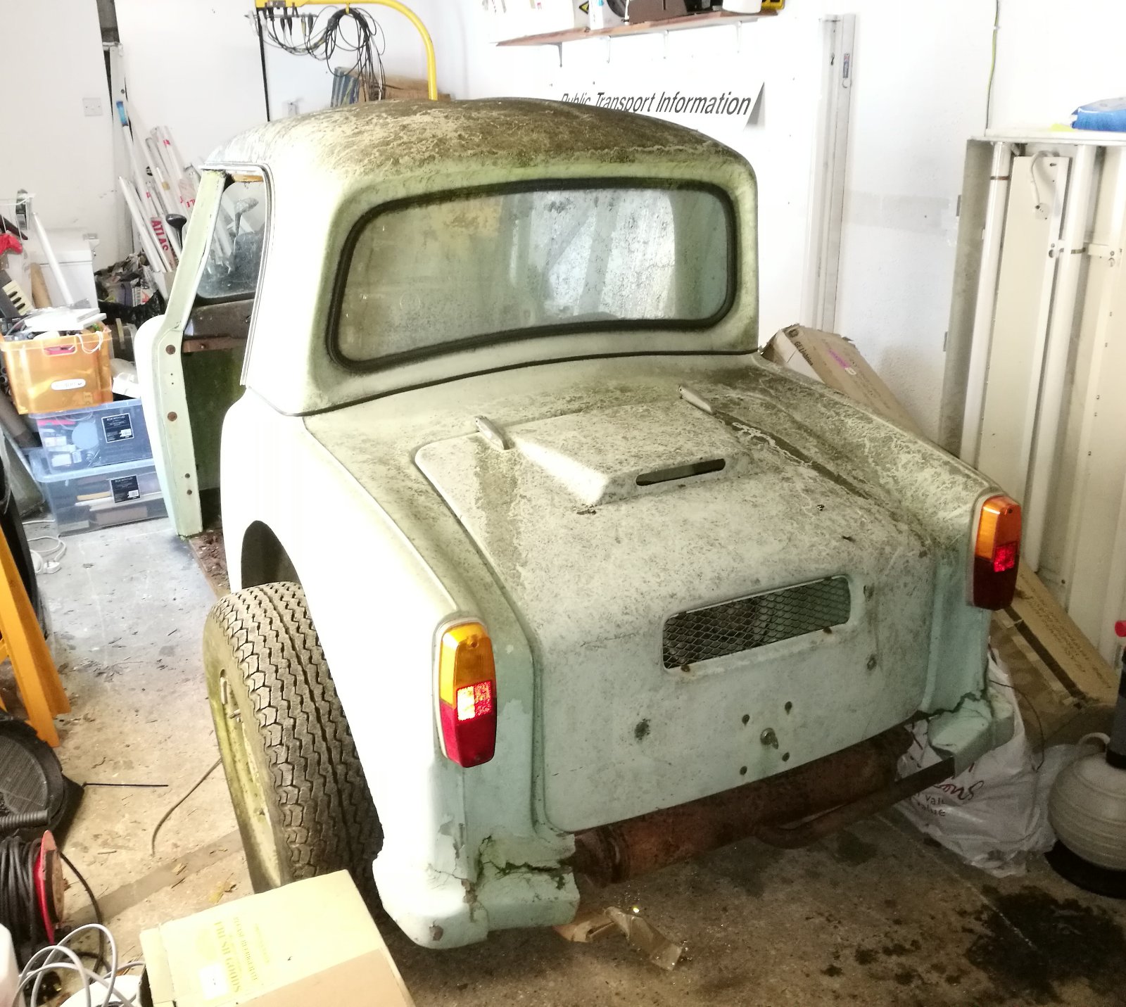

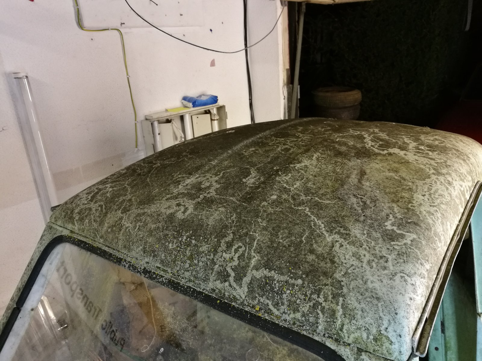

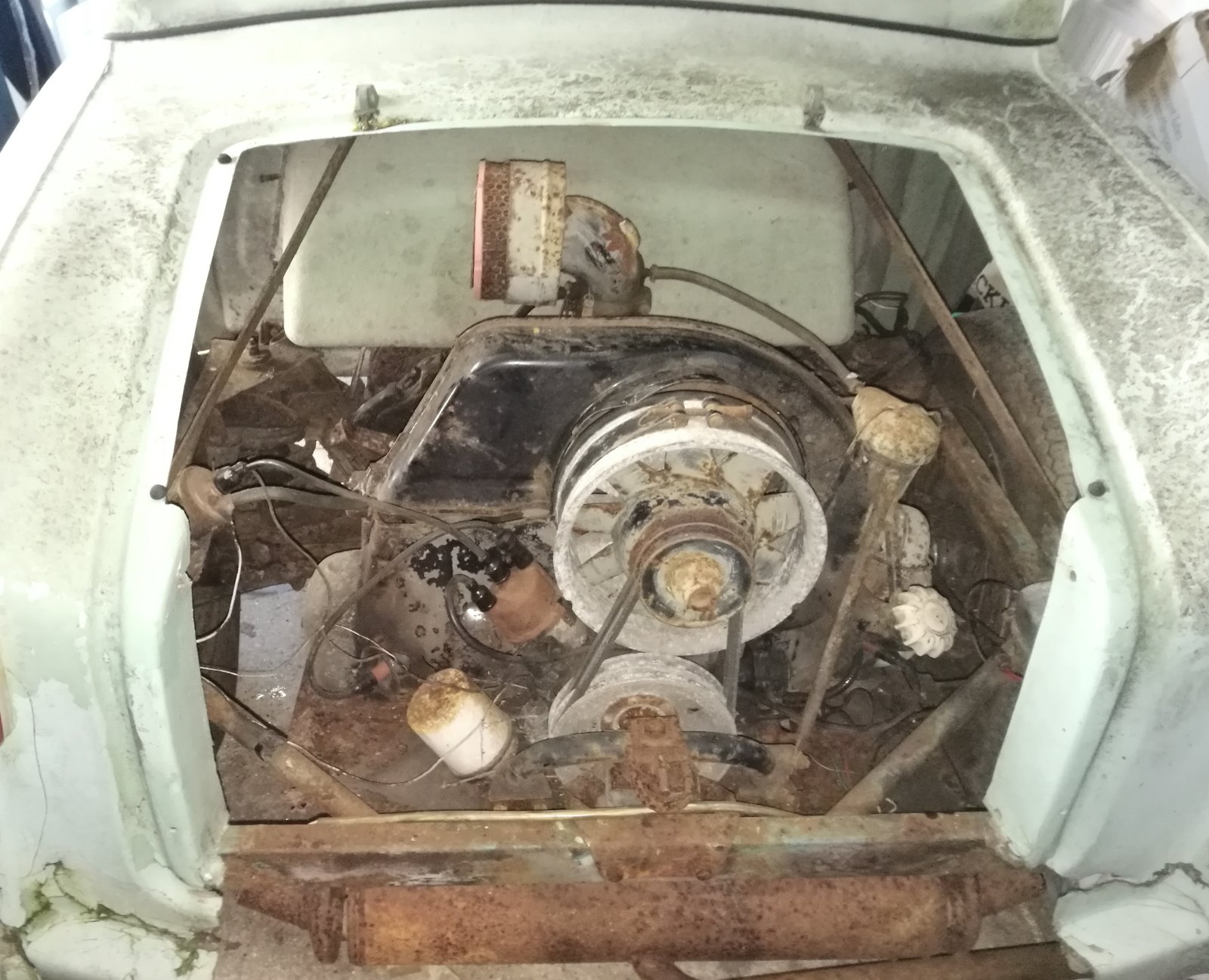

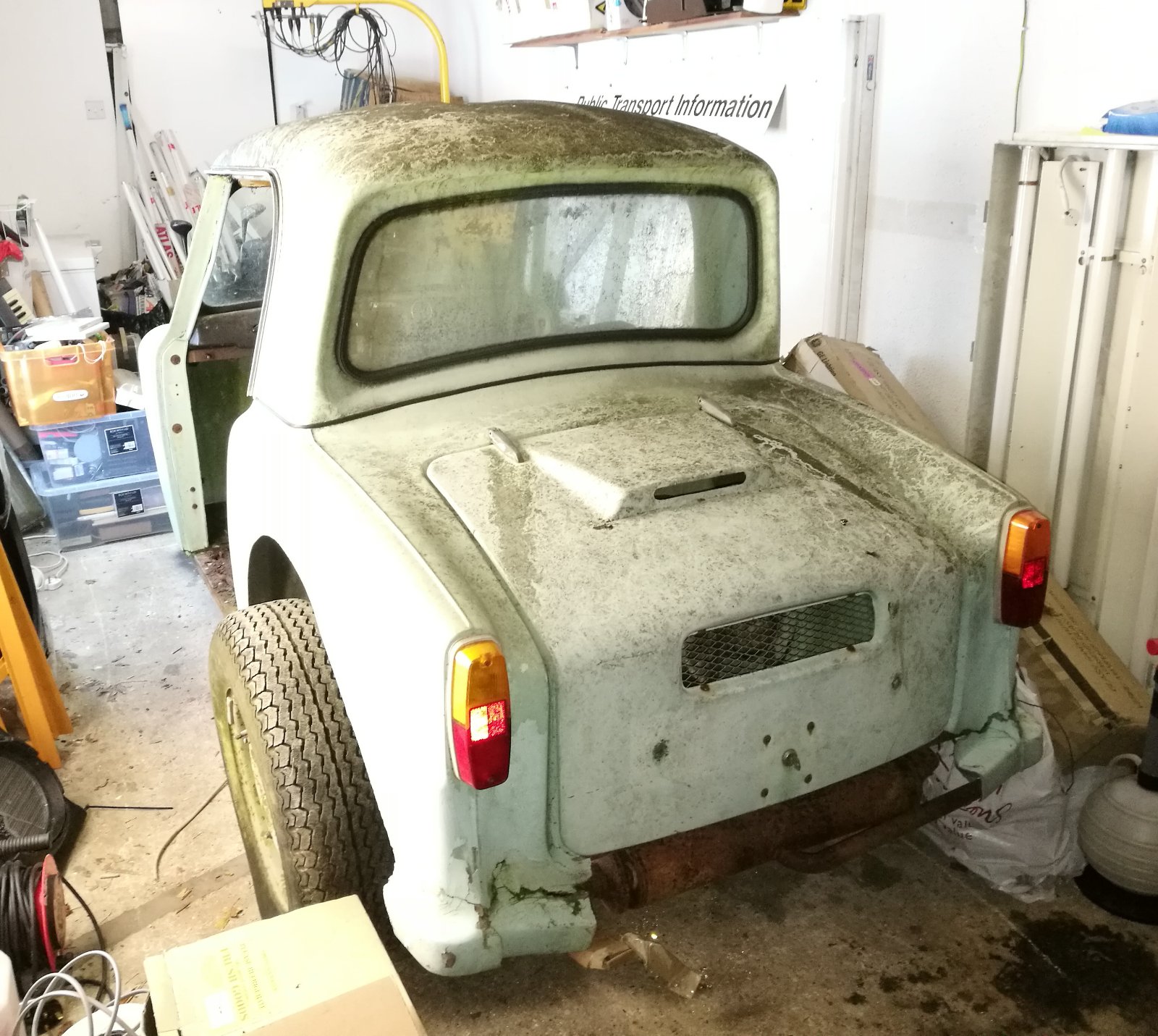

...The Invacar has landed...
Will snap a couple of photos after dinner to prove it!
EDIT: Here you go...some horrible quality photos.
First order of business tomorrow will be to break out the pressure washer and basically attack every square inch of the thing. It will probably look a heck of a lot better just for that.

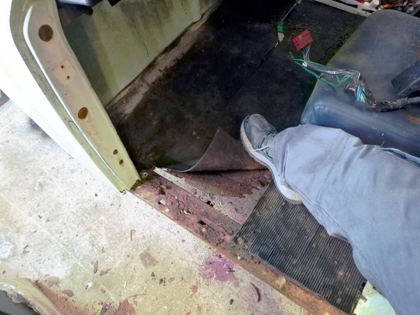

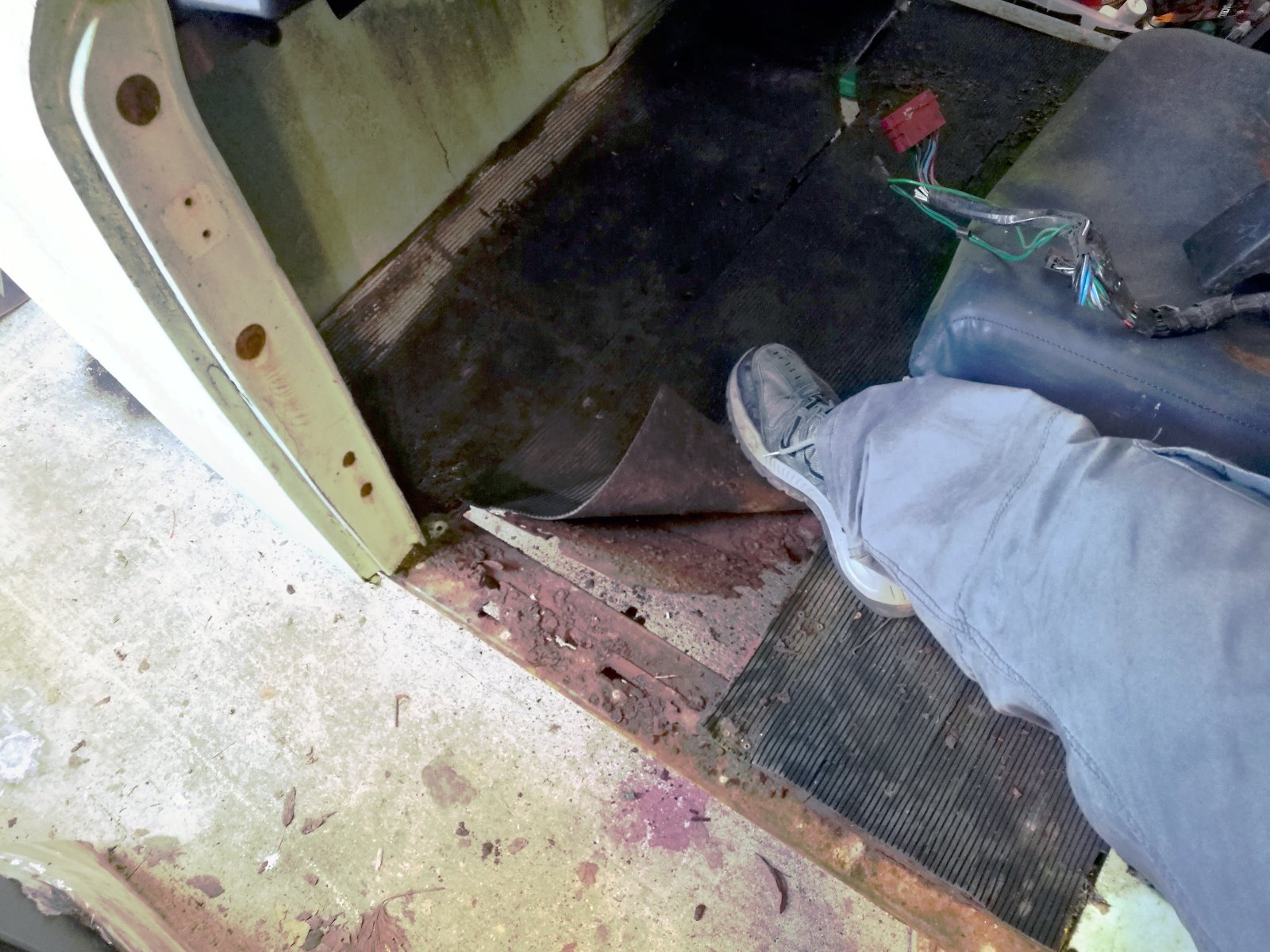

The floorpan is utterly, completely and totally shot to pieces. So far the chassis still seems good though - couple of small areas needing attention, but overall pretty astonishing given the storage conditions.
Doors are present - just stored to one side right now.
The engine hasn't been run yet, but I've ascertained that it's not full of water and can be turned over by hand, so that looks hopeful.
Once it's had a clean seeing if I can get it started will of course be first on the list! ...on axle stands of course as we've no idea whether it's in gear or not at the moment and the gearshift linkage is totally seized (though I do have a spare).
Expect to see more in the morning!

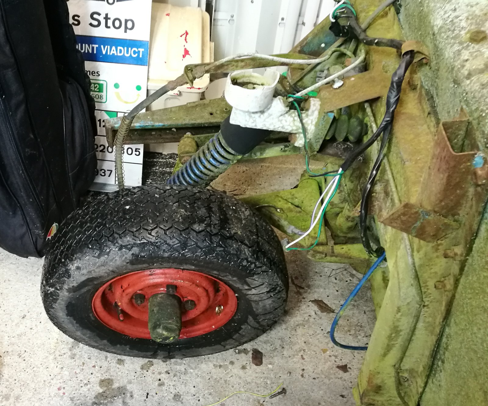

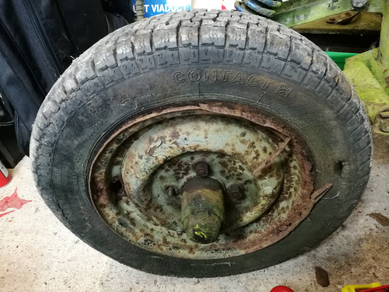

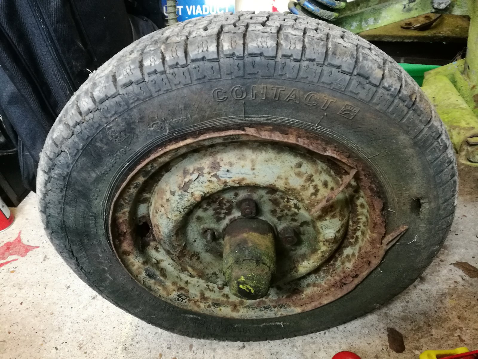

Figures doesn't it...Get a new project home, then it goes and spends the ENTIRE day pouring with rain.
Not one to be deterred however, I figured even with the limited space available in the garage, I could get something done.
First up was changing this...
...as it was clearly beyond any redemption, and was making it very difficult to move the car around.
Replacement still needs a new tyre before the car goes anywhere near the public highway, but at least the wheel is something resembling round and it actually holds air.

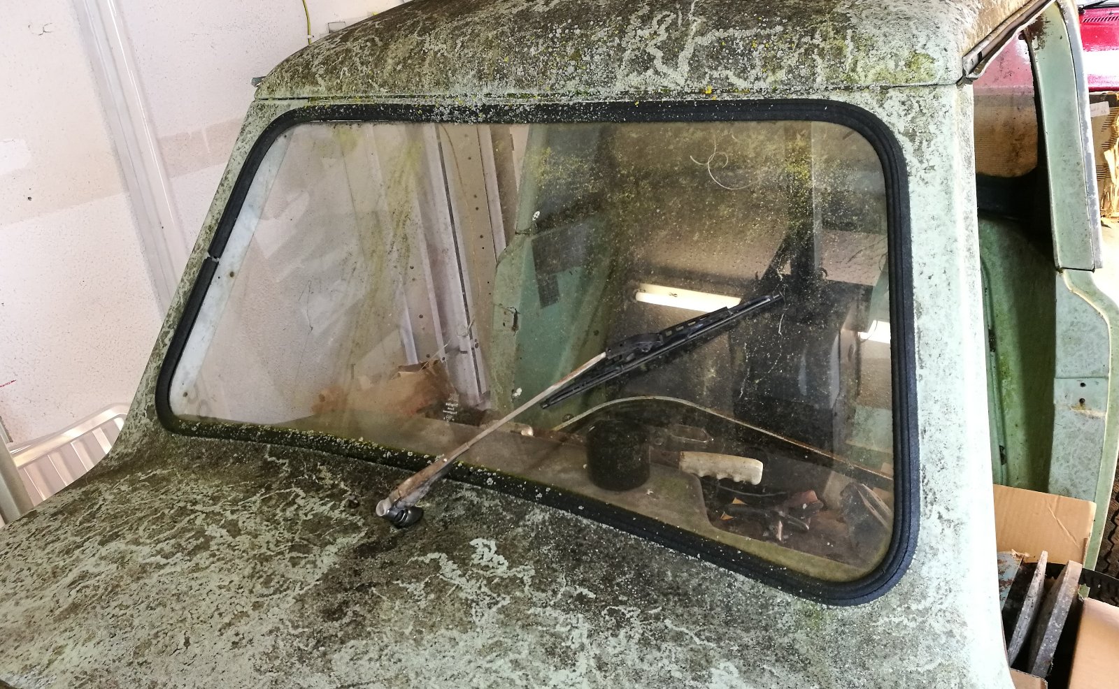

While I was in the area, I had a look at the brake master cylinder. Successfully removed the brake pipe connecting it to the rest of the system without any problems, however getting the master cylinder itself off the car is another matter. It's an utterly daft design. To save a couple of pence, they didn't use captive bolts to hold the master cylinder on. This is a pain as getting at the head of the non-captive bolt is an utter pain. I need a very compact ring spanner with a cranked end I reckon...Or I could just introduce them to my good friend Mr. Angle Grinder and stick a new set of nuts and bolts with the new cylinder.
Annoyed at being temporarily defeated by that I stuck the windscreen wiper back on, simply to satisfy my OCD.

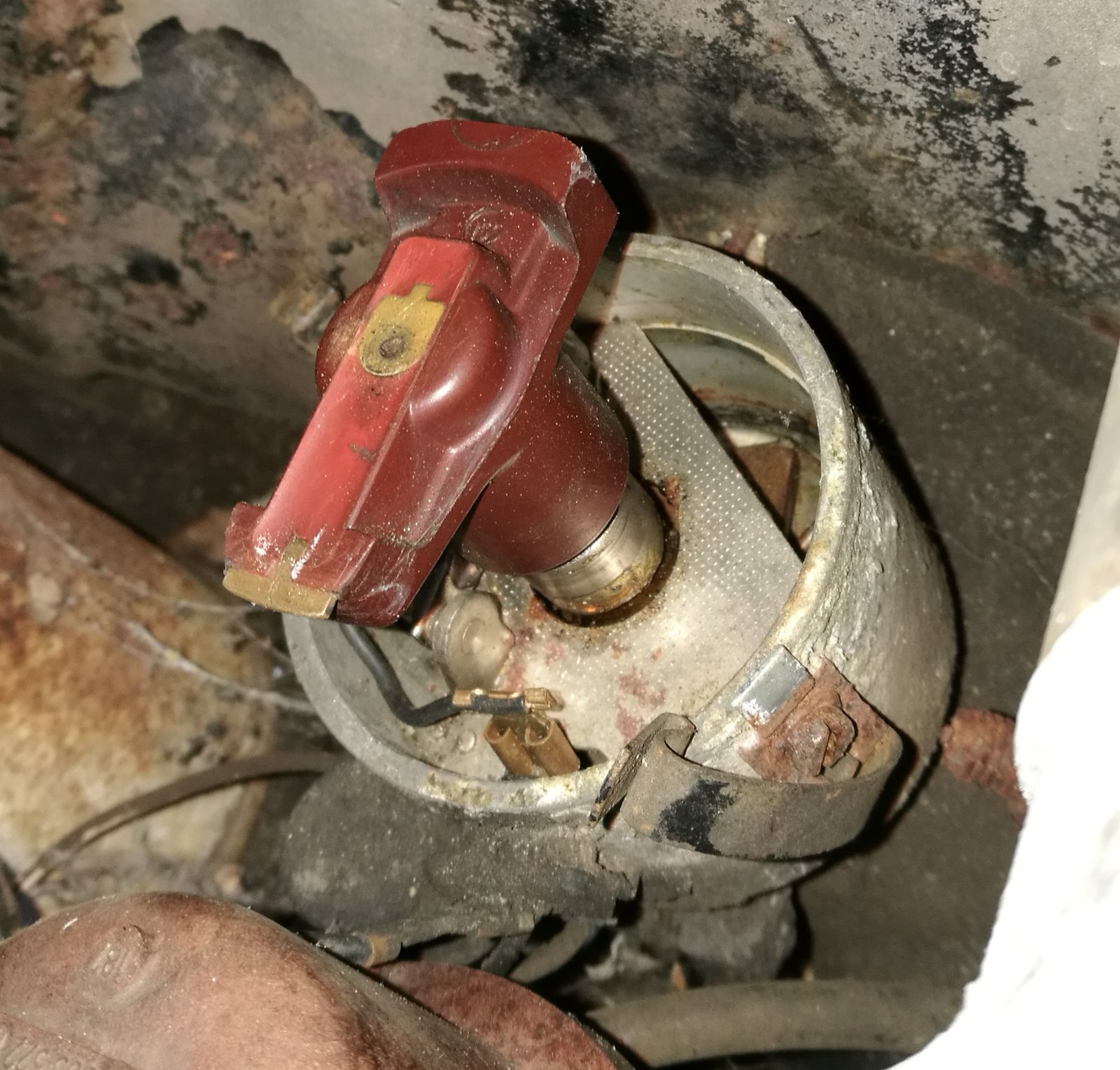

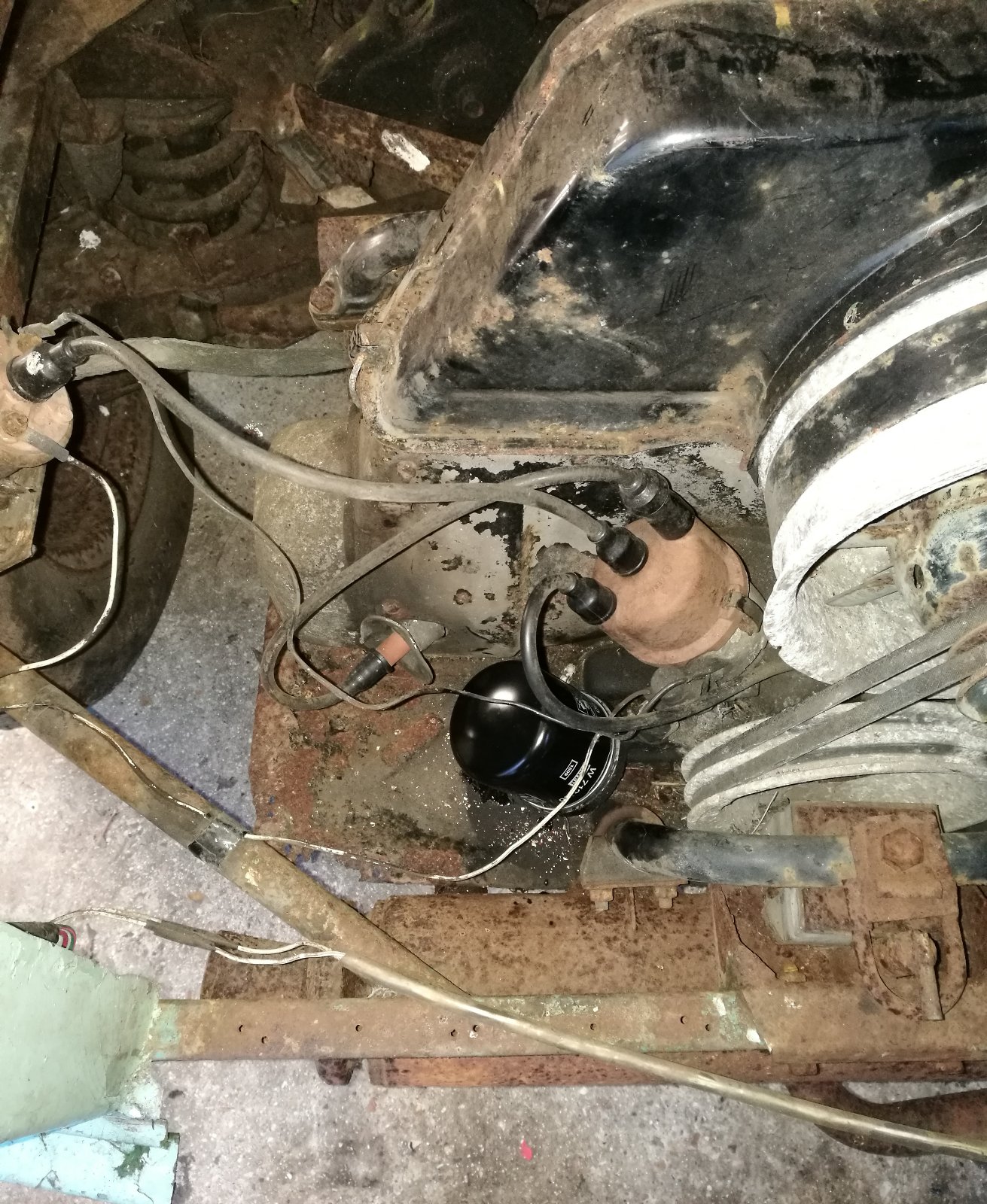

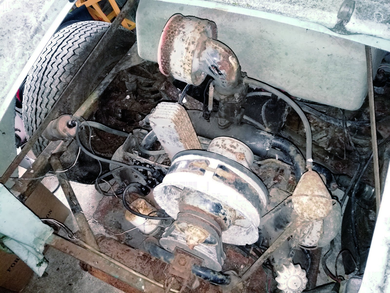

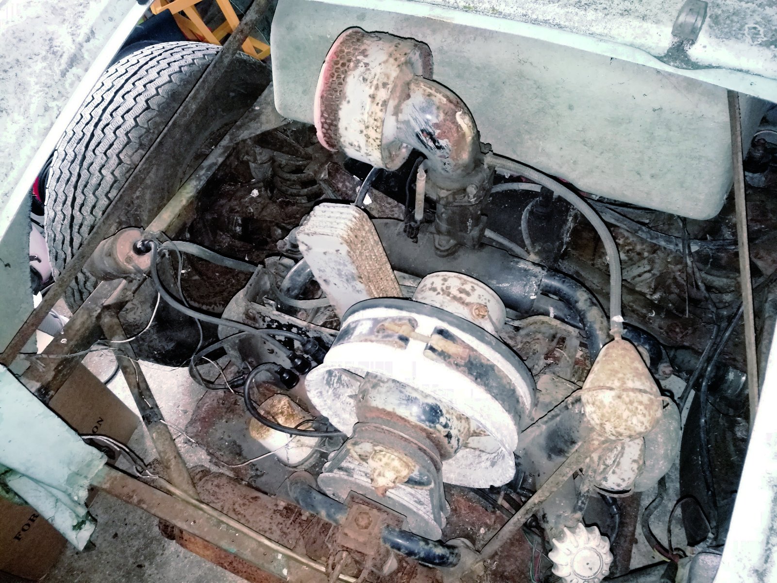

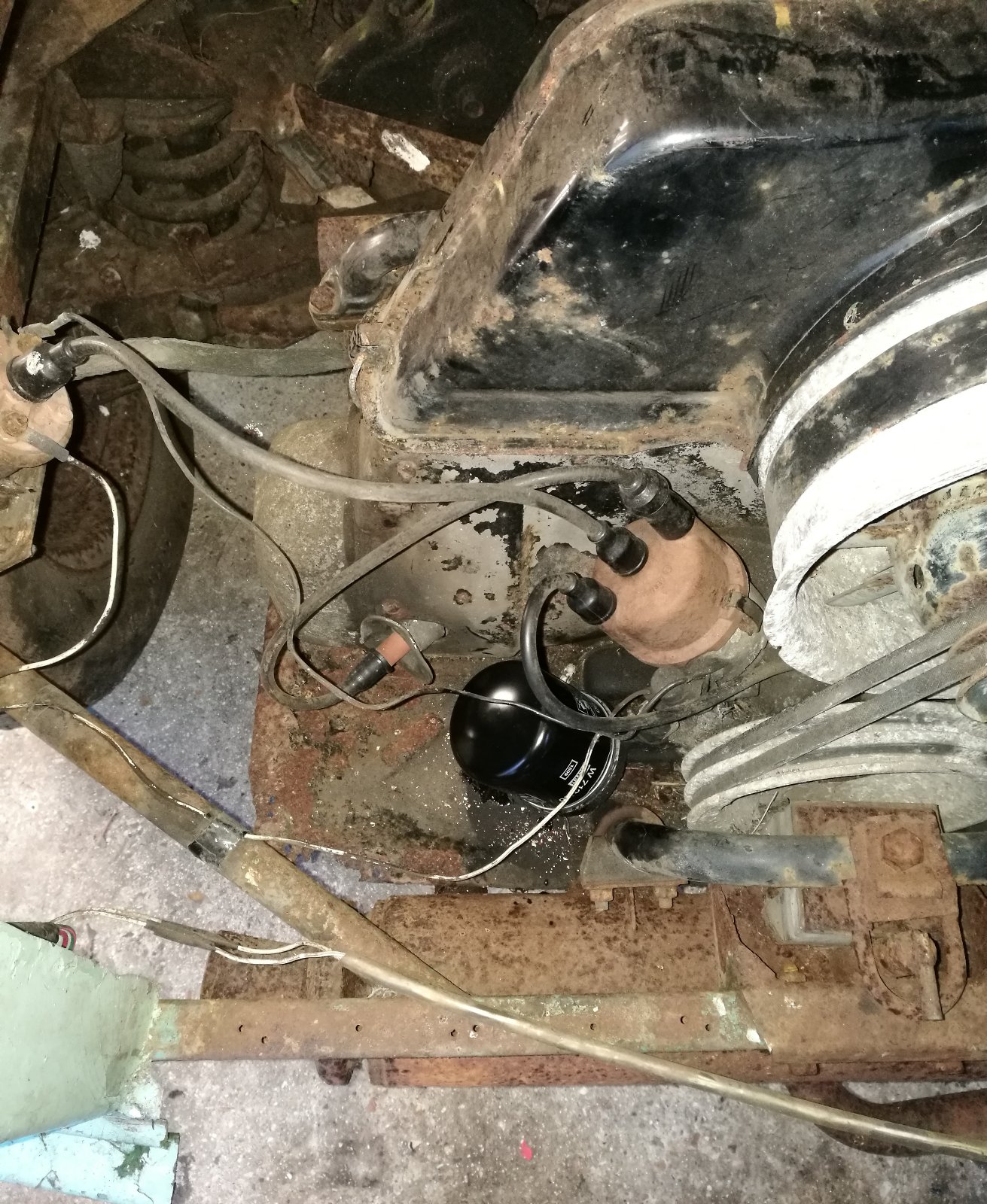

I then turned my attention to the engine. A quick test using the attachment point for the starting handle proved that it turns over smoothly and appears to have decent compression.

Here's hoping the weather is a bit better tomorrow so I can actually get it cleaned up a bit!
On checking the oil, it appeared to be massively over-filled, but didn't look *too* gross...Anyhow I drained that off and replaced with it some new stuff. Not quite the right grade, but it will only be in there for a few minutes worth of running before being replaced anyway. The filter I had in stock is a variant of the specified one (MANN W712) which has a not-required non-return valve. So long as the flow direction isn't wrong I don't see any reason this shouldn't work just fine...I'll be keeping a careful eye on the oil pressure before I even consider turning the engine over with the ignition system enabled.

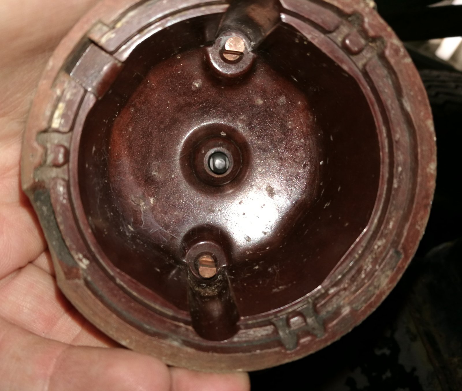

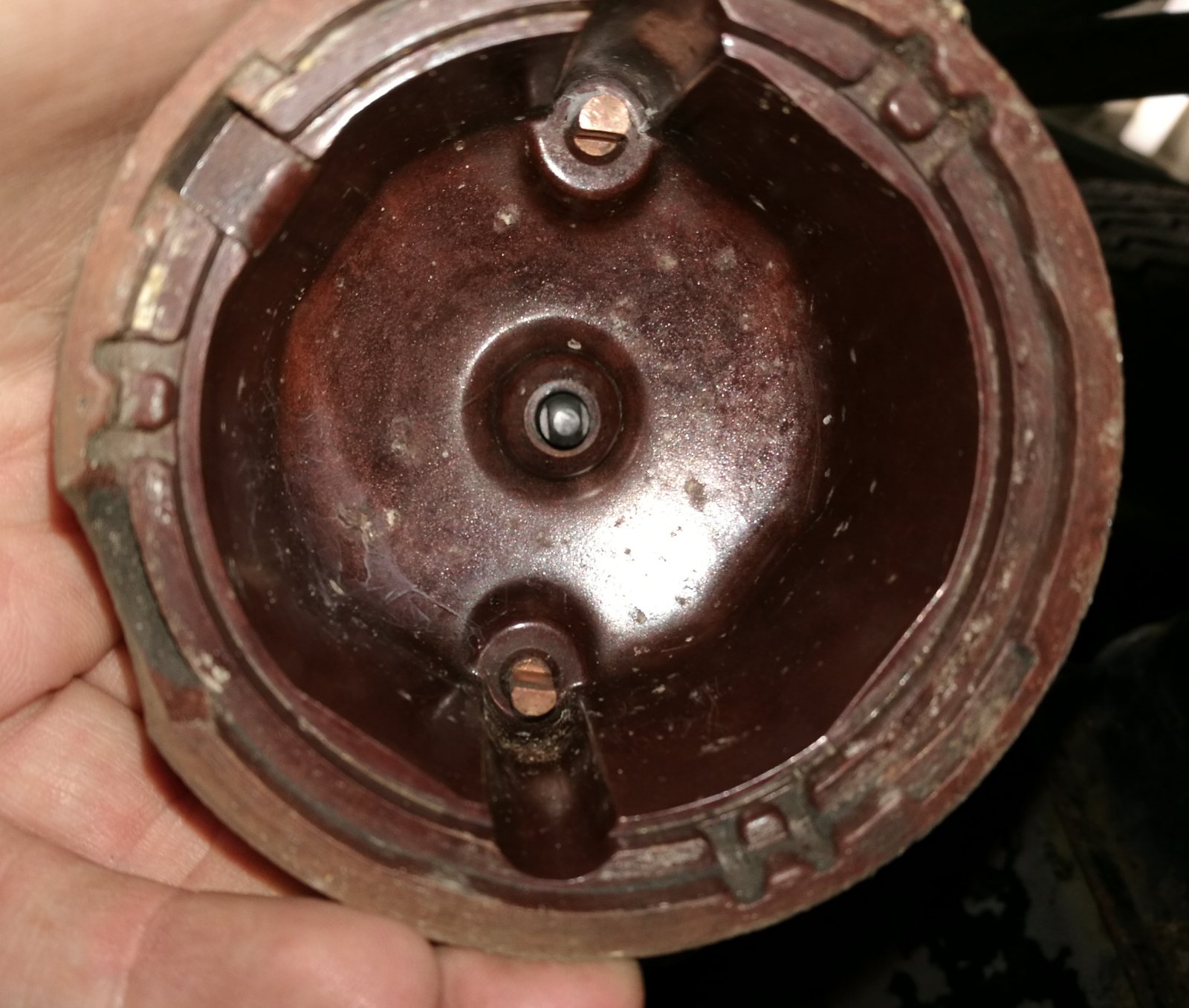

While I was in the area I took a better look at the ignition system...Surprisingly clean!
I also tried connecting up a battery...Result being that absolutely nothing seems to work. Given the amount to which the loom has been hacked about that's not a huge surprise...so I may have to get slightly more inventive to get the engine going initially.
