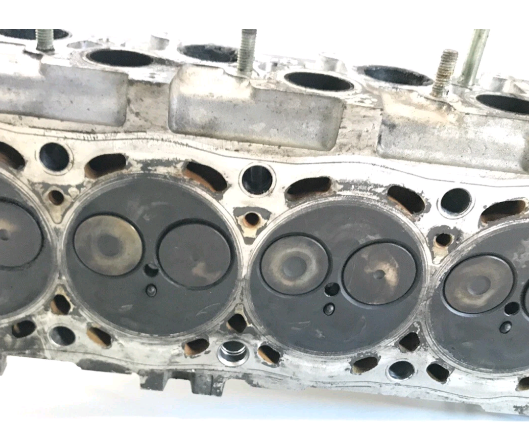

Hi, I've just skimmed through this, so the problem is a hole in one of the pistons (crown) what options are being looked at now ? Was you relieved when you found it ? Or was it one of them
now what do I do moments
Husky.
- Posts: 5068
- Joined: 25 Apr 2022, 09:03
- x 2214
Re: XANTIA HDi RUNNING ROUGH
Re question about valve cutouts and if the valves are off to one side.
Quick eBay search here's a second hand cylinder head: they'd not far off central relative to the cylinder bore: Copied from:
https://ebay.us/m/qCb6iA.
Re: could you grind that chunk out of that camshaft? I'm not sure how easily that'd be done (would probably seek out a second hand head complete or camshaft if it was me)
Re: not needing to fix it - ah bliss, the rare chance to fix it at your leisure without the stress of not having needed transport available!
Interesting stuff, enjoying being along for the journey
There isn’t a hole in the piston. Unless something has changed since last week.Huskyxantia wrote: 19 Dec 2025, 20:46 Hi, I've just skimmed through this, so the problem is a hole in one of the pistons (crown) what options are being looked at now ? Was you relieved when you found it ? Or was it one of themnow what do I do moments

This nicely proves that the oil slick is on the correct side of the piston ie to the rear.MattBLancs wrote: 19 Dec 2025, 21:02 Re question about valve cutouts and if the valves are off to one side.
Copied from:
Re: not needing to fix it - ah bliss, the rare chance to fix it at your leisure without the stress of not having needed transport available!![]()

Accept my apology, it looked like a hole in the piston from what I saw , what's your overall plan for the cars outcome ?Rhothgar wrote: 22 Dec 2025, 10:03There isn’t a hole in the piston. Unless something has changed since last week.Huskyxantia wrote: 19 Dec 2025, 20:46 Hi, I've just skimmed through this, so the problem is a hole in one of the pistons (crown) what options are being looked at now ? Was you relieved when you found it ? Or was it one of themnow what do I do moments

Skull was worried about it being a holed piston initially as he thought he had seen a shard of metal in one of the photos but it turned out it was just the edge of the valve relief pattern in the top of the piston.Huskyxantia wrote: 22 Dec 2025, 12:02Accept my apology, it looked like a hole in the piston from what I saw , what's your overall plan for the cars outcome ?Rhothgar wrote: 22 Dec 2025, 10:03There isn’t a hole in the piston. Unless something has changed since last week.Huskyxantia wrote: 19 Dec 2025, 20:46 Hi, I've just skimmed through this, so the problem is a hole in one of the pistons (crown) what options are being looked at now ? Was you relieved when you found it ? Or was it one of themnow what do I do moments
He's planning on fixing I believe when the men in white coats release him from his shackles...
Hopefully not a biggie but the jury's out on whether he's taking the head off to do further checks or just replacing the cam follower and hoping for the best. The Jim / Mick camp is for "off with its head" whereas a couple of us as "softly, softly" approach (why do more work than necessary). This is providing he can recover the end of his mirror with a mini-grabber type affair which fell into the black hole when he stuck his who-ji-ma-flop in there....

XantiaHusky No need for apologies it does look like a holed piston to me, so we might still be right

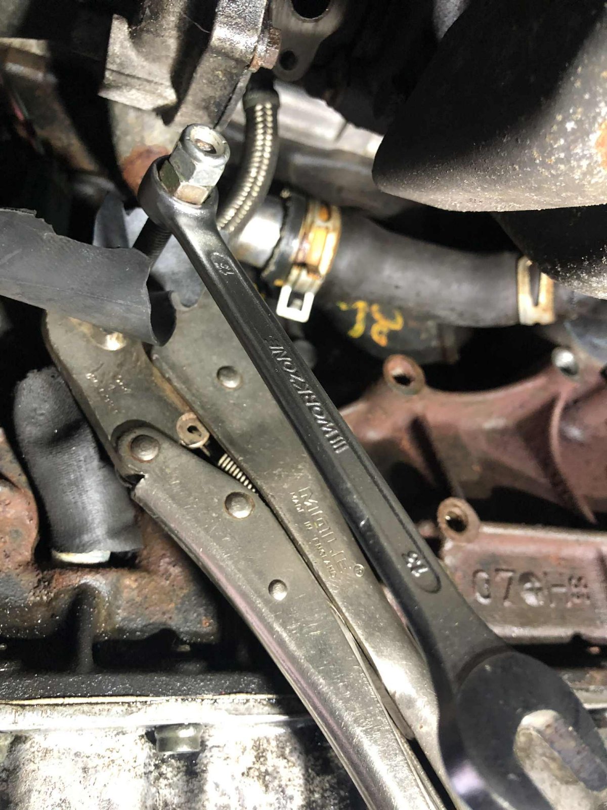

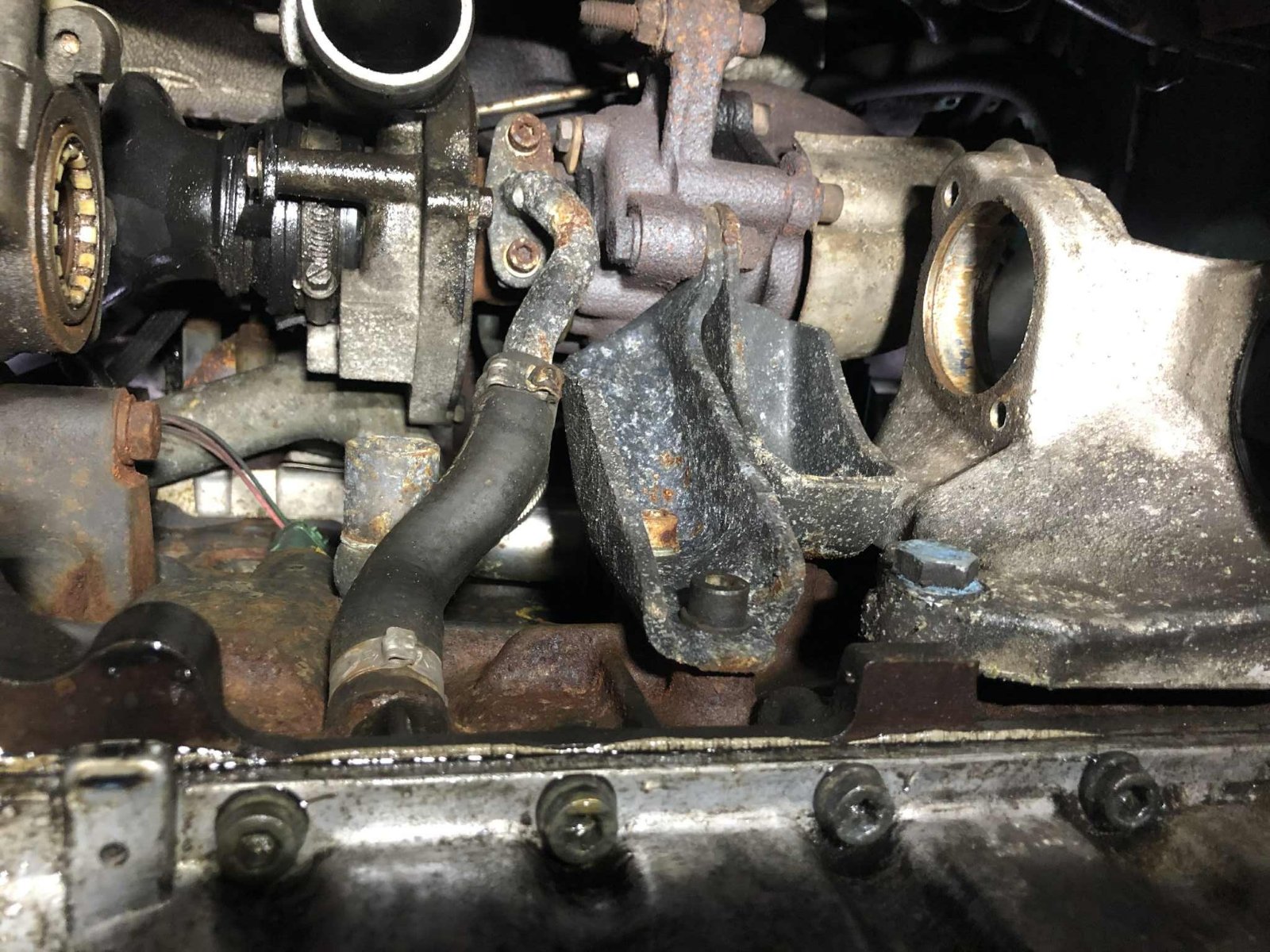

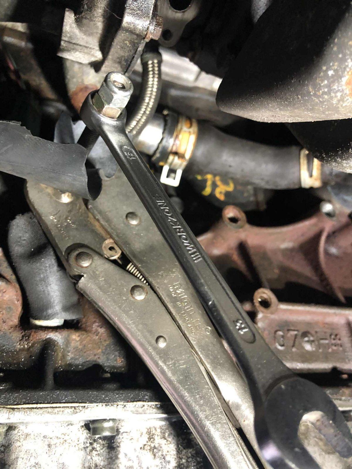

Not much further today as I've had to admit defeat on the Turbo Oil Feed line which is secured with a banjo type braided hose of unknown torque and despite my improvised tools requires a 14mm Hex Sump Key (another tool to buy despite my vast collection)...
The Men In White Coats are having Christmas anyway ....

So currently a further strip down is underway...Exhaust Cat removed, Driveshaft is out - made more akward and nerve-racking as the suspension is still pressurised.
Normally I would depressurise but I need clearance for any future loading that might be required. It's on ramps AND axle stands as stable as I can get her ...

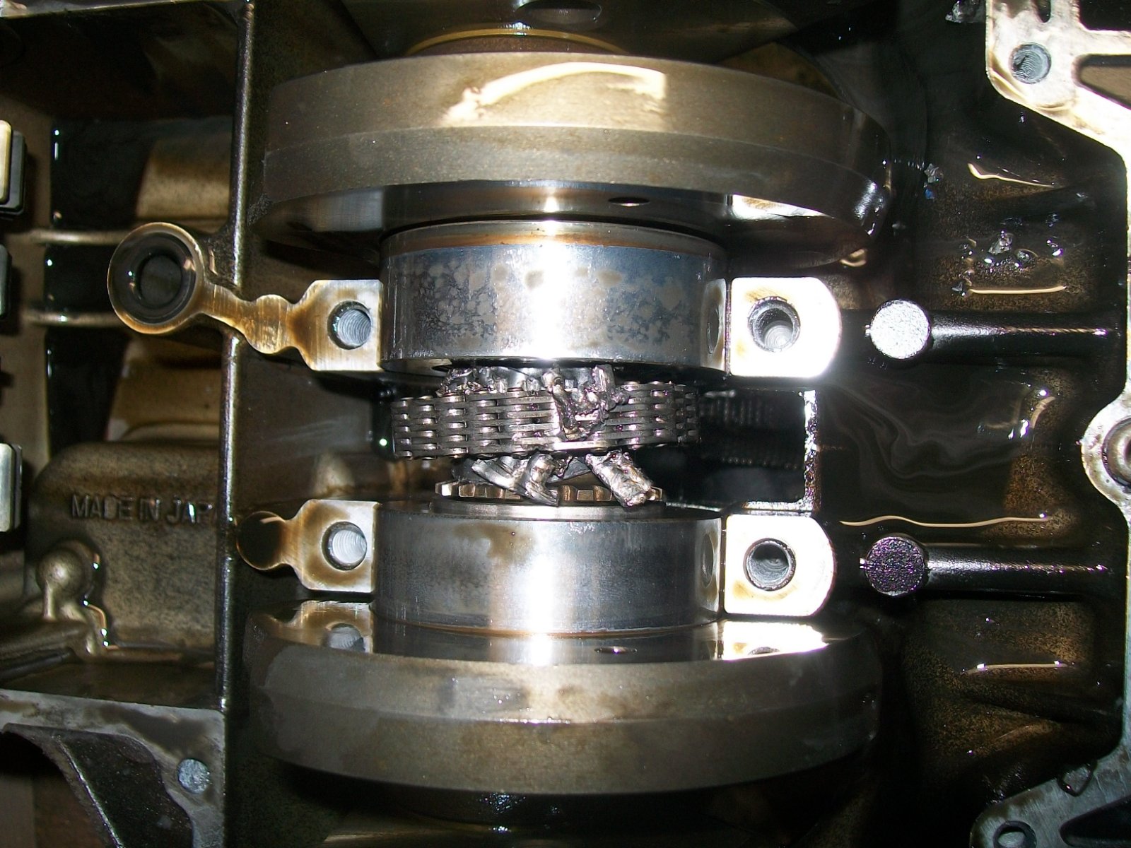

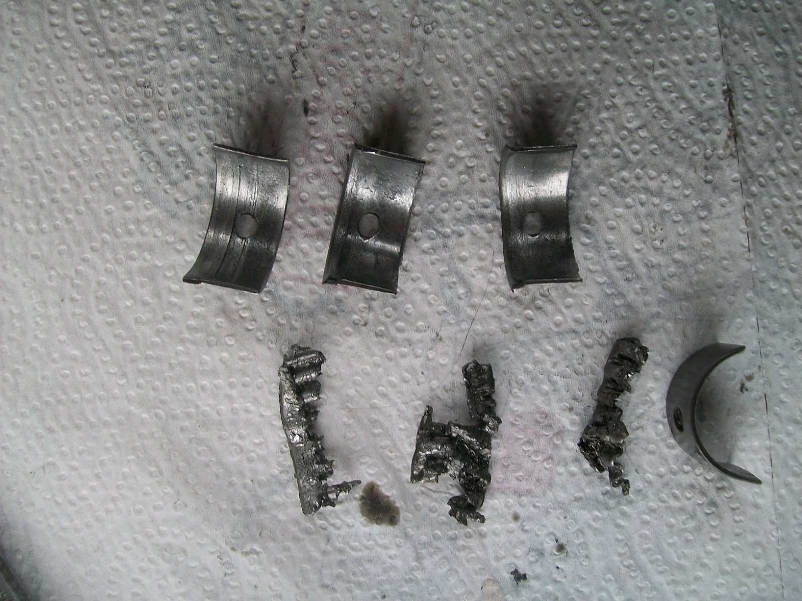

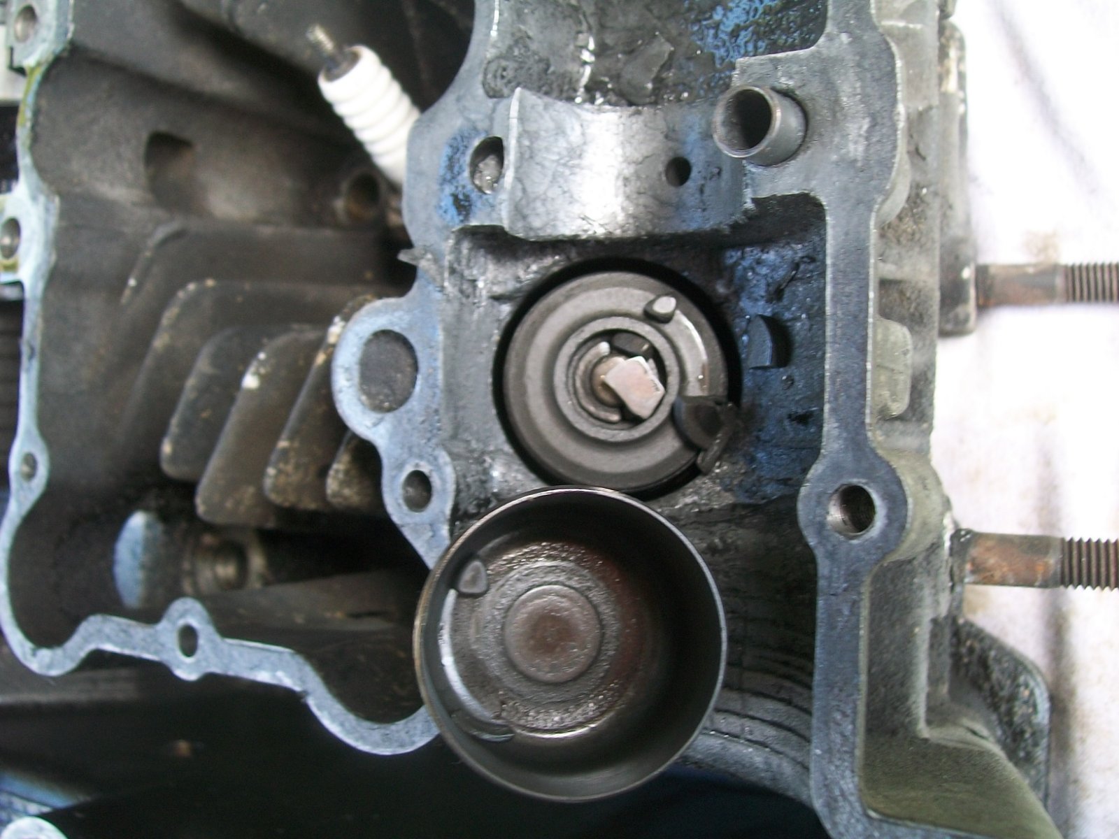

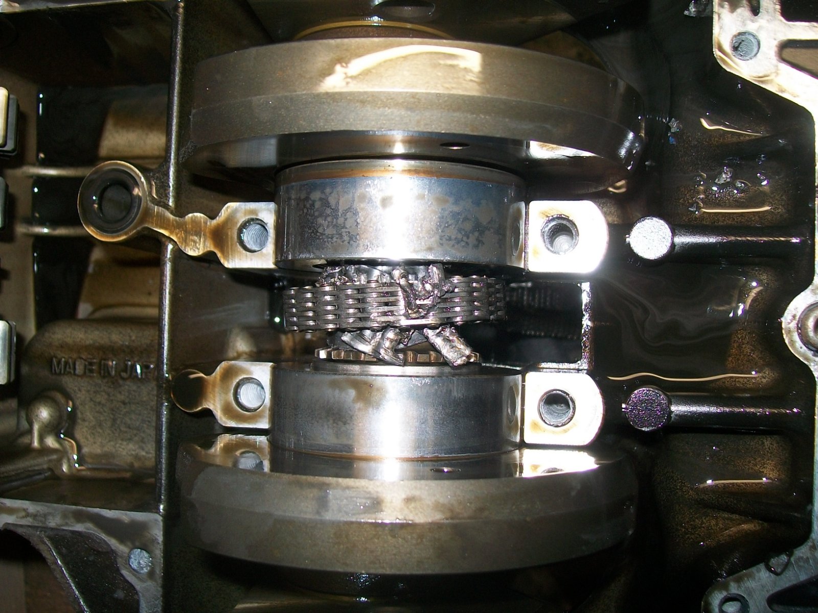

Whatever you find, it won't be as bad as this
or this
Cams are out, chuck some air down the cylinders
Pete
Skull
- (Donor 2026)
- Posts: 1357
- Joined: 02 Aug 2013, 13:35
- x 369
Gary
Gary
- Posts: 54693
- x 8151
moizeau
- Posts: 1857
- Joined: 12 Jan 2015, 16:08
- x 428
I bought the bike with a siezed engine. It had only done 5000kms since having a top end rebuild and new Wiseco pistons. The 'mechanic' (using the term in the loosest way possible) didn't know his arris from a hole in the ground. He either partially removed the camchain tensioner then refitted it of fitted the tensioner before fitting the valve cover. Either of these will cause the camchain to be massively over tensioned. This caused the camchain to be pulled into the head slowly eating away at the cam journals which then jumped down the middle of the engine and made love with the crank, breaking a shim and pushing the valve cover off in the process. The PO did say it was rather spectacular! It did mean I got my fuel injected GPz1100 from 1983 for just a little bit more than the price of the 1170cc Wiseco kit. Fiding a new head was fun, the bike was only made for 3 years but one turned up thanks to a chap in the Z1 Owners Club.
It's currently going through a complete rebuild, every nut and bolt frame and engine.
A long job with a few more hard to find parts to source but it will be worth it.
There you go Jim, bet you'd never asked now
Pete
