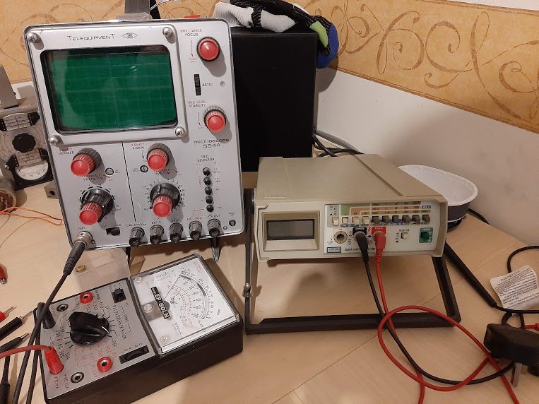

I'll agree that Flukes are both good and bomb-proof Peter :) I have two, one is a very old one in the radio workshop, identical to yours I expect :)
Keeping my vintage Telequipment 'scope and analogue multimeter company :)

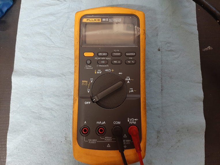

And in my car workshop I have this more modern Fluke... Cost me a lot of money at the time but been worth every penny :)

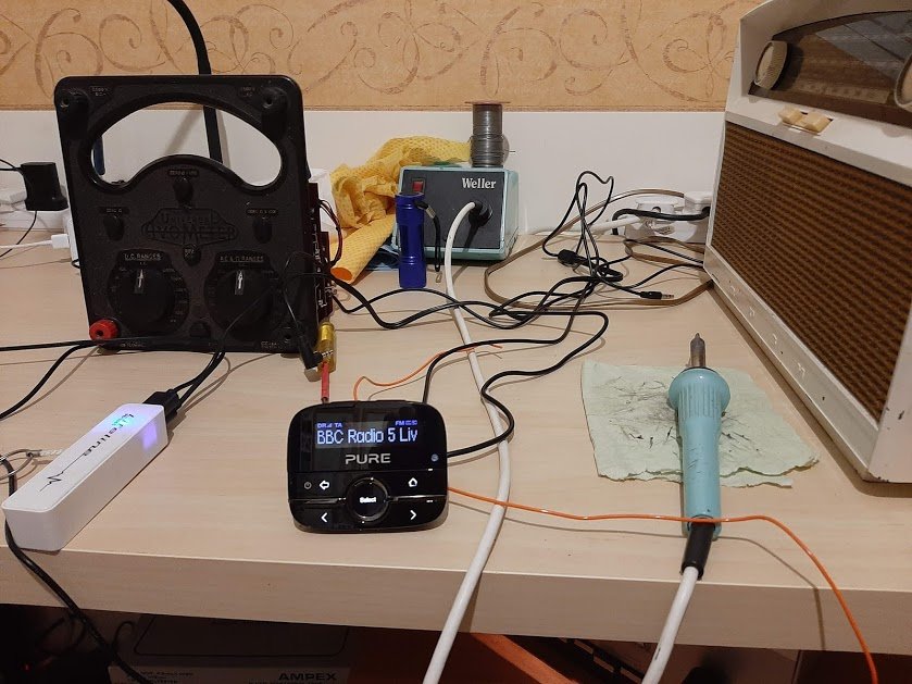

This is not very vintage - well, most of it is not ;)

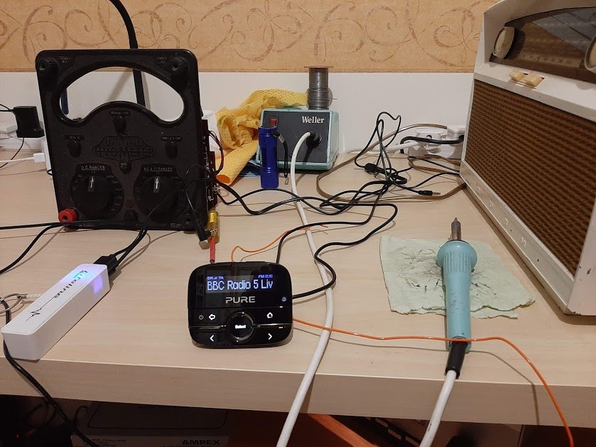

yesterday afternoon I was doing a bit on Daffodil, noting special, just a bit of interior work... I had the DAB radio adaptor on and it slowly started to do odd things and then it failed :evil: :( It became very insensitive ad would barely pull in a signal... very annoying when listening to the rugby :(
I removed it from Daffodil and move it to the radio workshop with the intention of returning it under warranty...
Just before packing it up I tried it again...
Remarkably it performed perfectly on test on the bench powered from a mobile phone booster battery pack...

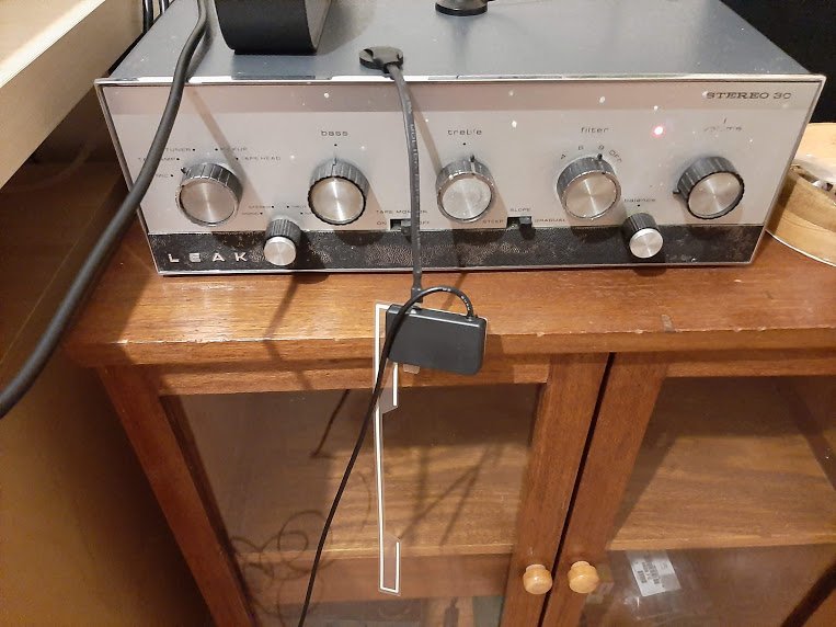

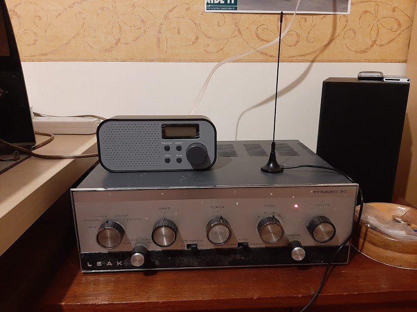

The DAB receiver is working with this little magmount aerial with my Leak workshop amp. case acting as a ground-plane!
The receiver is now on long test and seems OK... I can only assume it's not happy when it's very cold.... It certainly was very, very chilly in the garage with all the doors open yesterday afternoon 🥶
Note my AVO in the background still waiting patiently for reassembly!
I will report back after it's been tested for a longer period but if it is that it fails in the cold then that's poor although it's not unique these days... My old Tom Tom satnav used to refuse to boot when it was cold in the car and the flatscreen TV I use in the conservatory for my Zwift virtual cycling plays up when the weather is cold too, often taking several attempts to get it to boot...

When that happened with TV's it was very often the caps in the power supply dried up, probably not so likely to happen on 12 volts though. I used to run round everything with a hairdryer, when I thought I had found it a squirt of freezer would confirm it - or otherwise. :( :?

Speaking of which, the Pure DAB car radio adaptor died today... It went totally 'deaf', would not resolve any stations except very briefly and did not recover any sensitivity after a factory reset and an attempted firmware update...
It's now on it's way back to Amazon pending a full refund... I was pleasantly surprised to see just how straightforward it is to return a faulty item to Amazon :)
The most difficult bit was to remove the aerial installation from Daffodil... I made too good a job of it :)

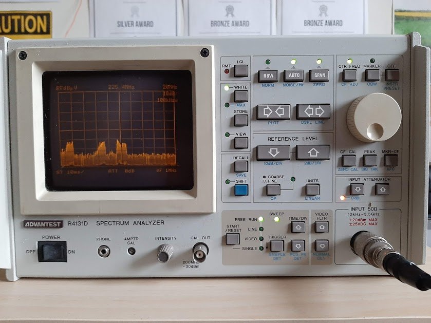

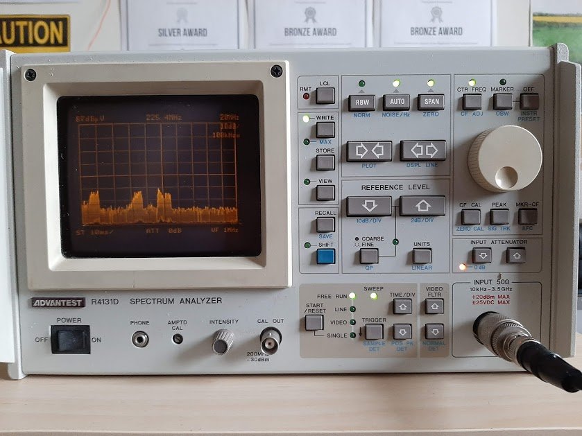

Before I fully condemned the unit I checked our nearest DAB Transmitter was on the air by checking with another DAB radio and looking around 225MHz on my Spectrum Analyser... Three ensembles (DAB Multiplexes) are clearly visible and coming in at good strength on a short length of wire...
DAB Ensembles
DAB Ensembles
The three ensembles visible from left to right are Sound Digital, Digital One and BBC National.
The Spectrum Analyser was duff when I acquired it... A display fault that wrote it off... The display is in essence a little CRT monitor and totally separate to the analyser proper... All it needed was a few electrolytics but being very compact and tightly packed it was quite a mission to dismantle and carry out the repairs...
The unit has seen a lot of past use as the CRT screen has the graticule and some static text well burned into it...

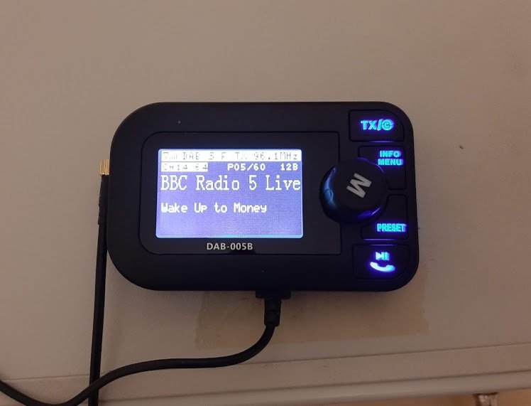

Amazon have already reimbursed me for the duff DAB car adaptor... Top service from them...
I got a replacement DAB adaptor but went for a different one... I'd lost any confidence in Pure products...
So I chose this Chinese one..
This one works brilliantly :) It has a great display, is simple and intuitive to use and even has Bluetooth 'phone/aux. input capability... It will work as a hands-free 'phone adaptor as well as having a MicroSD slot for playing MP3 tracks from a memory card 😮
RF-wise it is incredibly sensitive and picks up rock-solid signals on its active aerial when just dangled from the steel case of my workshop amp!
It squirts out a very strong and clear FM rebroadcast signal for reception on the car radio proper...
This one comes highly recommended and is incredibly good value at well under £40 :)
