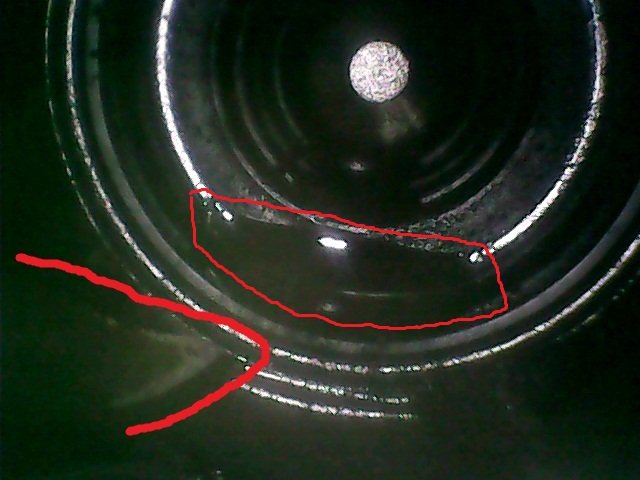

Skull wrote: 08 Dec 2025, 16:55
ekjdm14 wrote: 08 Dec 2025, 16:32 Really doesn't look like a bad piston to my eye, looks like a bit of liquid down the bottom & an otherwise healthy looking piston crown.
Agreed that's possible but to my eye there is a edge :dunno:
There is an edge but it’s not a chunk missing IMHO.
Do you have a compressor? Get some eye covering and face mask, blow it out with compressed air and look again. I’ll bet the shape changes.
As I suggested, you would have NO compression if there was a hole in the piston. Also consider this! To get an impression measurement you have to turn the engine over on the starter and it has to do many revolutions. The compression gradually builds even though the valves are opening and closing.
If you remove the cam, then the valves are closed assuming the valve isn’t bent or something is not preventing it from closing.
Only issue is ensuring that the correct cylinder is at top dead center when the cam goes back on.
Just seen the straw suggestion. Instead you could get a metre or so of clear hose and suck it out without tasting it. Easily done. When you suck it up, remember to stick your finger in your mouth and cover the end of the pipe.

Thinking about it, all you need to do is lower the scope down to the puddle and see if it moves!! :)
Posts: 54693
x 8153
Re: XANTIA HDi RUNNING ROUGH
A holed piston on a diesel is almost unknown... The engine is not yet dead. On life-support yes but not dead.
A bit of head work will likely see it good for a few more years :)
If the piston was holed, as you say Dan, there would be no compression and when Mick and I did our tests, there would have been plenty of evidence.
Off with 'er 'ead!!!

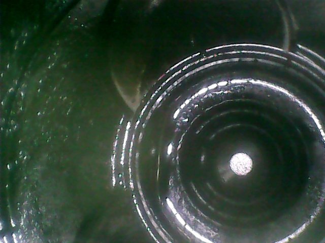

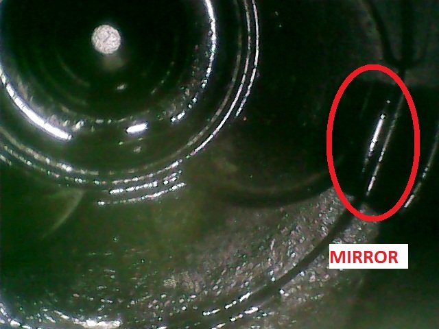

Skull wrote: 08 Dec 2025, 13:12 Well the results of my inspection today ....it's fair to say that it needs more than a Cam-Follower :twisted:
I can't tell from the camera orientation as it just gives a peep-hole view (edit: photos with fuel injector removed and camera inserted through the hole)
That looks like the final chapter @ 168K
I'm not sure whether this is a piece of the missing piston or the valve seemingly sat on a ledge or perhaps a piece held by the valve.
Skull's - piece = valve recess
It's now apparant that the 'piece' you can see in the above image is the Valve recess on the piston :oops:

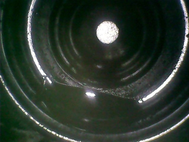

I went back in between today's rain and had another look, I lowered the pistons for a better view and I can now see that the hole/puddle is at the front of the piston .... the engine is canted backwards so if it was a puddle it would be at the rear of the piston (right side of first photo below), the valve recess is more to the front on these engines so I'm still inclined [sic] to think it's a hole ....
Skull's - Piston Crown
This one shows the mirror that fell off the endoscope :oops:
Skull's - Missing mirror

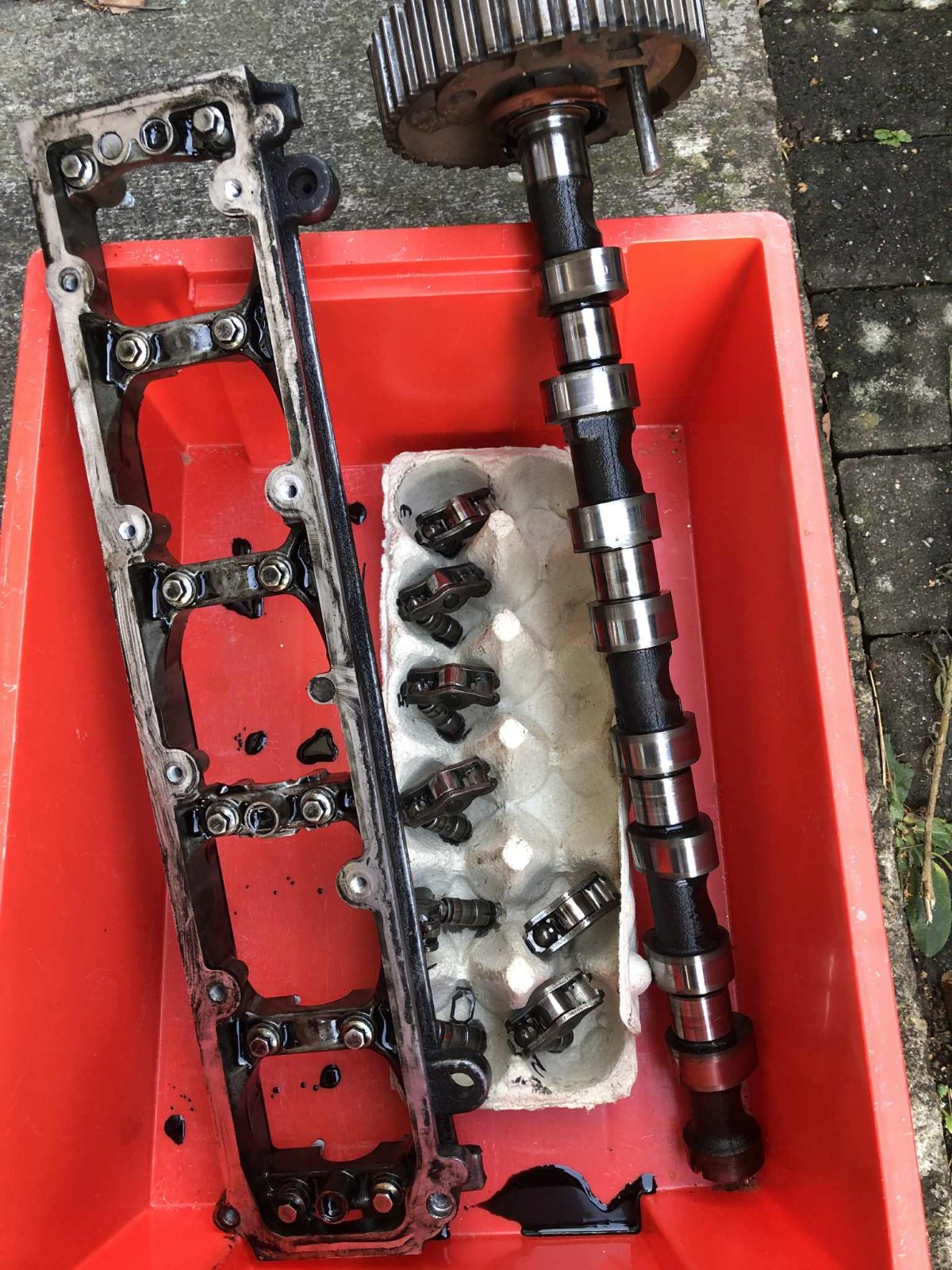

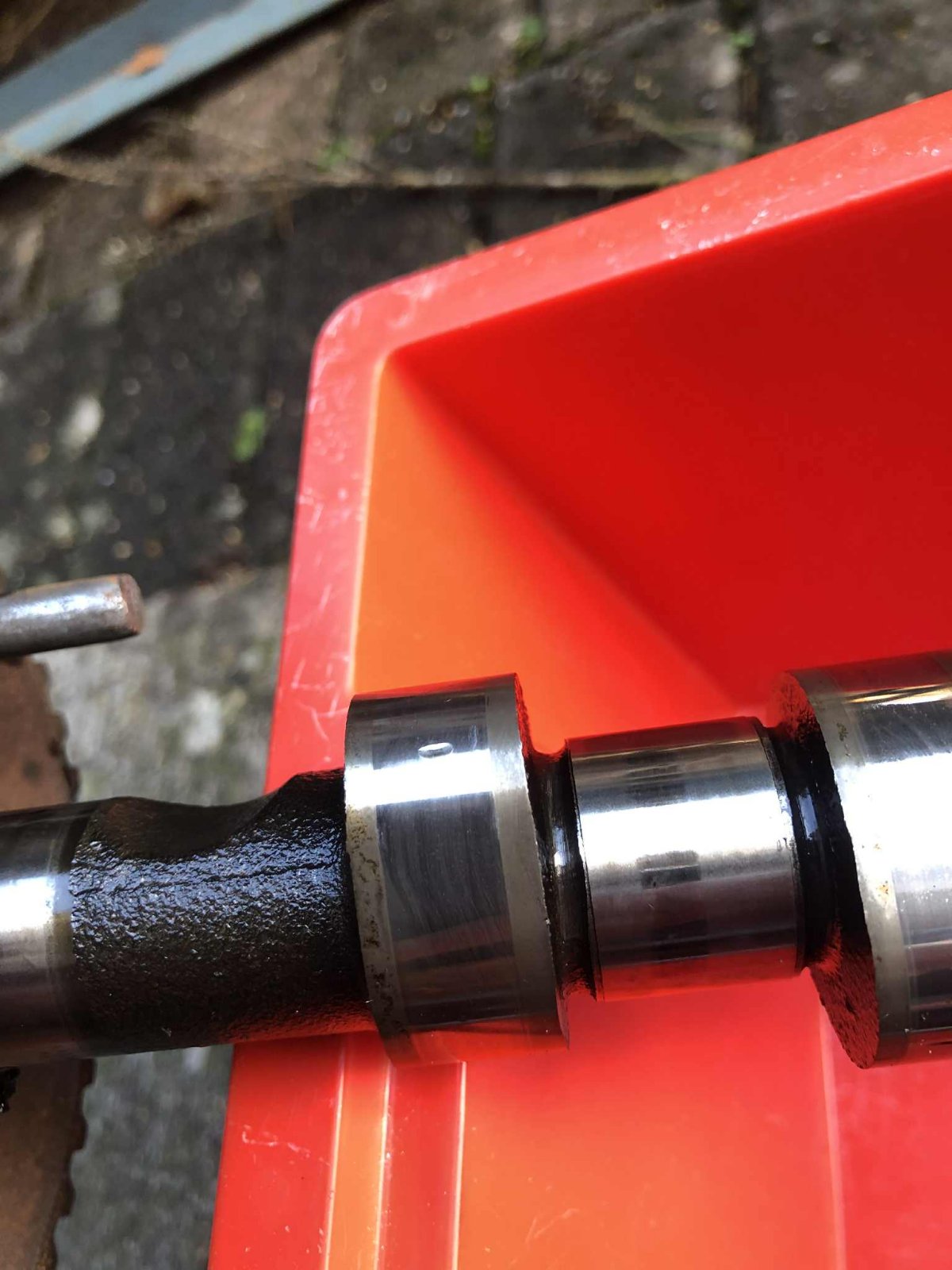

I've carried on and taken out the Bearing Cap for the Camshaft and Followers and noted a chink in the Camshaft - will that be a DIY job to minimise :?:
Skull's - Camshaft damage
Skull's - Camshaft parts
I note Rothgar's idea to try and re-test compression now that the Camshaft is removed, so all Valves should now be closed but also note his caution that this will also lose it's compression stroke position for any rebuild that might happen in the future, I haven't measured any valve spring height yet but I'm inclined to think it's decision time on 'head off' or 'new follower on and fingers crossed' .....
