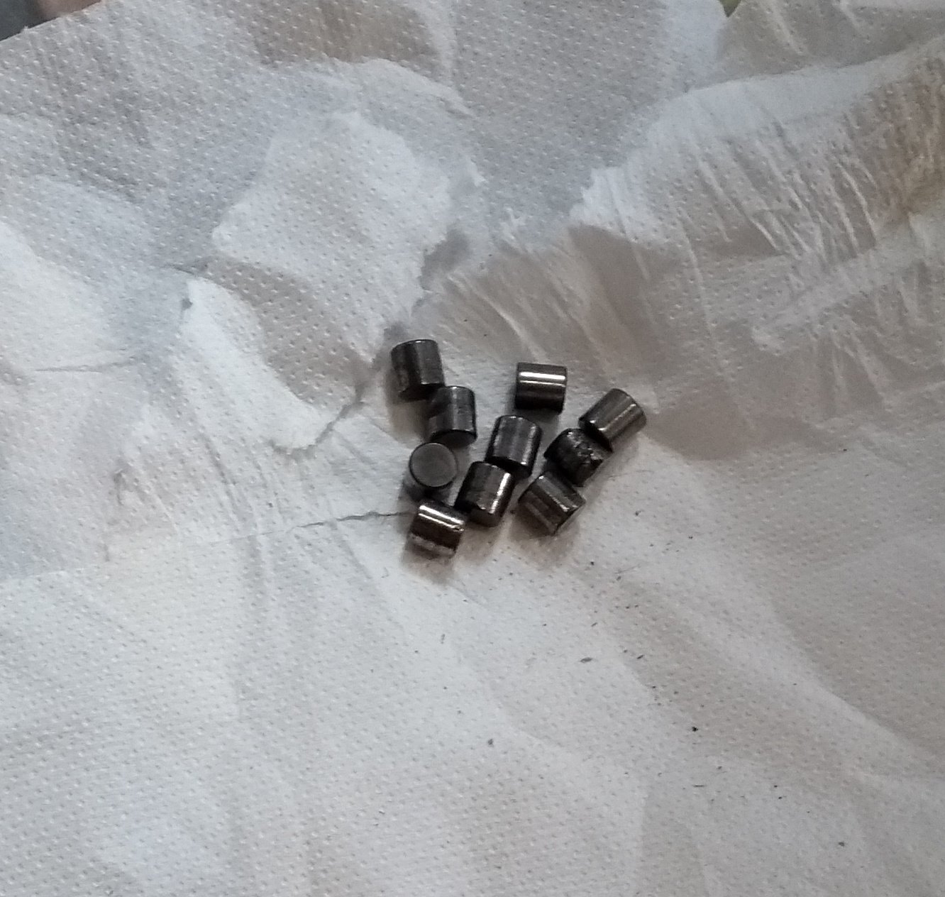

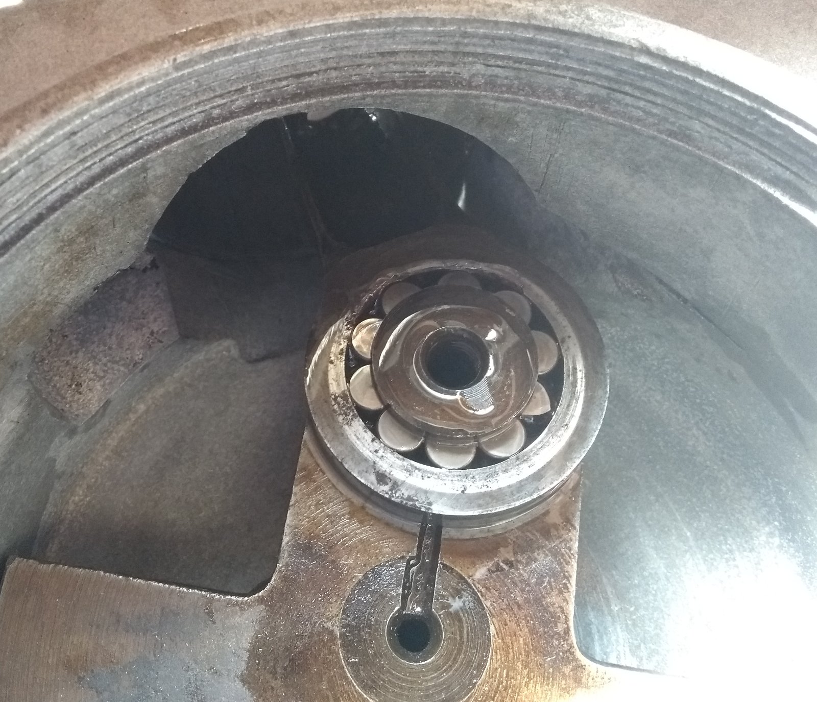

Definitely a roller bearing, Mike!xantia_v6 wrote: 27 Nov 2022, 11:52 I would not have expected a roller bearing in the big end of that engine, more likely a bronze bush or white metal running on the crank.
On that second photo you can see the different material on the inner ring of the con rod, which stayed shiny for 70 years, including 20 lying about in my garage, makes me think it's white metal!RichardW wrote: 01 Aug 2019, 21:41
Then I dropped the cylinder on, so I could refit the rollers in the big end
Some of these are in better conditions than others....!
However, soon becomes apparent that all the rollers need to be fitted to the crankshaft before the con rod is dropped over, that's going to be difficult with the crankcase in, so out it came again.... Easy enough to fit the rollers and then the conrod once on its side on the bench
Yes, the main is just a long bronze bush, this an overhung crankshaft. I think this will be effectively sealed as the oil is sucked in on the far end of the bush. The other end of the crankcase has the spacer piece , and then the end cover screwed in. I don't recall any sealing washers etc when it was dismantled, but that was 20 years ago!! Sure the piston is in the right way, don't think the engine would turn over it wasn't as there is a cut out in the skirt at the back to allow the con rod to pass. I'll get the side off and have another look / think!CitroJim wrote: 27 Nov 2022, 14:25
