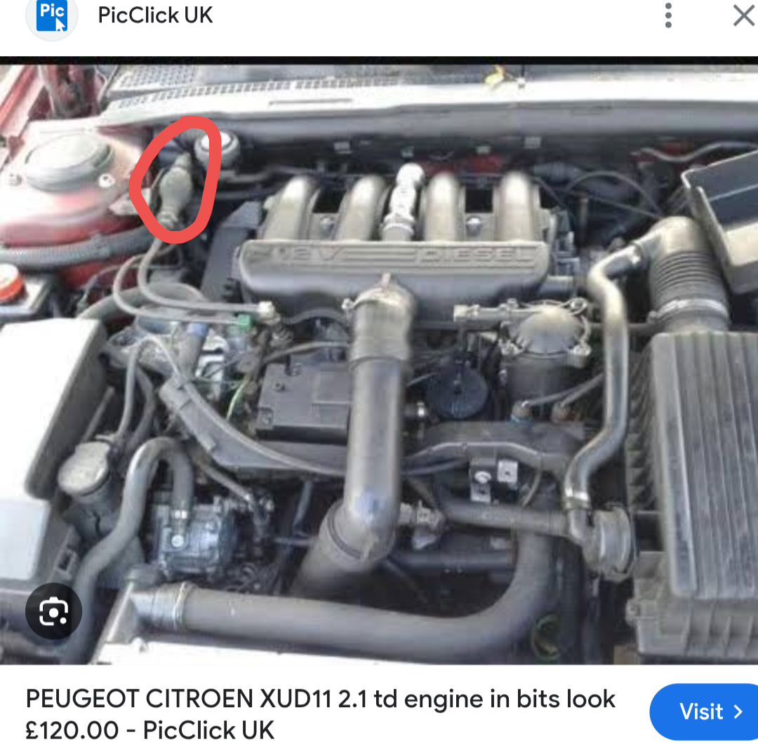

Normally these pumps have a rubber hand pump for manual priming. This is certainly the case for my partner’s ZX.Segansa wrote: 17 Feb 2026, 16:17CitroJim wrote: 04 Nov 2016, 12:48 You need to prime it first.... Get it full of diesel before making any attempt to start...
Hello sir, I know that this post of yours was almost 10 years ago, but if you can still help me, if you remember the details of “priming” that pump?
How do you get diesel in it?
I’ve fitted mine in, cranked it a lot by now, not aware i was supposed to prime it, but no fuel is coming out of the fuel lines of the injectors..
Basically pump that until it has good resistance. Sometimes it helps to have an assistant who can pump the bulb whilst the car is being cranked.

To add, with the ignition turned on to open the electrovalve to allow the diesel to flow

Very good point!moizeau wrote: 18 Feb 2026, 07:02 To add, with the ignition turned on to open the electrovalve to allow the diesel to flow
