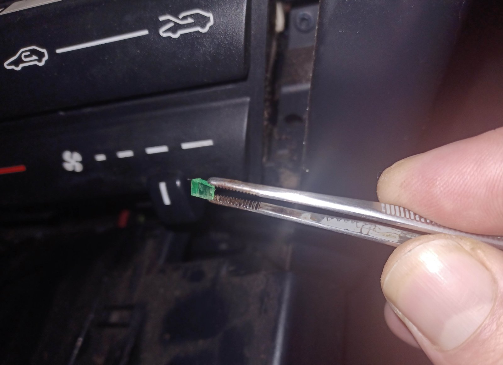

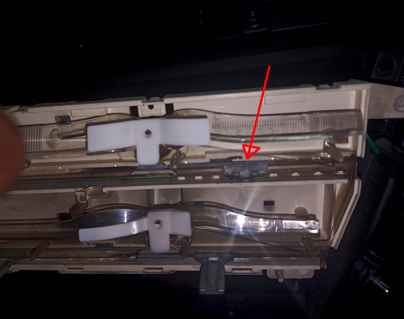

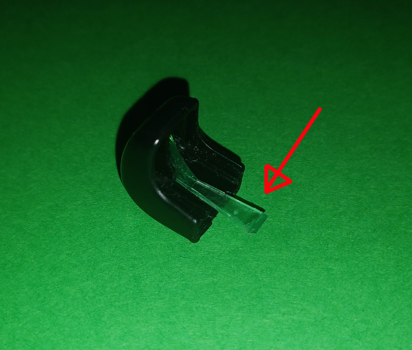

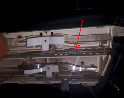

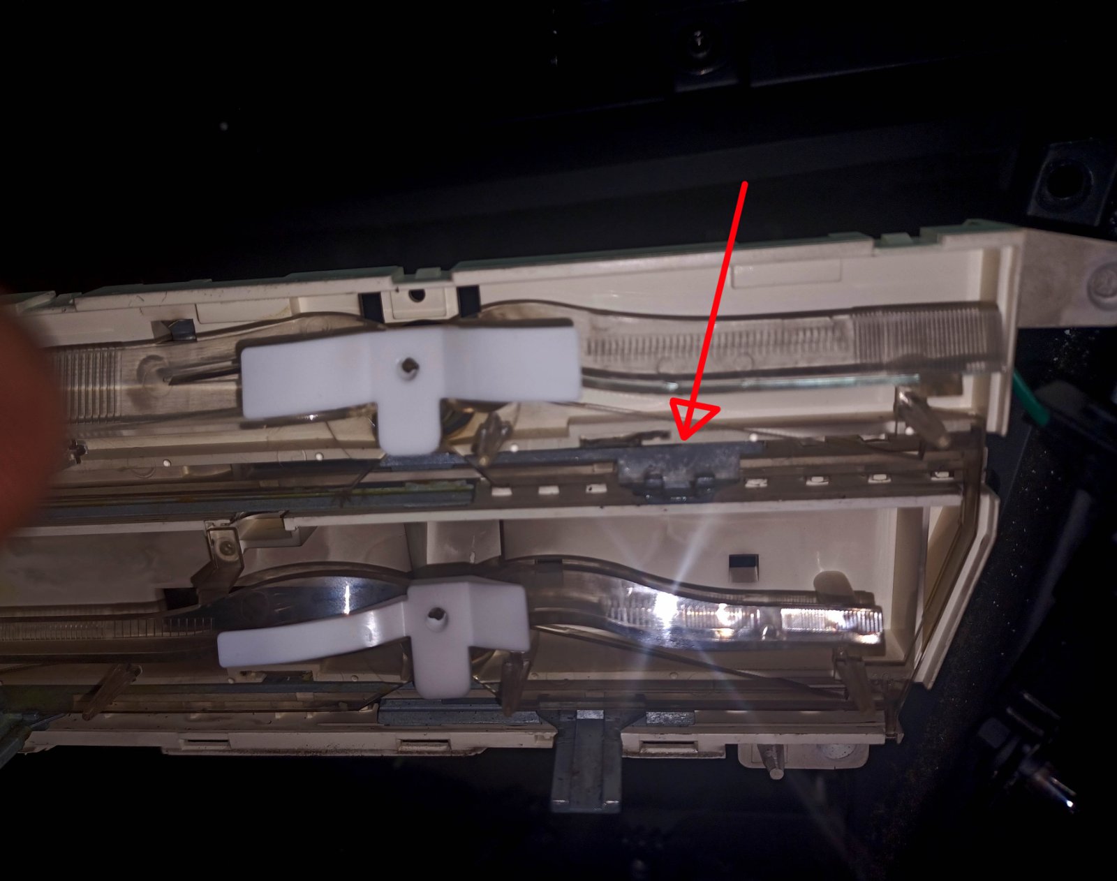

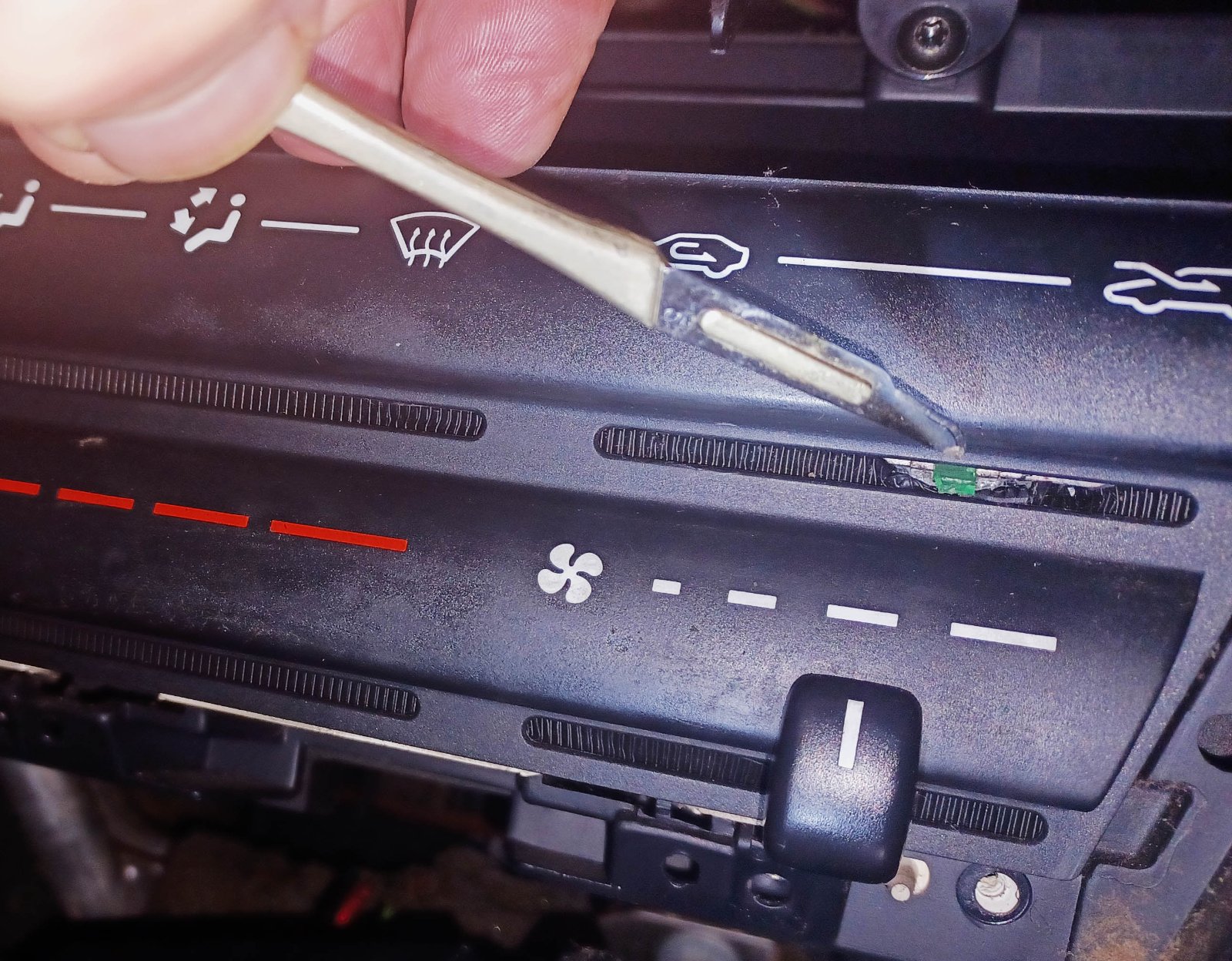

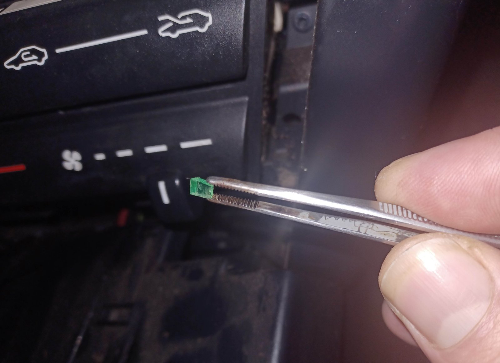

Here is what I first thought was the problem..... just the little bit of plastic broken off the slider "knob" So I removed that....NOPE, hot just that, Drat ! and !!...booger ...typical !....I (with the unit still in the car) I removed the front cover and confirmed it was the metal slider extension that had broken. So Fix it rather than suffer it....

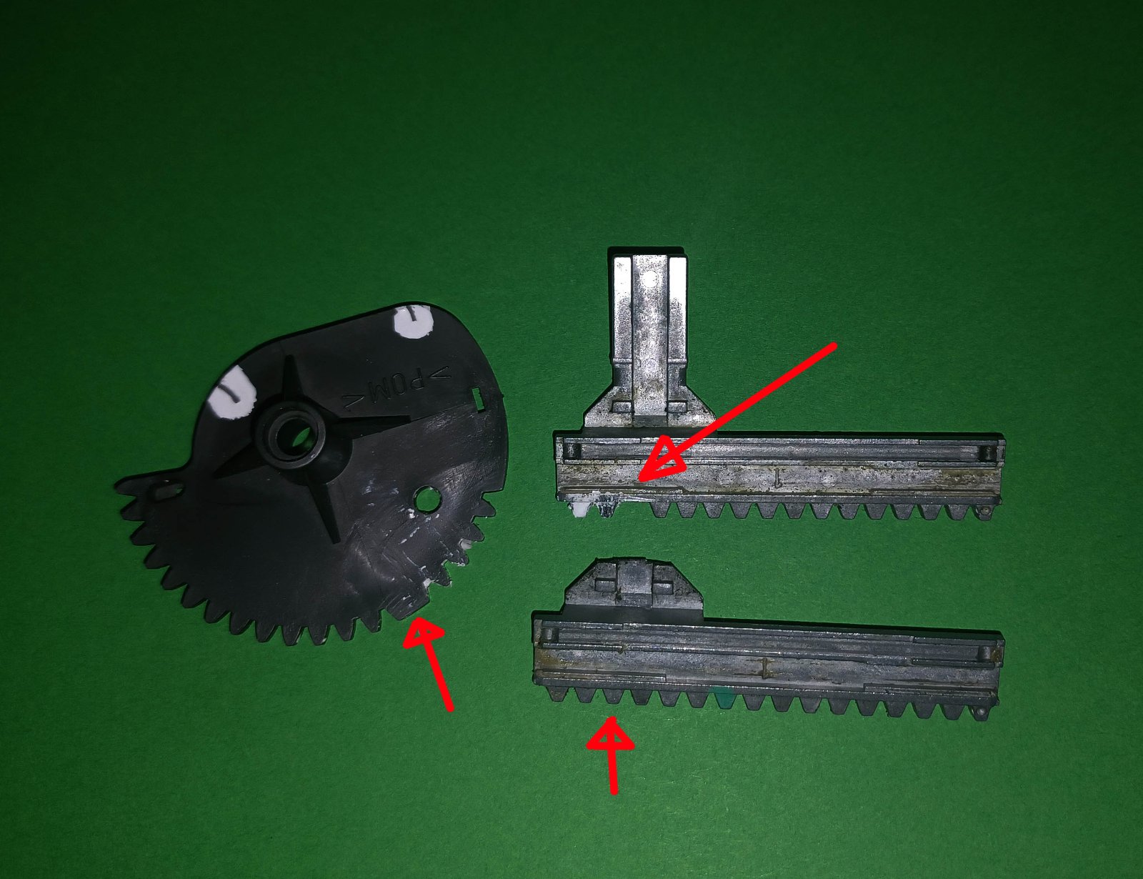

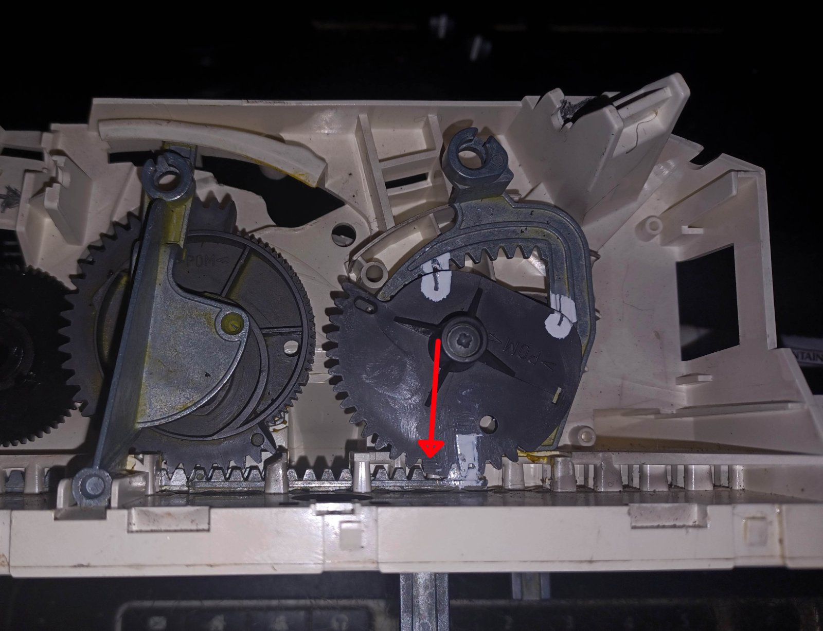

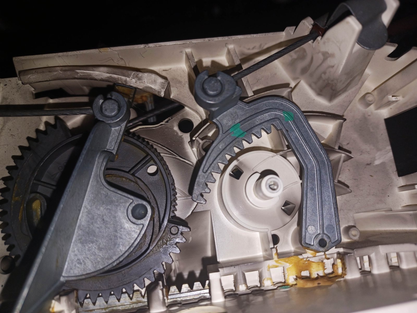

I had to remove (the later type spare unit shown) top gear wheel.....Note on the later one there is a "blank tooth" that allows the units gears to be lined up correctly. Under the top gear wheel
The gear wheel and top slider are from the Later spare unit, the bottom slider shows the difference.....
I will replace the gear wheel and the slider with the later one to fix it.

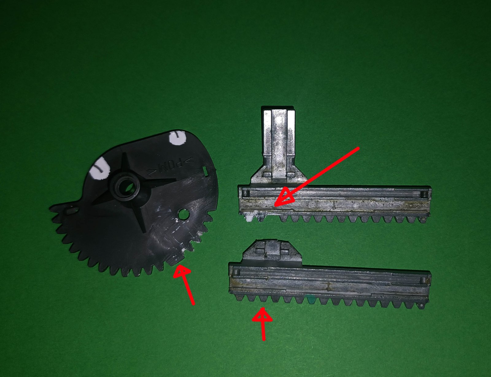

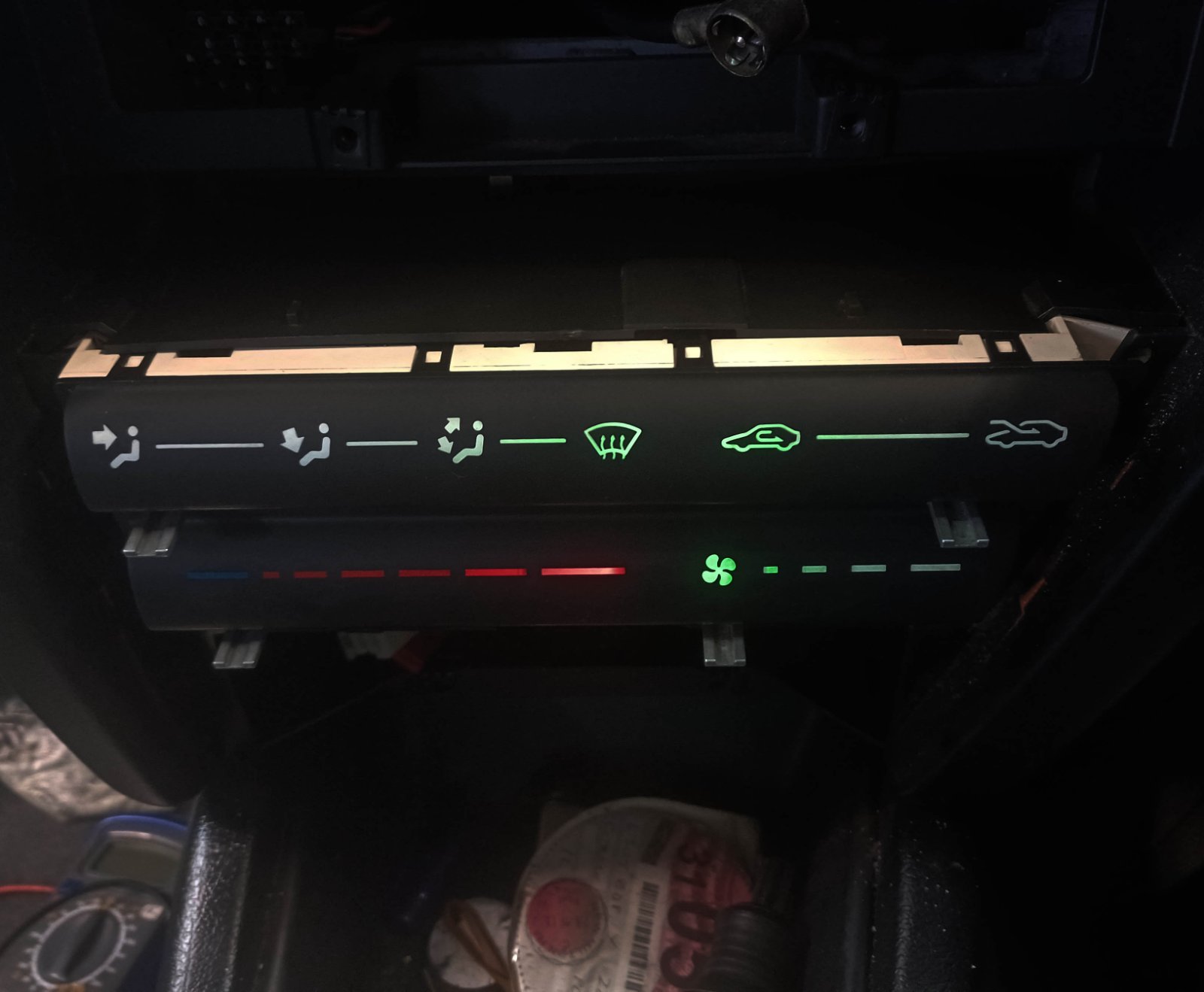

Well that is done then............I even fixed the lack of illumination.

Always good to see it lit Alasdair... I have need to do that in Strawberry - her heater panel bulbs are all out and so is one in her instrument cluster.
It's been far too long since I've had a Xantia; I forget they light up green! Far too used to the amber of my AXs and Picasso these days...

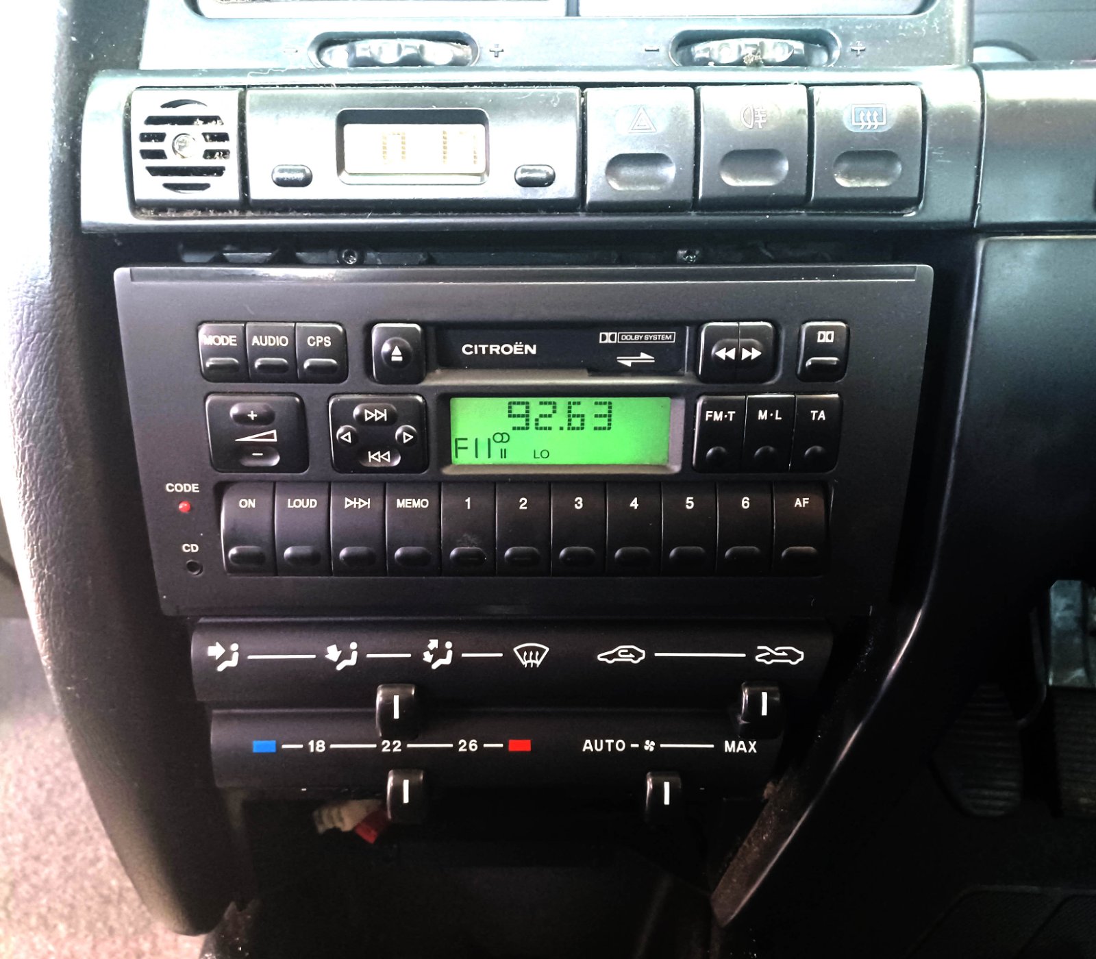

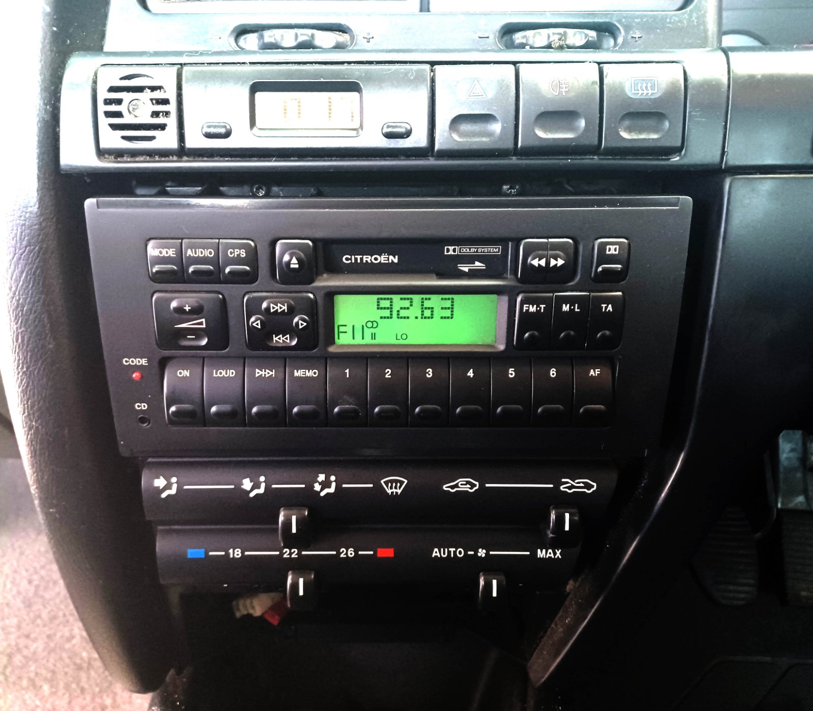

Moving on....... replacement radio works......speakers are bu@@ered & will need replacing (Halfords cheepo here I come !)
"Xantia Nerds" will note I have used the later facia plate with the --Auto- on the fan slide, the old one was brittle and 4 of the lower tabs were "open" and not holding well......
I can see MORE dirt & dust under the switches !
