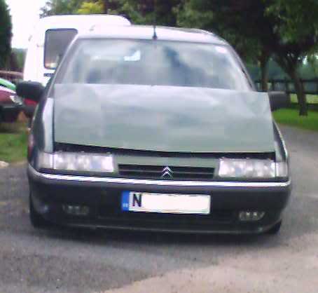

rowanmoor
- Posts: 43
- Joined: 23 Feb 2006, 13:59
Am I the first to report a case like this? Do I get a prize?
I took my XM to my Indy this morning, and I noticed a rather forlorn looking Xantia parked there. Apparently the owners son was having a driving lesson. 'When I tap my hand on the dashboard I want you to cause BOTH strut tops to come through the bonnet and say hello'.
Yes, simultaneous double strut top failure - caused by an emergency stop in a driving lesson
Luckily it sounds like it was just a lesson and not a test - I wonder what they would put down as the reason for failing?
I am pleased to say that nobody involved has even considered replacing the car - it is getting a new bonnet and pair of strut tops.
Check those strut tops - prevention is better than your son failing his driving test
On a more serious note, had it been a real emergency stop scenario then I would expect that would have caused an accident.

I would expect in a learner driver it did cause an accident - and not one that they would like to admit to!rowanmoor wrote:Am I the first to report a case like this? Do I get a prize?
Yes, simultaneous double strut top failure - caused by an emergency stop in a driving lesson![]()
Check those strut tops - prevention is better than your son failing his driving test![]()
I think that takes the prize though - a double strutter! Must have pics - get back to the mechanic.

Spotted this one on the Irish Auto Trader website today:
http://tinyurl.com/3787pg
Yeah, and the bonnet beaten back into shape...Motd Aug, Taxd June, needs front shock.

Double struter!
