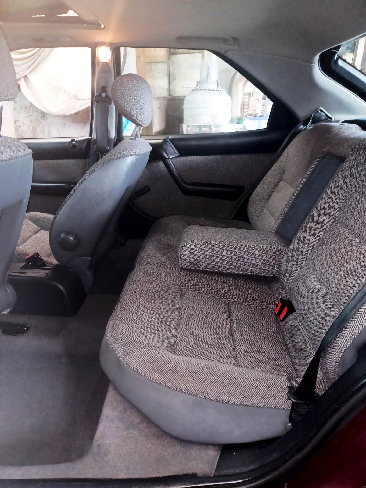

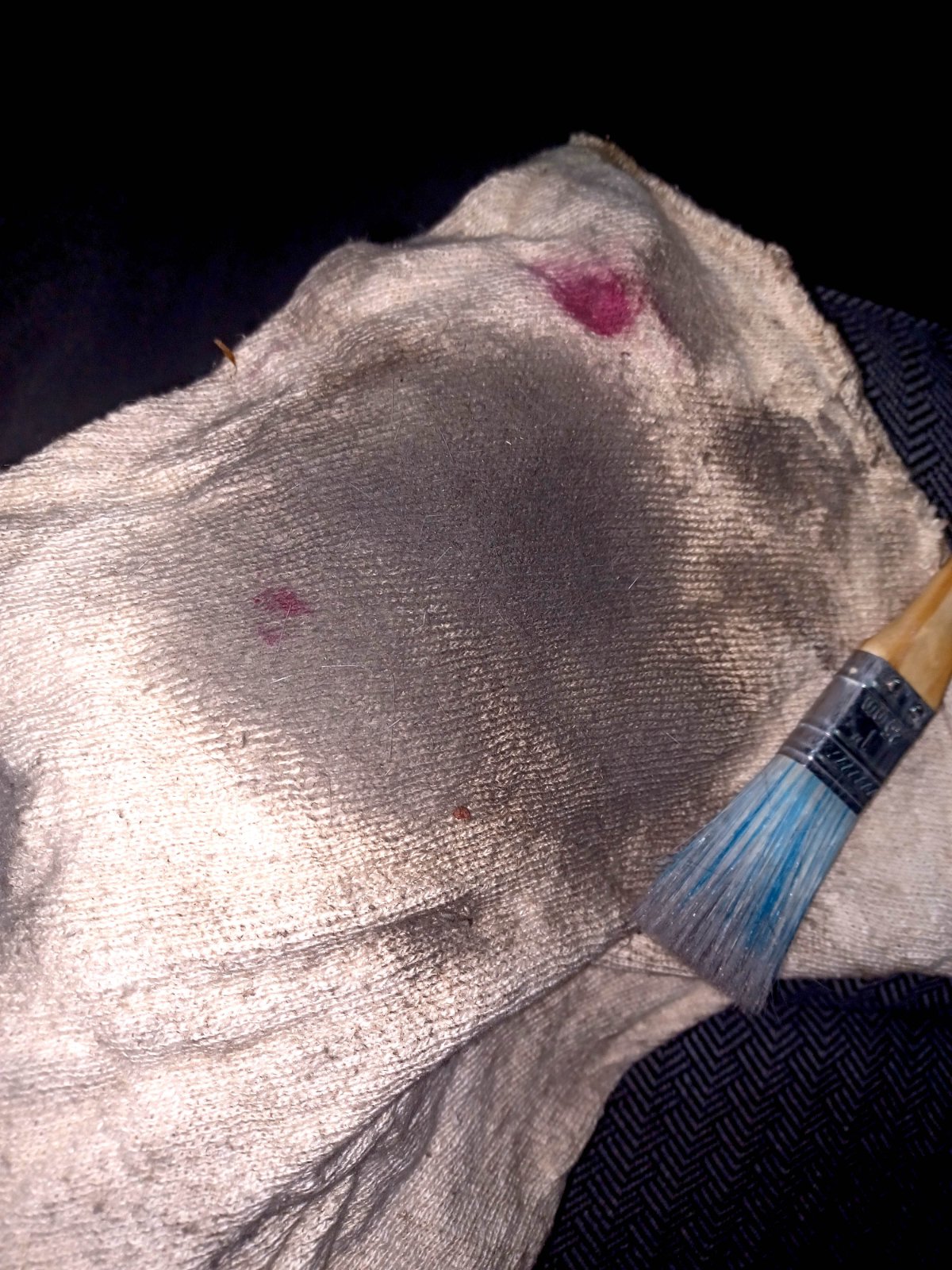

Well that is looking better.....smells OK as well. I have used a Ariel Washing Powder "Pod" diluted in a gallon of water as the final (of three) washes.....I now have the aroma of a Summers Breeze rather than Musty Garage and Old Sweat assaulting my nasal passages. I have a Air Fresh BOMB to use once everything is cleaned and dried.
One thing to remember, always clean out your air vents !
- Posts: 20364
- x 7865
Re: Xantia 1.9TD....wake up and back on the road after 10 Years
That really is looking like a different car from the one we found in the garage Alasdair, and don't forget you are cleaning value into it as well!!

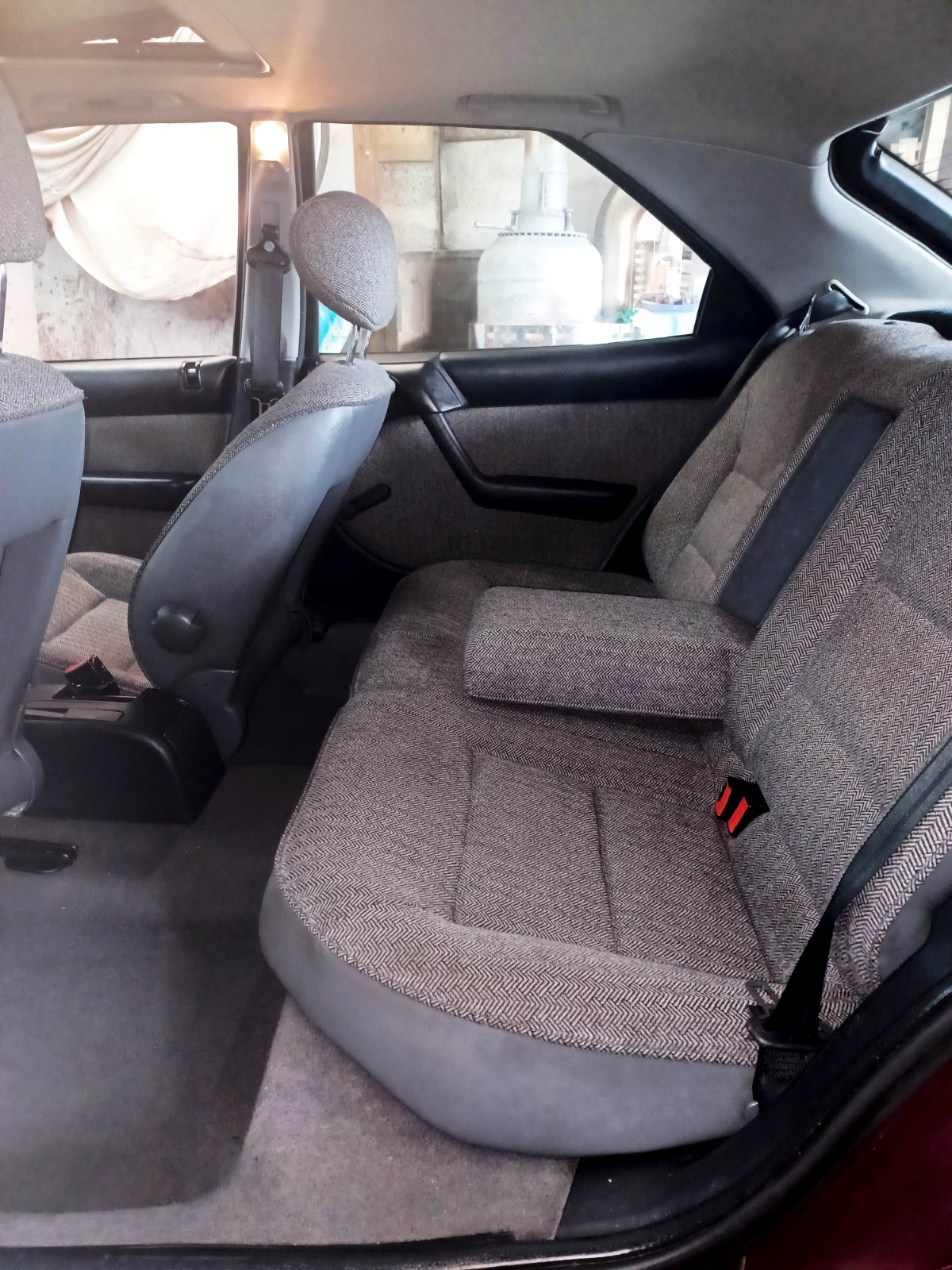

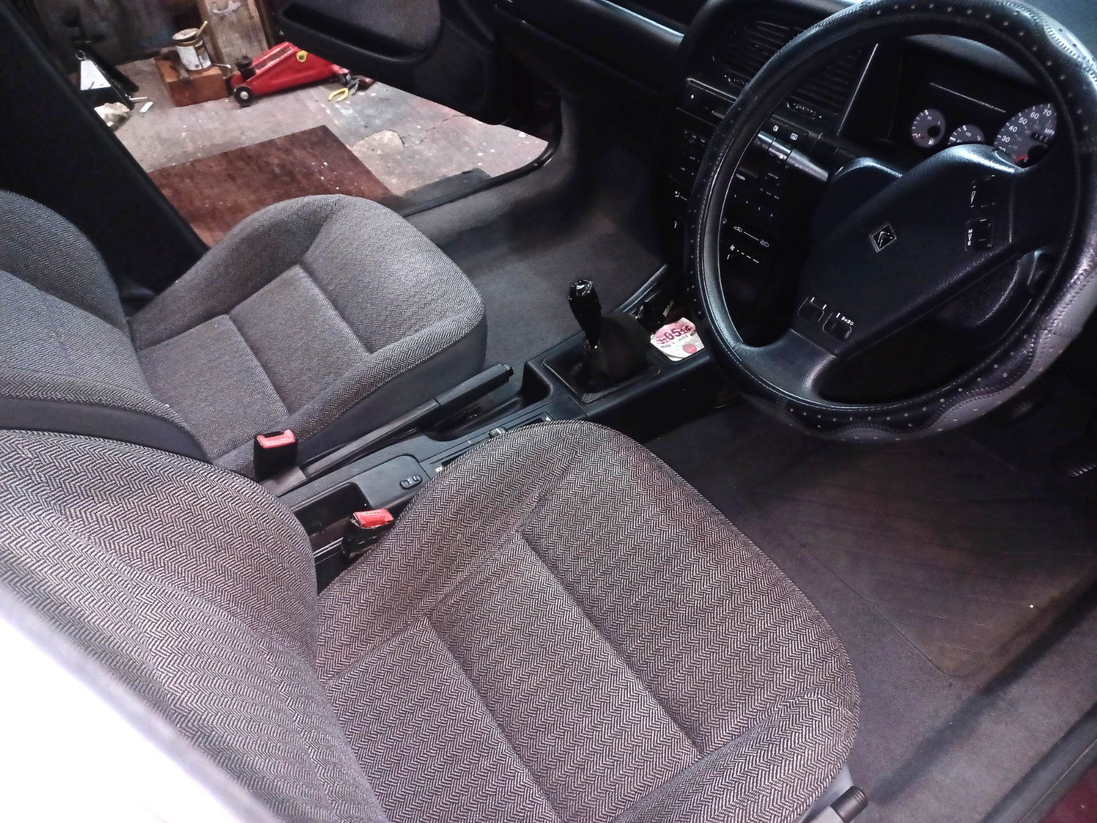

More cleaning today.....rear all washed/wet-vac'ed....other than the boot that is it all cleaned now so Jim should feel less nauseous on his next visit.

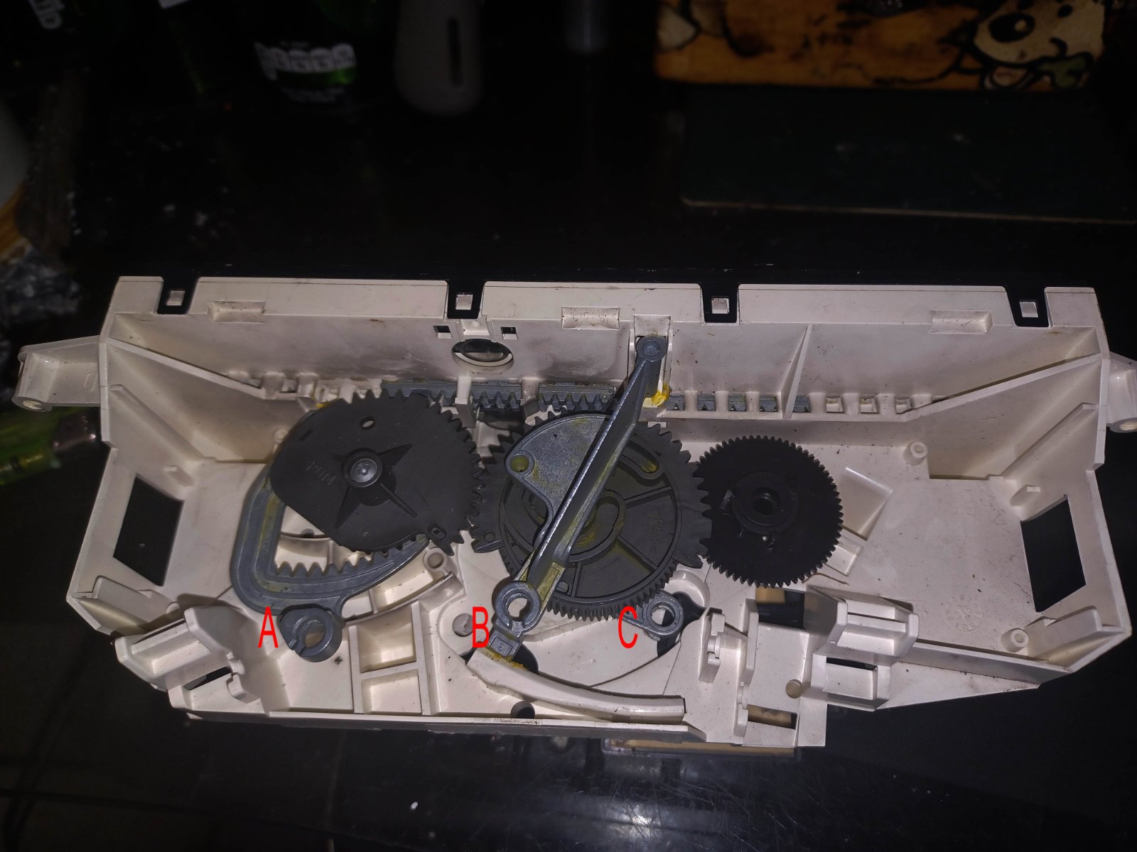

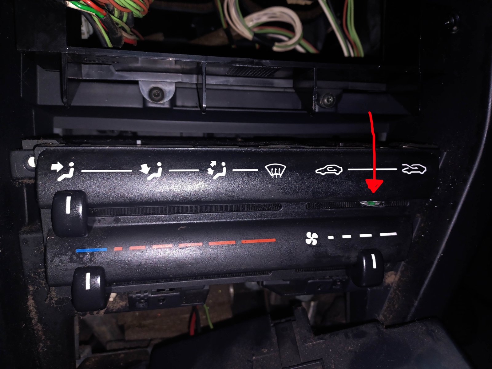

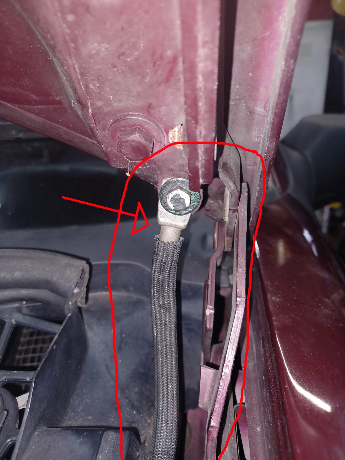

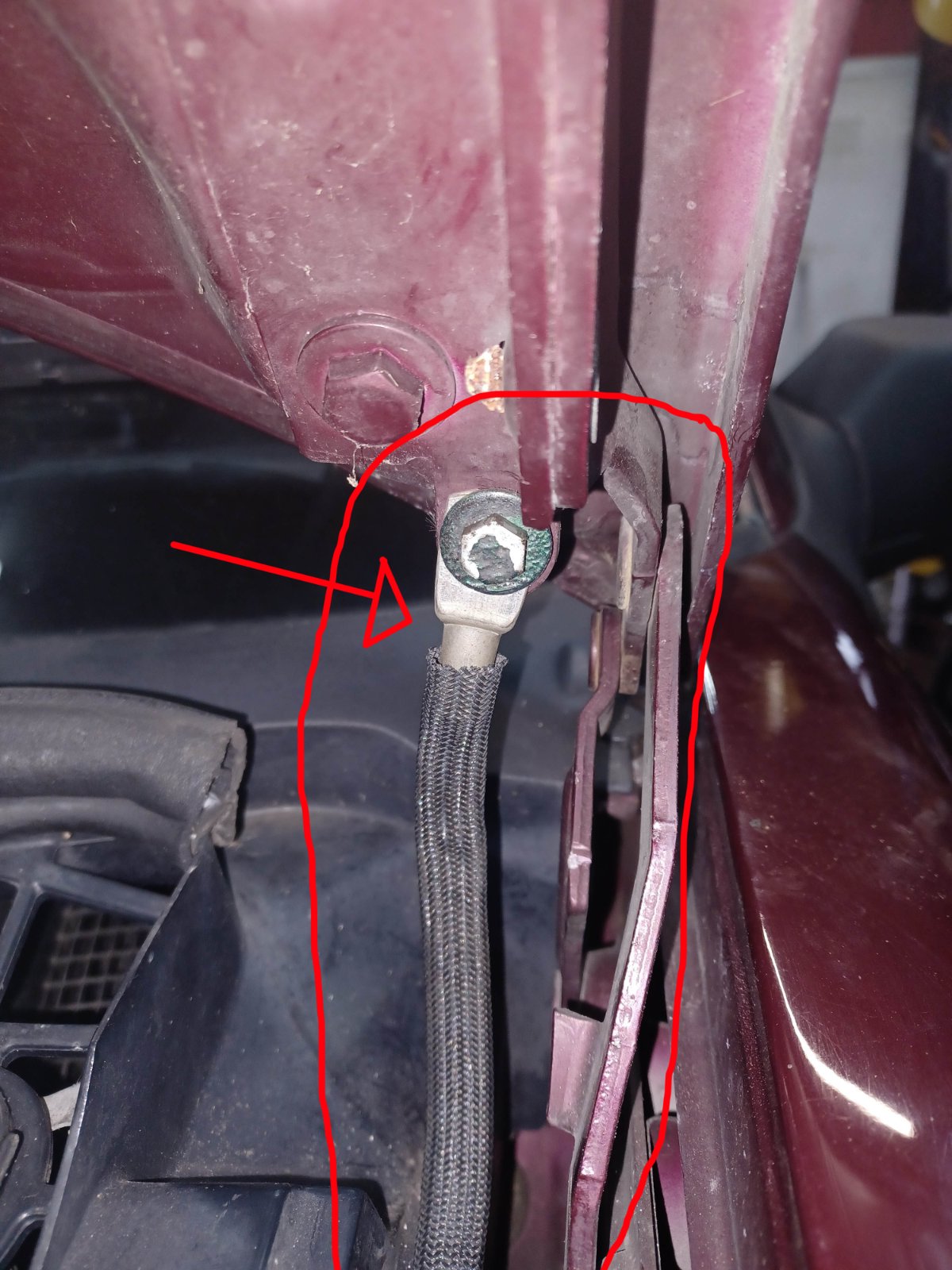

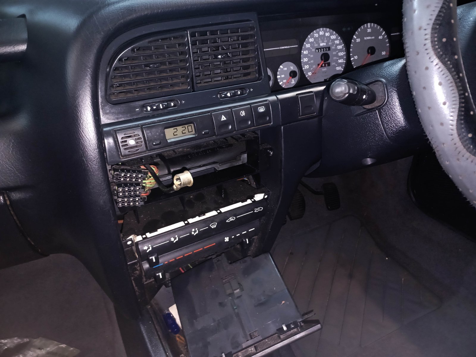

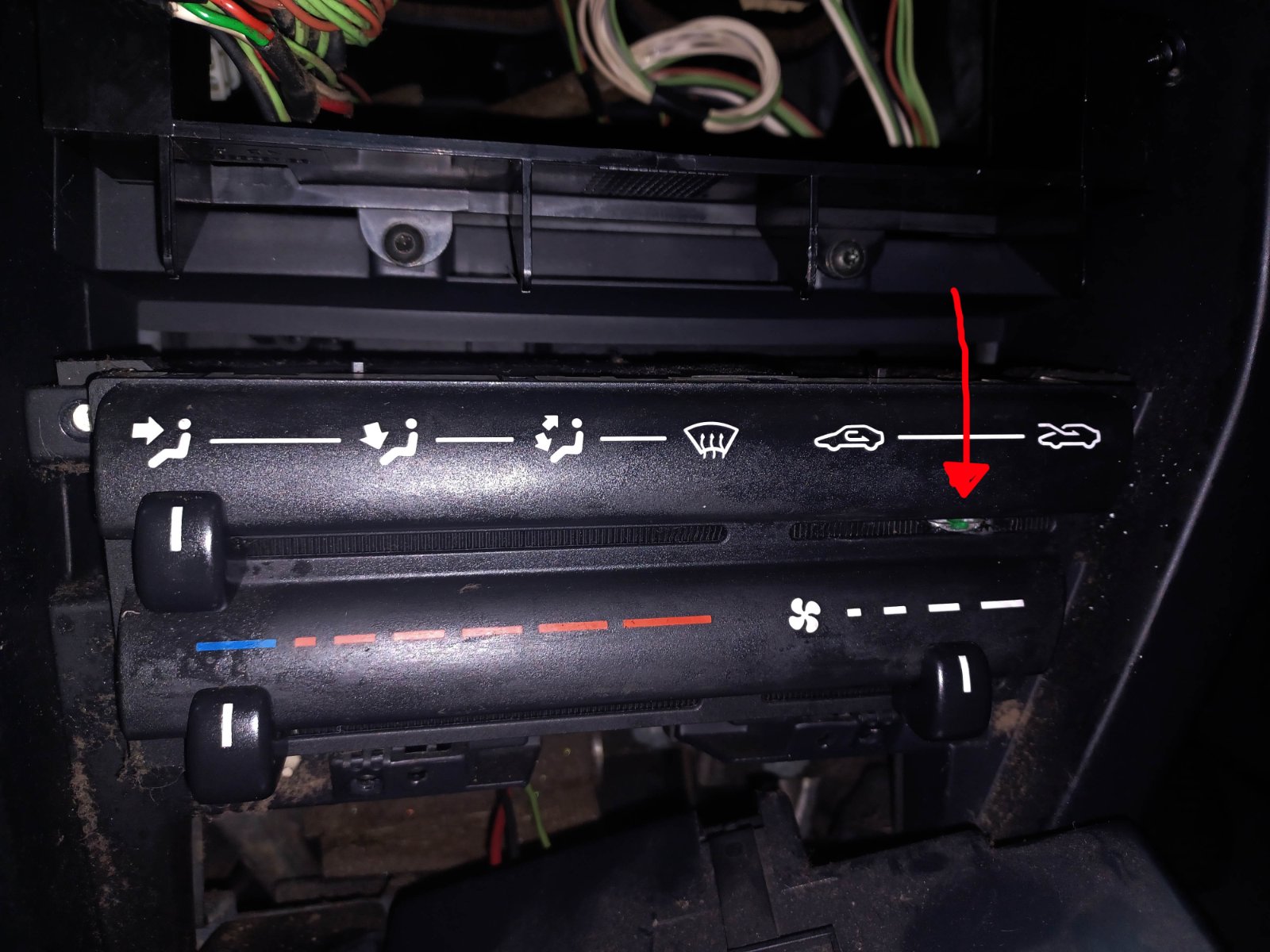

Bonnet earth strap fixed, I put the straps broken off end into a large crimp fitting then filled that with solder...bolted back on. The radio needs a code.....which I do not have....but I do have a later one with an Aux input socket & I have the code for that. I will gift the old one to Jim (a cassette type) for him to experiment on in his dungeon or electrical monsters. Not sure if it is worth converting the old tape to Bluetooth as it may be that it has very poor quality output. Also at the same time I need to address this little problem......snapped off before I got the car, the cable is tight. I think I will have to replace the heater control unit itself which is a real PITA I think. That is all for the day...........

The heater panel is nowhere near as much a PITA as it looks... You'll find some kinky bowden cables are at the heart of the problems with it, the recirculation flap is usually the one that suffers as the flap itself seizes up...

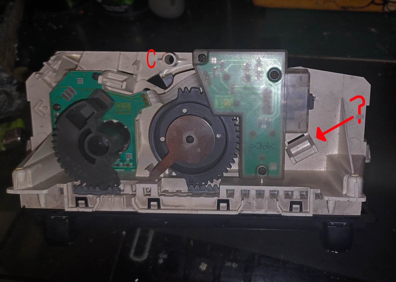

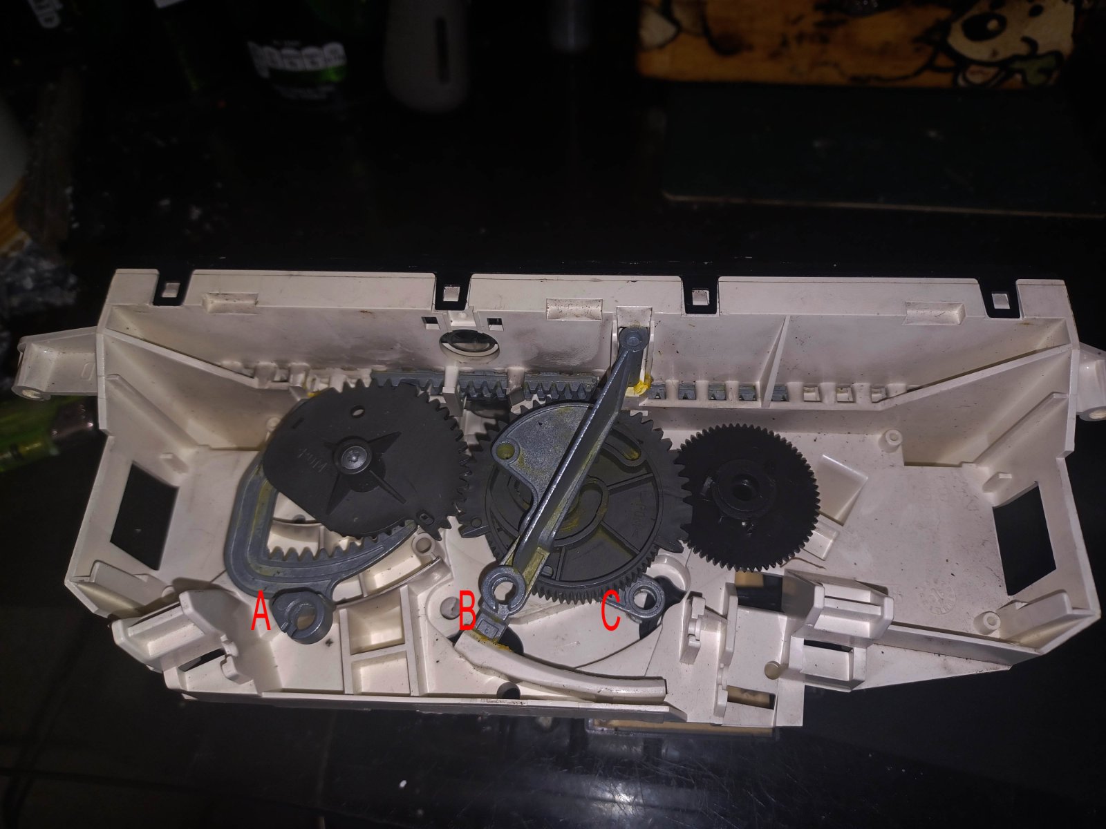

I have a spare heater control unit, but looking at it I cannot work out where one of the cables go.... I can see where 3 go.......but the 4th eludes me atm

One of the cable anchors for the controls is only visable/insertable when the control is in a certain positionStickyfinger wrote: 10 Nov 2024, 18:47 .... cannot work out where one of the cables go.... I can see where 3 go.......but the 4th eludes me atm
A, B, C.................C also can be seen from the underside

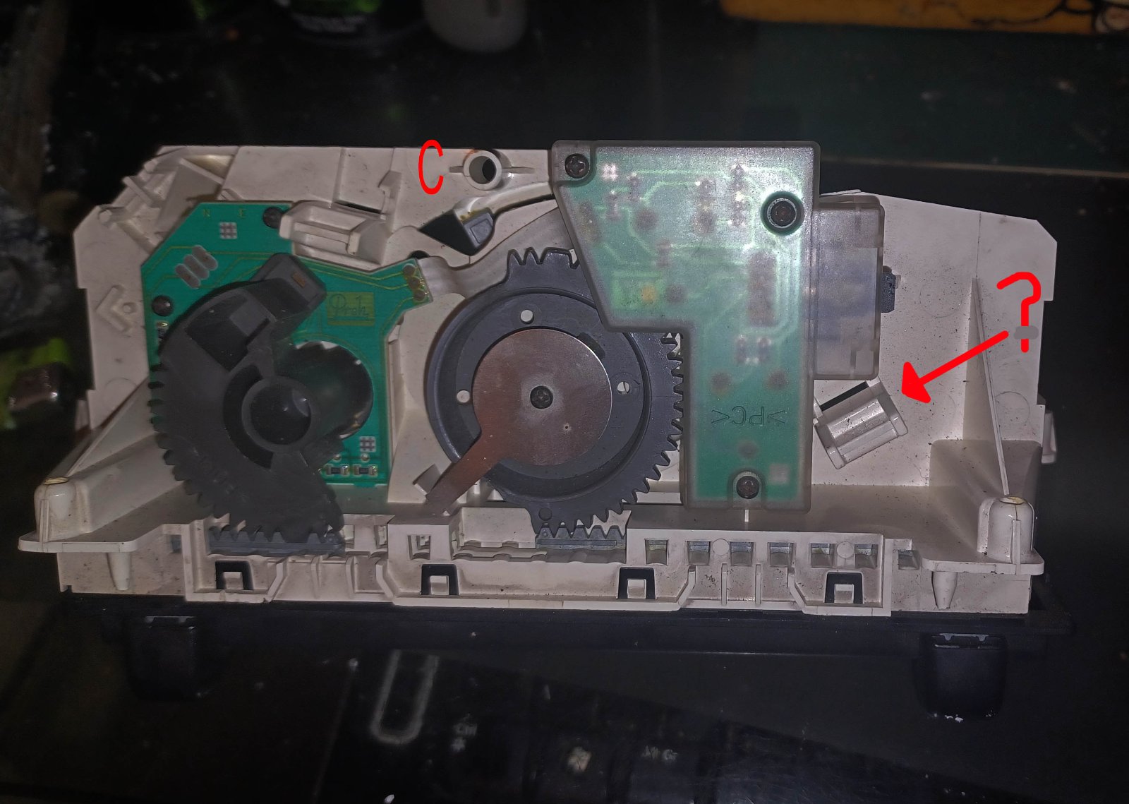

Where the hell is D ?... I see a "clamp at = ? but no socket for a cable end like the others.
"?" Does look like a clamp point for cable D but it looks like you'd need to remove the 3 screws holding the L shaped pcb in order to secure the locking clip and I DON'T remember having to do that last time I repaired one?

?? Could this heater control unit be from the wrong type of Xantia Spec ??.....this car being a very early base spec car could it differ from later cars/cars with AirCon for example ??

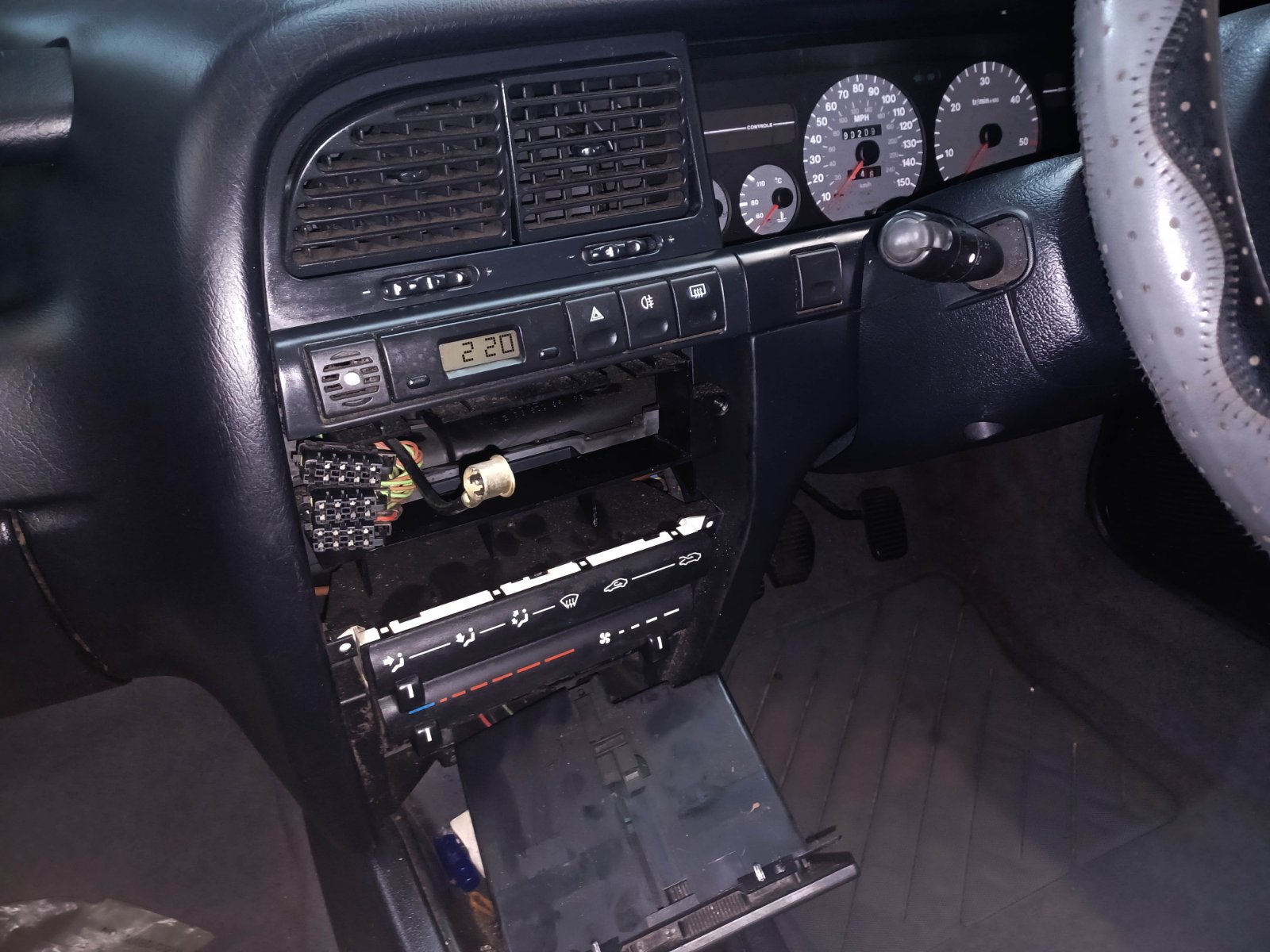

Ah ... your photos of it in situ doesn't have "AUTO" on the fan speed or temperature setting digits range 18 - 22 - 26 ...maybe that is the problem? Is your photo of the internals a replacement or the original?
I have seen 3 different control panels for S1 Xantia, there are 2 for cars with A/C, I think they both have an Auto on the speed control and the non-A/C car had 0-1-2-3 I think. Or maybe it was marked as per your pictures above.
