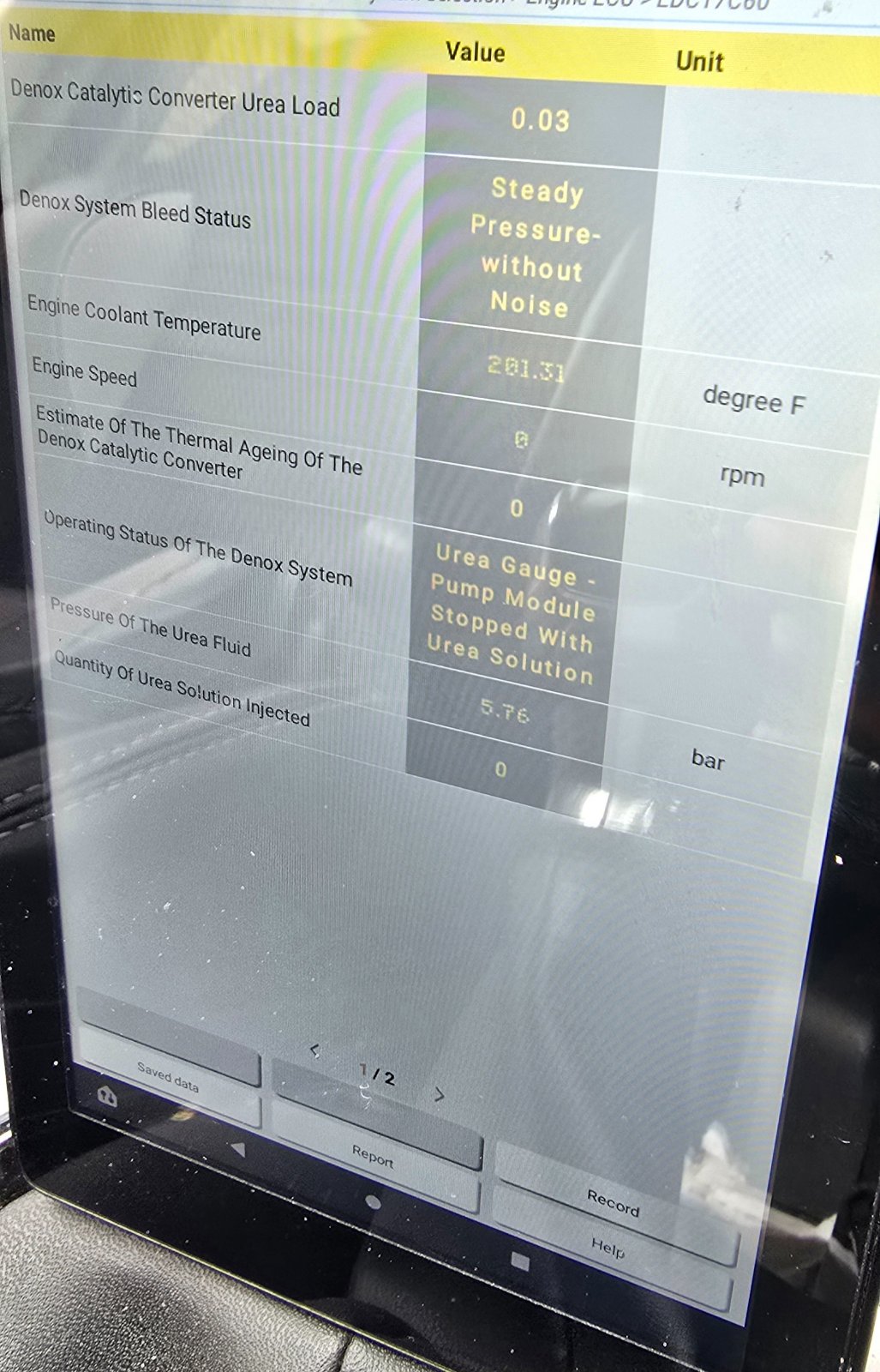

Took the diagnostic with me today and could see the pressure sensor increasing to 5 to 6 bar.
So far seems to be ok did around 6 miles today.

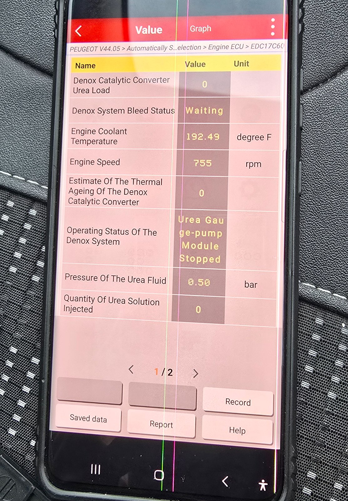

Yesterday did around 10 to 12 miles constant driving and on way home heard a beep and looked it said engine fault have vehicle repair which shortly followed by the urea emissions fault.
Anyways I got home and put it on diagnostics and the pressure sensor showed 0.50 bar (picture attched).
I cleared the fault code reset everything but pressure still remained at 0.50 bar not sure why. I took tank off again (maybe for 20th time now) disconnected sensor and ran car with faulty alibaba sensor (showing 4 bar) then cleared all codes and reconnected the external sensor (Stewart one) pressure sesnor started working again got to to 5 and 6 bar.
I did read someone was saying their van got 0.50 bar too in previous pages of this forum but wasnt a solution given for it?
Not sure what happened there now?

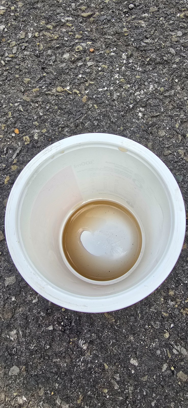

When i disconnected the pressure sensor i noticed the fluid coming out the the sensor pipe was brown? (Pic attached) but the ad blue in the tank is still clear.
Is the motor causing the fluid to go brown or is it the copper fittings (one on the pressure sensor and another is the copper T connecting the pipes from tank to the sensor)? Could this brown colour of adblue be causing the problem?
