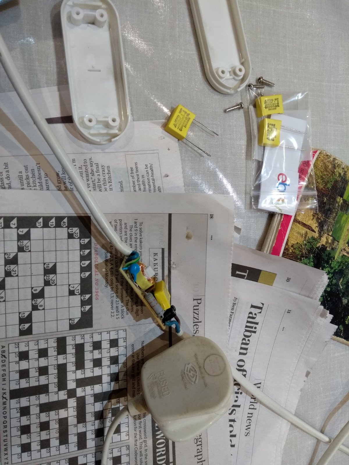

Not vintage radio, but it is electronics, and this seems to be the de facto topic! Got a touch control dimmer light which started switching itself on, duff capacitor thinks I, and indeed there's a 0.15pF cap that looks a bit black and some black soot in the case. New caps sourced, but my (40W) soldering iron is not man enough to get the old one off.
So, recommendations for a better one? How big does it need to be?

I bought an 80W iron kit with desoldering pump etc and it has handled everything I have thrown at it, which included some "Mush" joints on 10mm copper cable in my 9Kw shower.

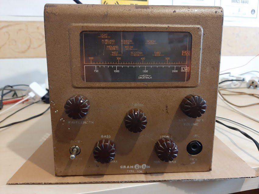

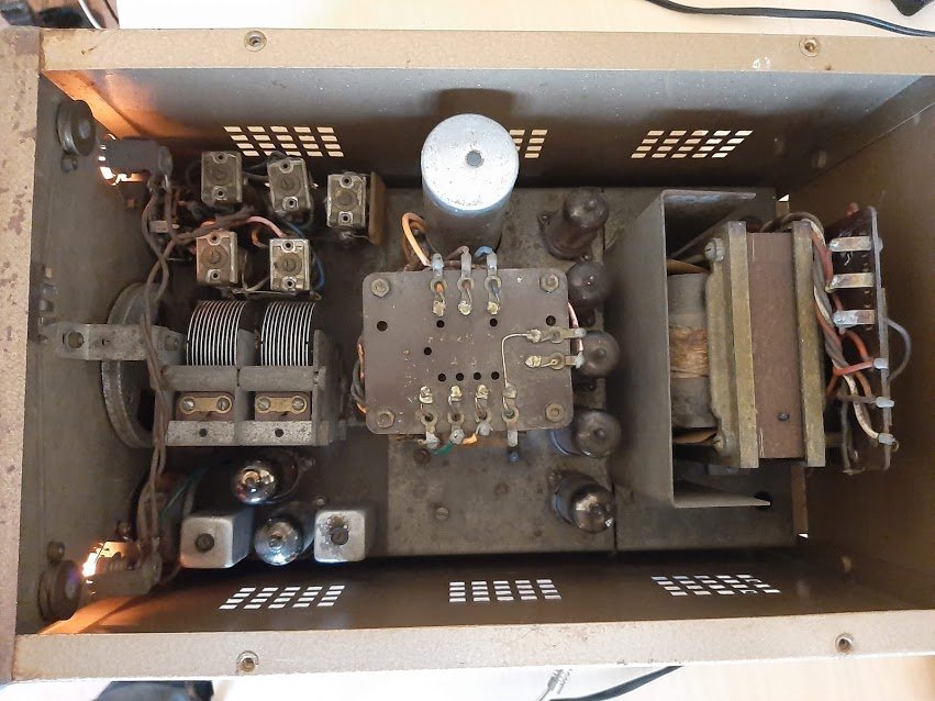

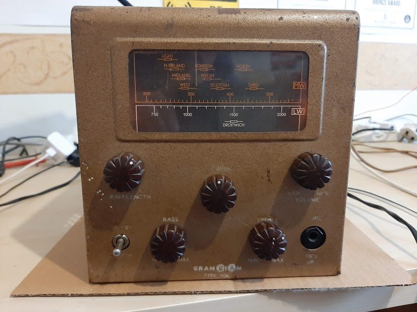

Yesterday I spent some time resurrecting this rather different one
Grampian were a famous Public Address equipment maker and this one would have been targeted at schools, institutions and maybe small factories... It has a hefty audio amplifier and is very loud and punchy... With bass and treble controls the audio quality is quite exceptional...
And speaking of capacitors Richard...

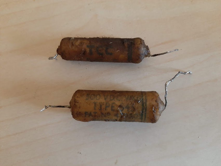

I needed to replace all remaining wax capacitors and do some rewiring as the radio section had been somewhat 'got at'
One odd problem was the local oscillator stopping at certain parts of the dial... This was all down to bent vanes on the tuning capacitor...
It is now in use in my conservatory and part of my virtual cycling kit..,. Connected to a decent sized speaker it's loud enough to be able to enjoy Radio 5 Live over the din generated by my turbo trainer

Re: Lockdown Vintage Audio Activities...
I remember them Jim, I thought for a minute you were going to fit it on your bike.
- Posts: 14266
- x 3278
As I said on your Instagram feed, that looks like a main line battle tank should be bolted to it!

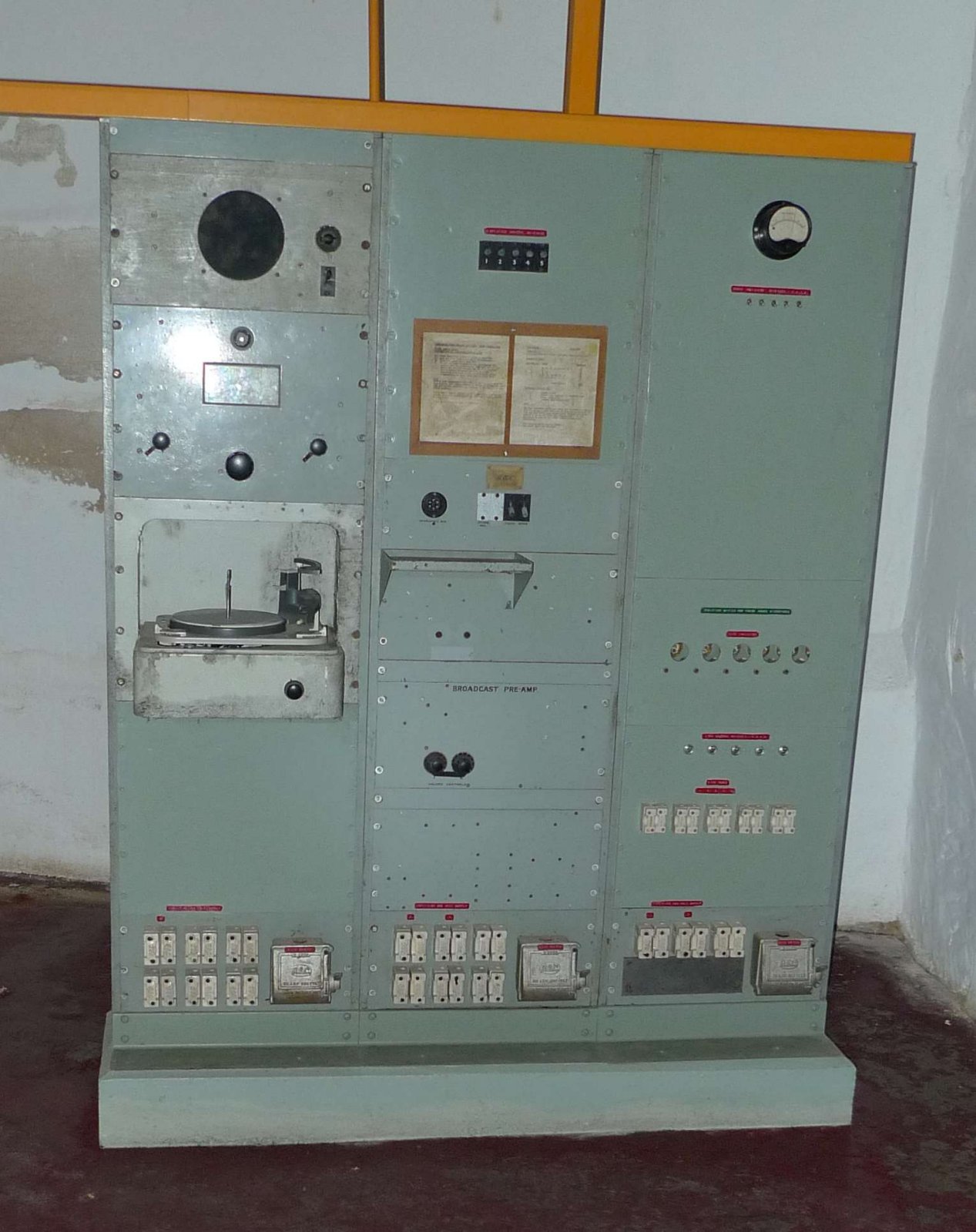

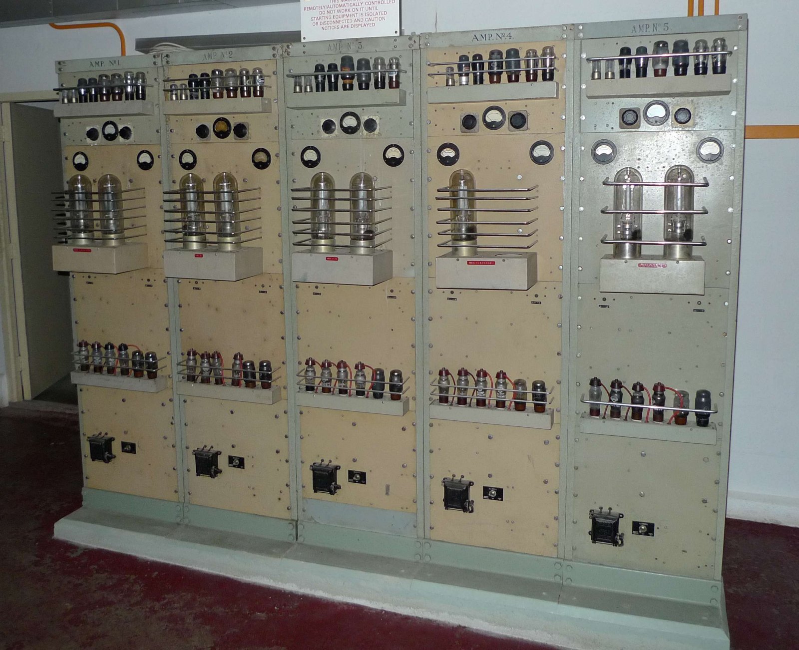

Bit of a monster PA system, this onePeter.N. wrote: 18 Jan 2021, 11:04 I used to maintain a system at a local paper mill, 'music while you work' was the usual light program output. It used a pre war Philips amplifier with wet electrolytic smoothing capacitors if I remember rightly. I eventually managed to sell them a new system just before the place was closed and demolished.
- Posts: 14266
- x 3278
Bl00dy hell; you and Mrs. Bobins are good at making decent kit!
