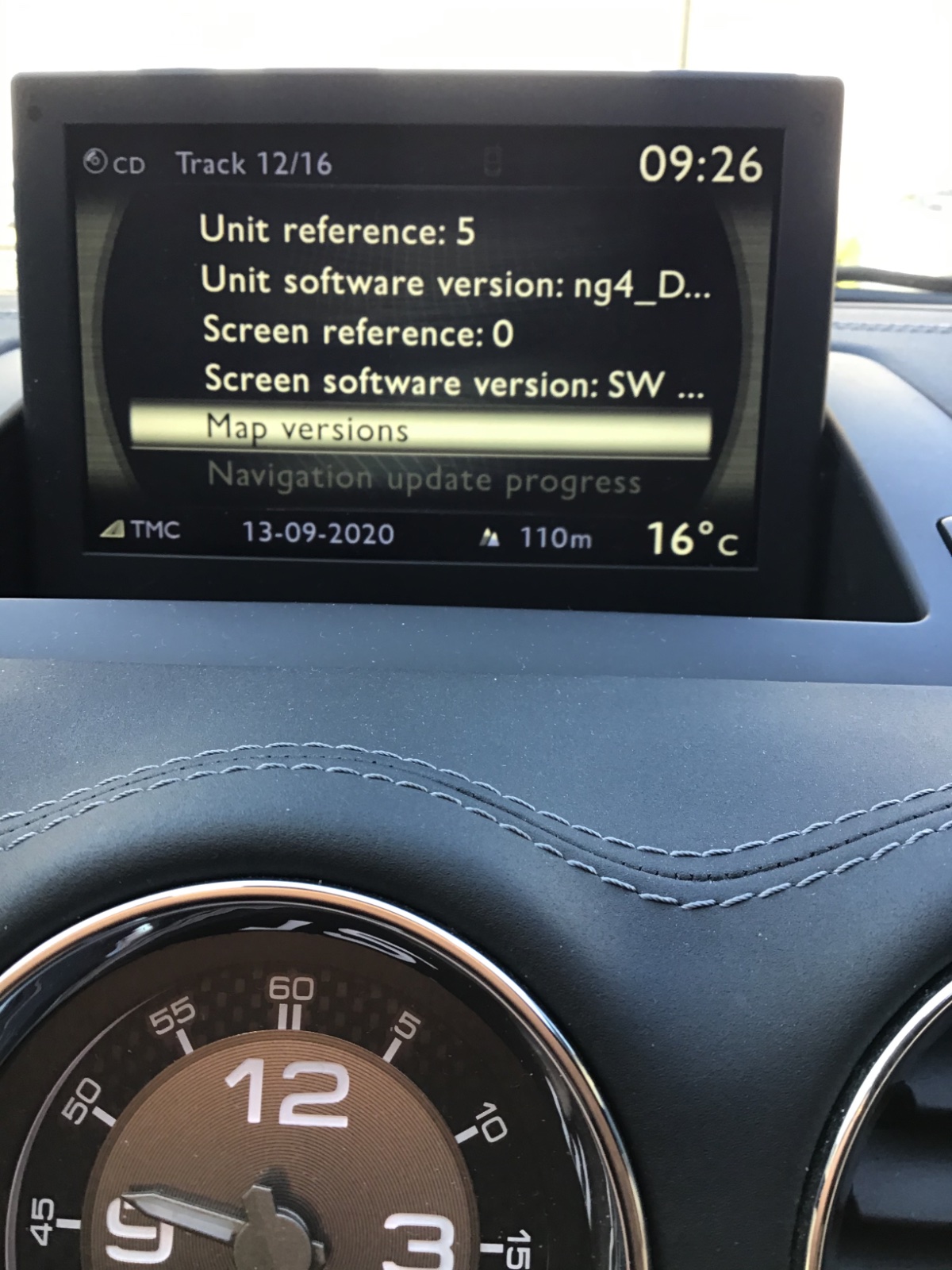

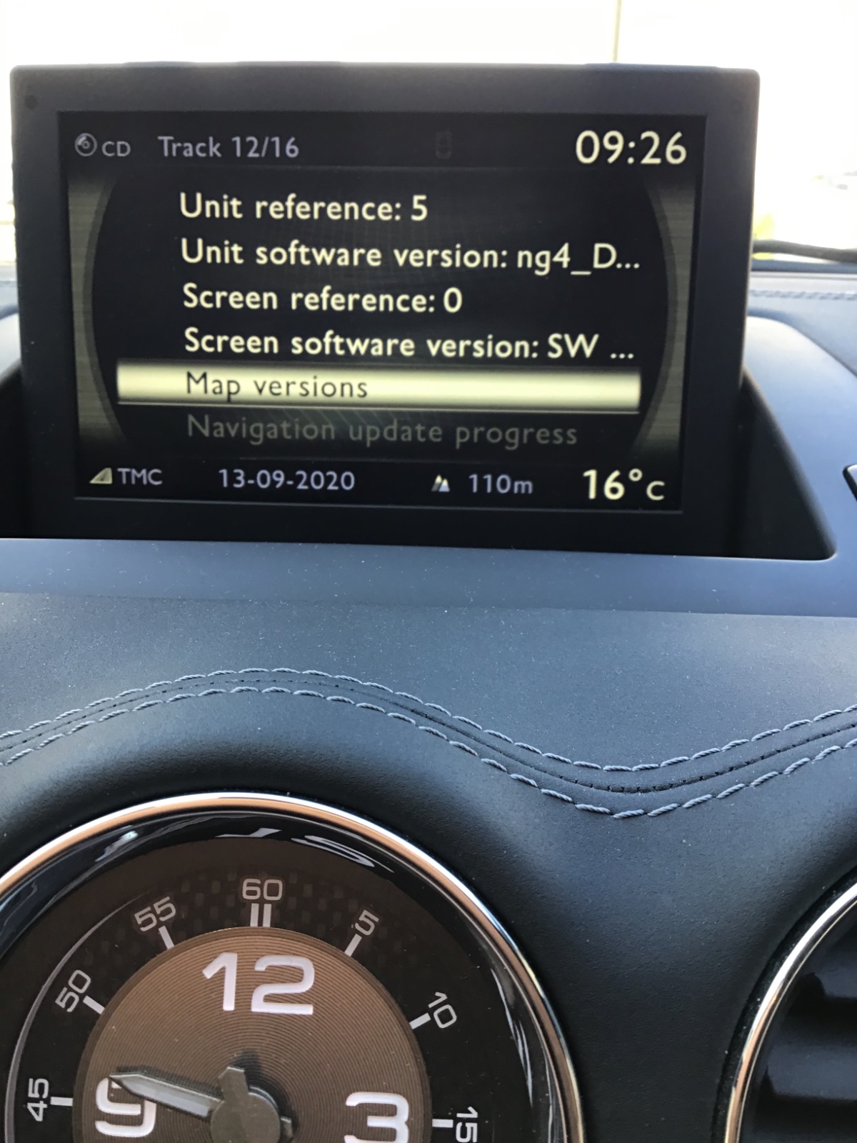

Ok, all of those show the same thing - the firmware version - which is good as you are on the latest firmware. Scroll down where it says Map versions, that will tell me the maps you have on.

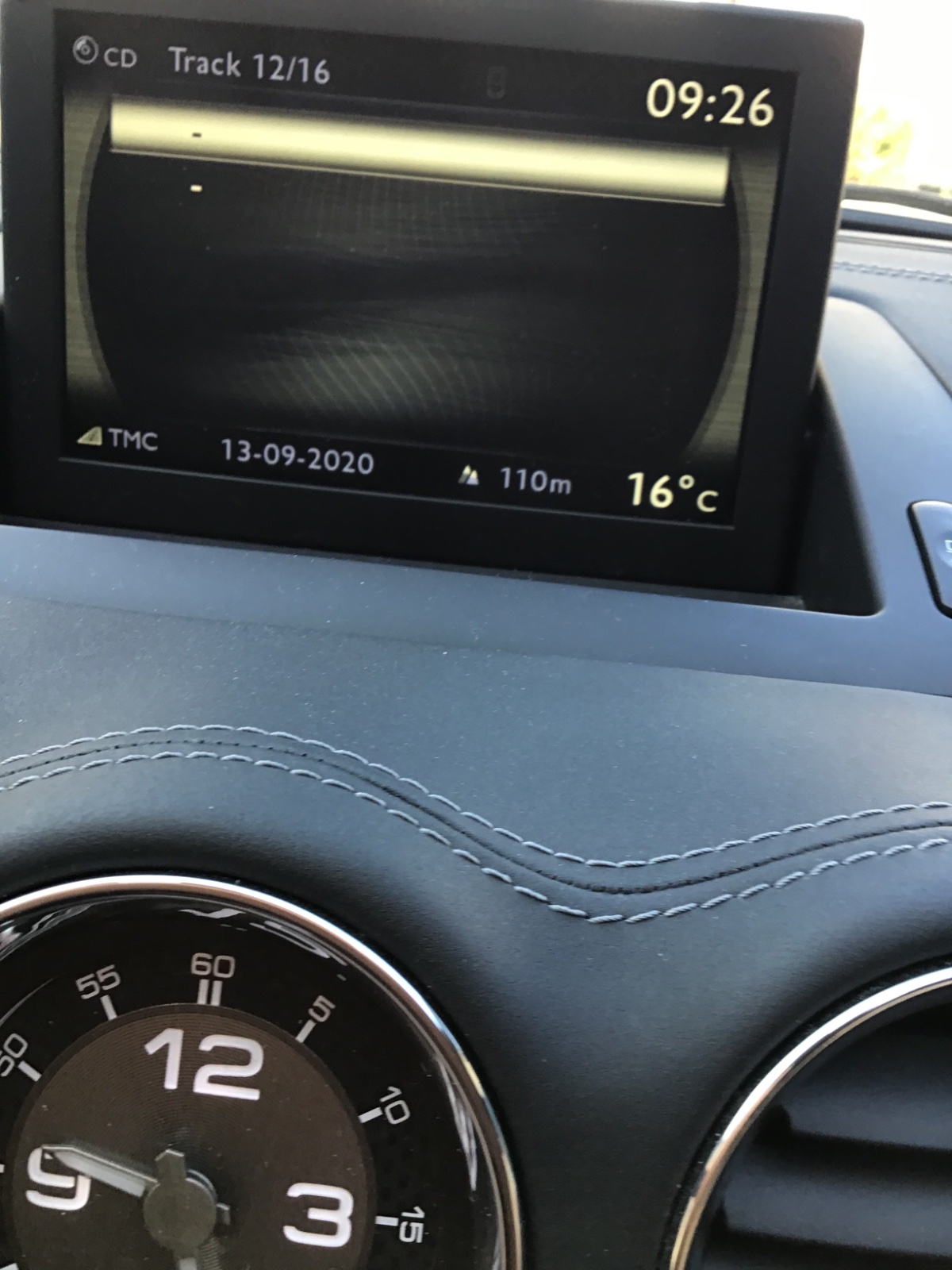

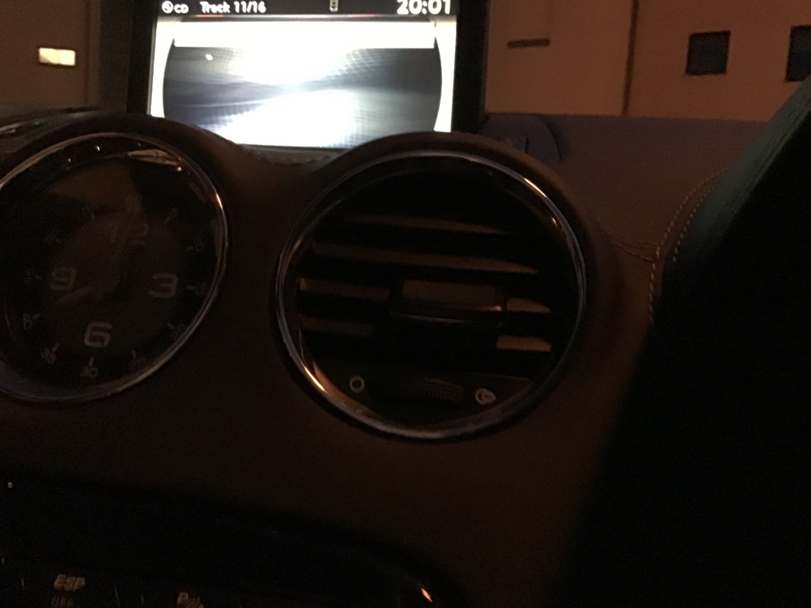

Hi mark I’ve taken pics but not very clear I scrolled down too maps when I click on that the is nothing listed if you can’t see pics I will retake in daylight

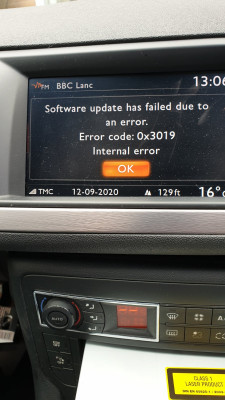

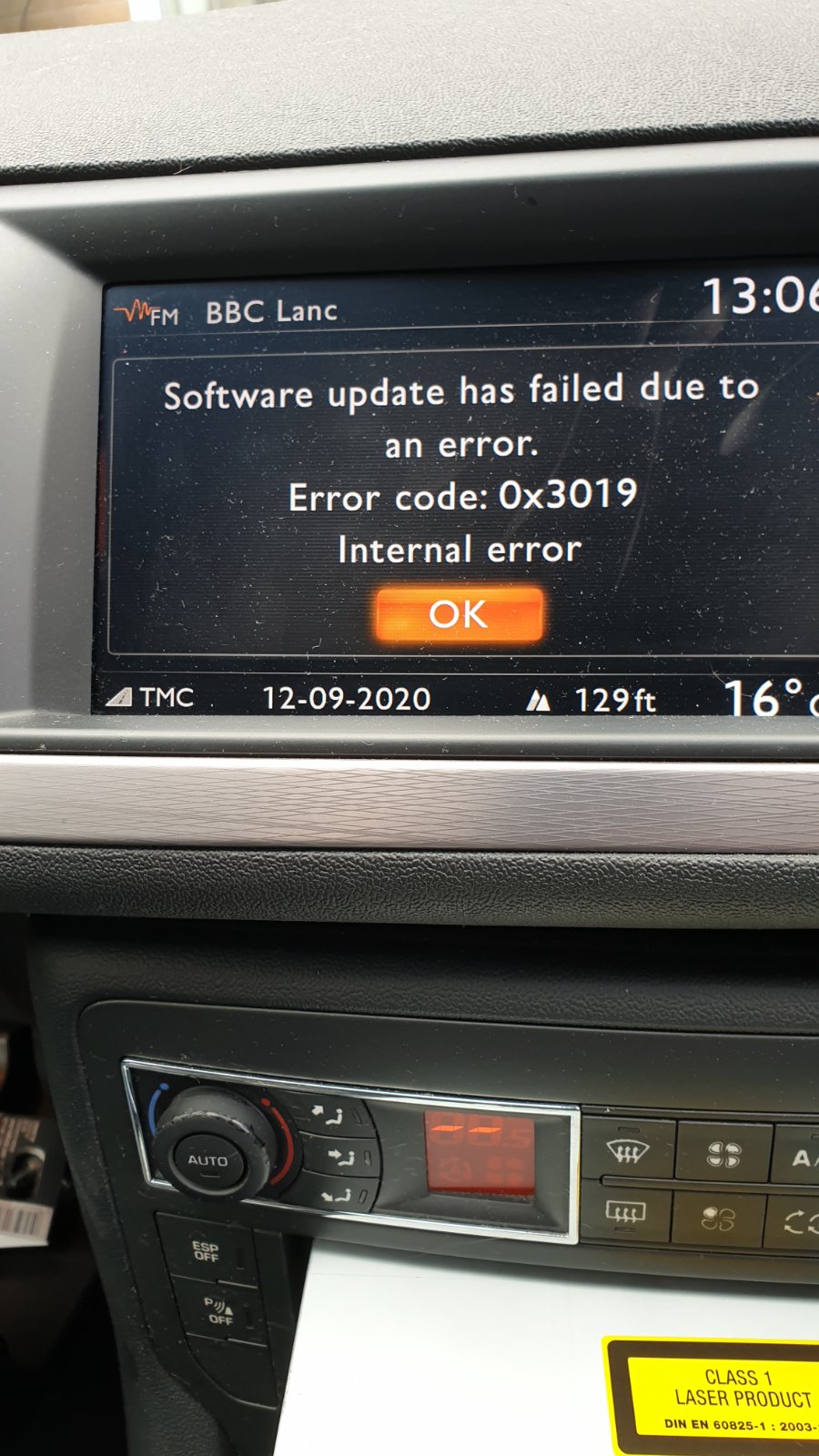

I am replacing the HDD with a CF as it is rebooting and it is getting more frequent.
After fitting the CF card which has been formatted to fat32 and is set at slave the system powers up and starts the software update.
It gets to 67 % and fails with an error code 0x3019 and reboots and try's again to install software but gets to 67% an same problem it looks like it is in a loop.
If when it has failed i remove the CF card and check it on pc no partitions have been made.
If the original HDD is replaced the system boots up as normal.

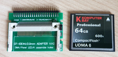

Also provide the exact model of the CF card too please (model number) as some of these may not be compatible if they are too fast.

Dave63 wrote: 12 Sep 2020, 20:10 Hi mark I’ve taken pics but not very clear I scrolled down too maps when I click on that the is nothing listed if you can’t see pics I will retake in daylight
Ok, I can't see anything on those pics - but use the scroll wheel to move onto the map version option and select - it should then provide the map details.

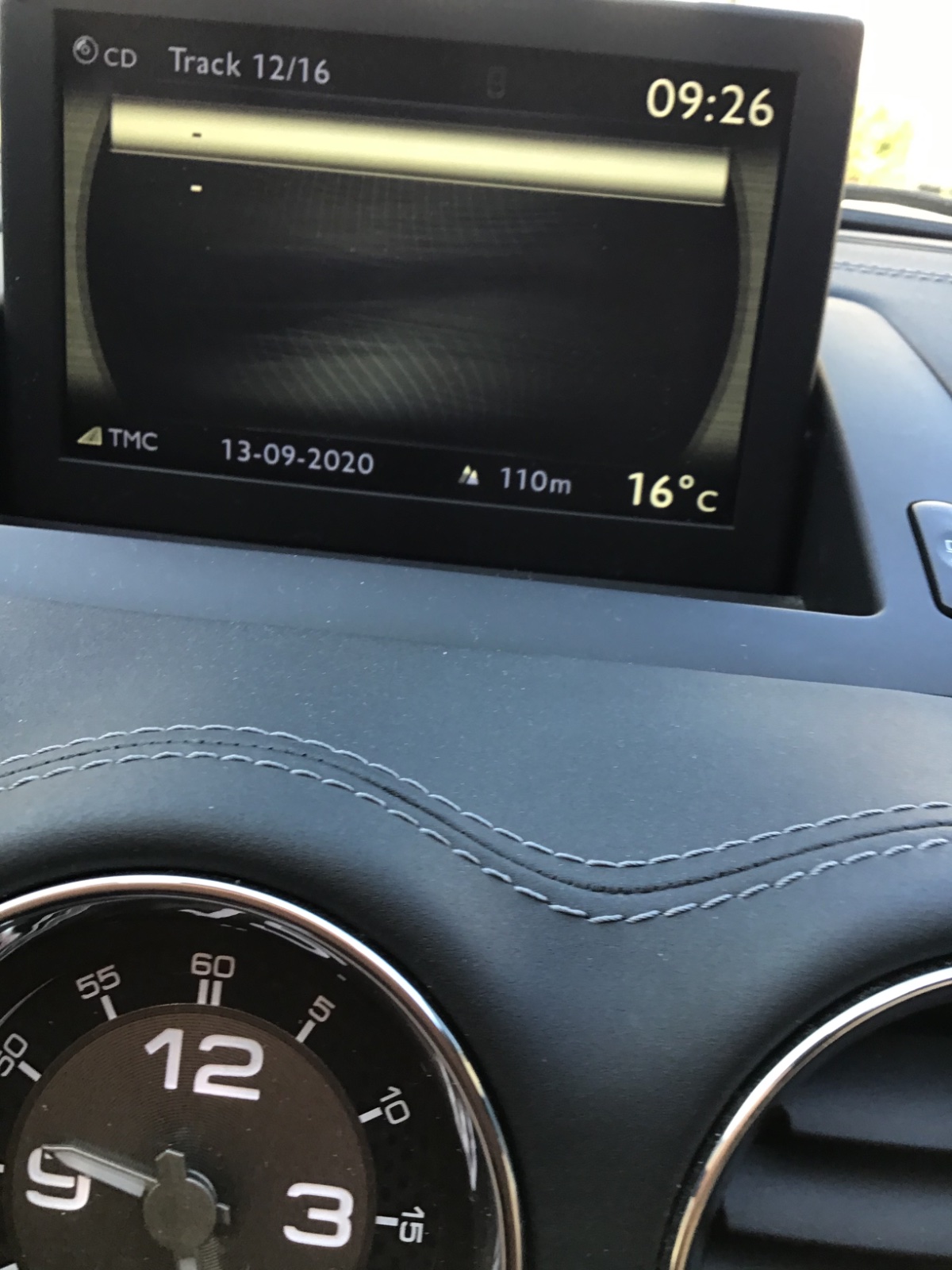

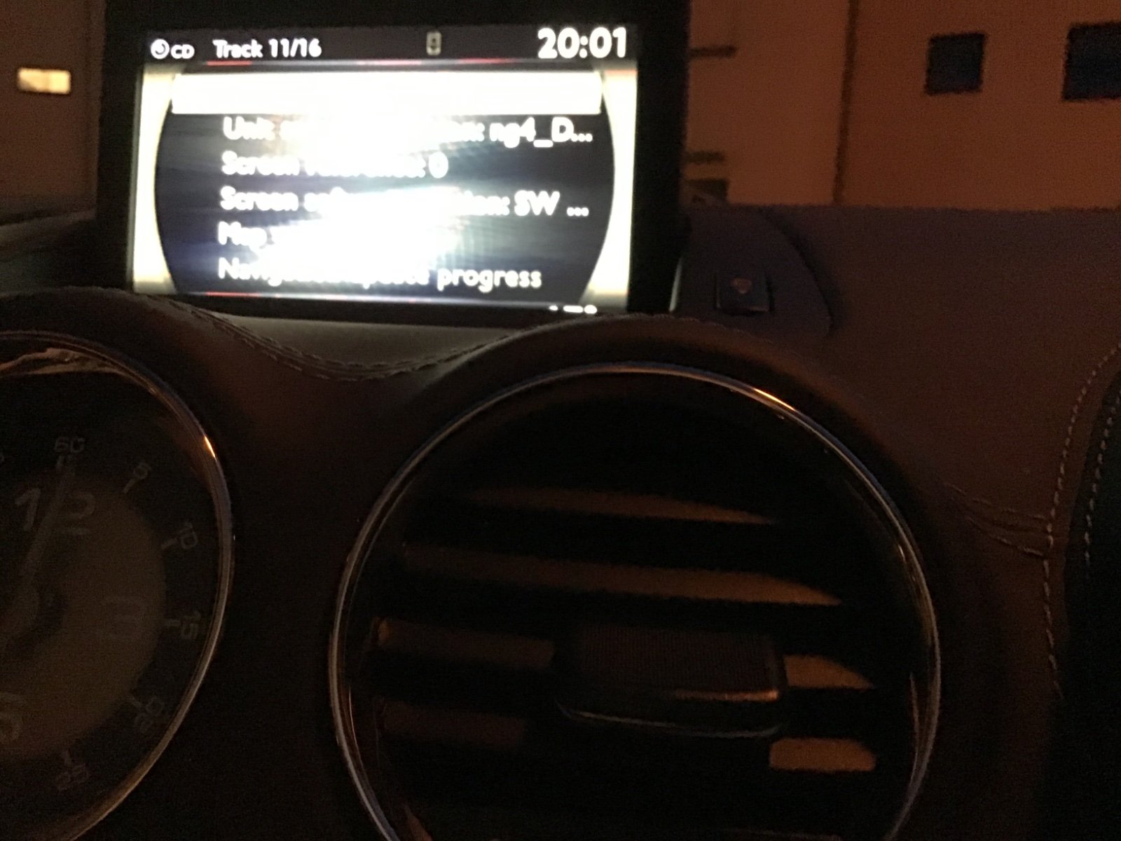

Hi mark taken new pic when I click on maps this all I can see

The CF card is the one recommended in the Guide
And this is the error message

Re: Guide to Replacing the NG4 Navidrive 3D Hard Drive with a CF Card
Dave63 wrote: 13 Sep 2020, 09:33 ImageImageHi mark taken new pic when I click on maps this all I can see
If you cannot get anything when you select Map Version, then that tells me the mapping software is corrupt or not installed properly, which is probably the issue.

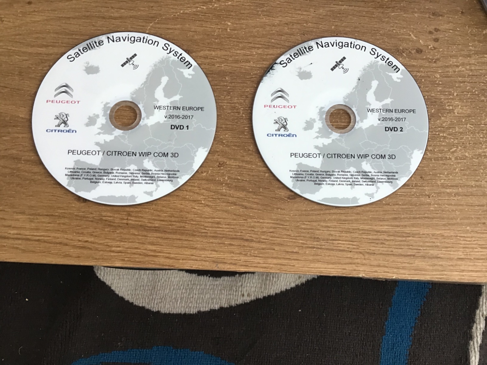

Where did you get the maps (CD?, Download? and where from?) Do you have a picture of the map software CD or the version details printed?
Dave63
Posts: 13
Joined: 12 Sep 2020, 12:49
Unread post by Dave63 »
Hi mark
Cd bought from satinav

x 6958
Dave63 wrote: 13 Sep 2020, 12:29 Can you advise next steps to cure problem many thanks
I wouldn't normally quote the previous posts, but as we have 2 current topics going on, thought it better to prevent confusion.
1) Those maps are obviously not official versions - they are cloned copies - so it is a distinct possibility that there may be errors in the copying process and this may be why the mapping software has not installed properly. Has it ever worked since you installed the maps? If not, get in touch with the seller and get a refund.
2) You may have a problem with the hard disk itself - but I suspect the first issue above may be the culprit.
