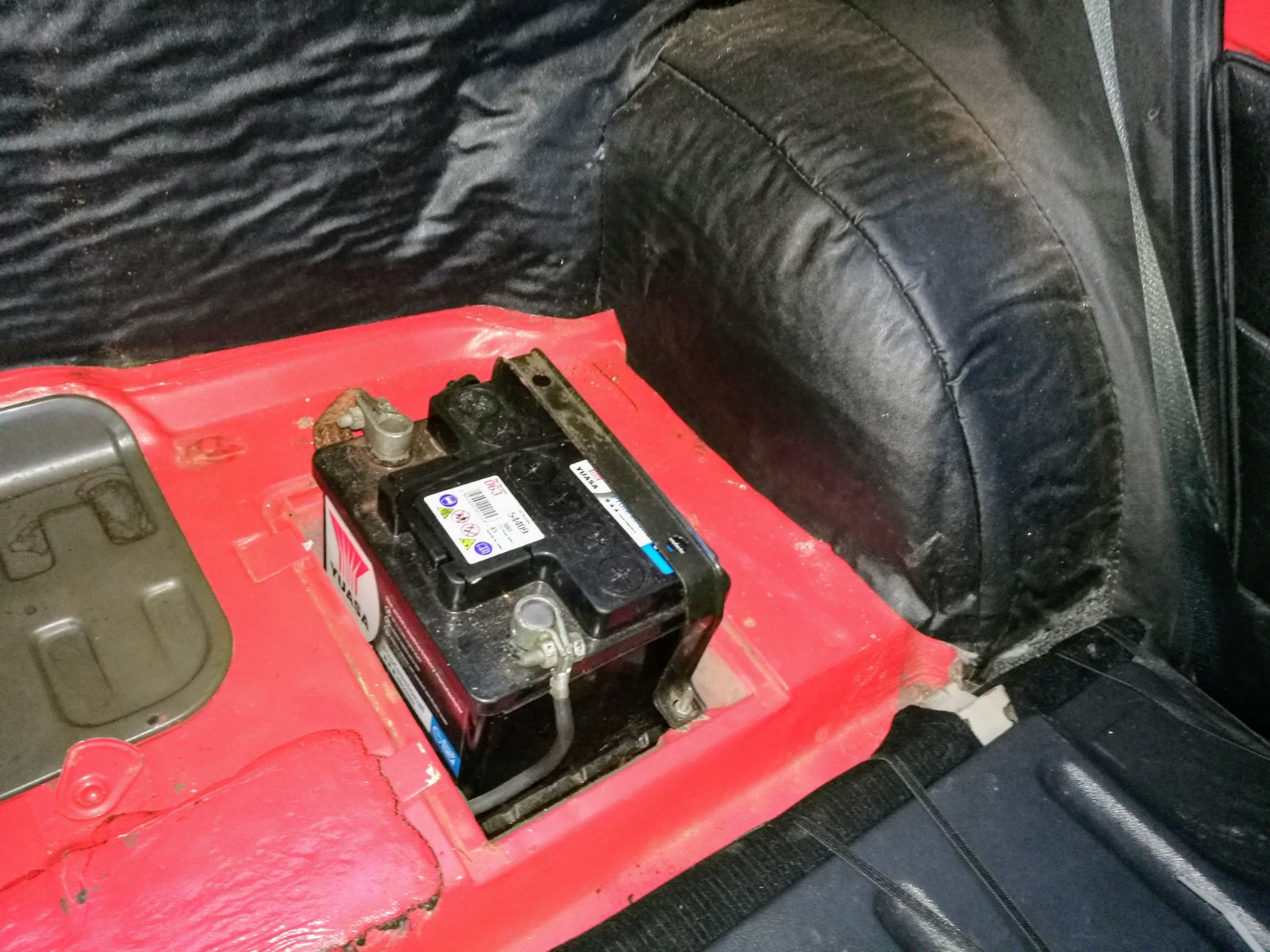

Re: Peugeot 308 CC - new tyres for a new southern summer
Here's the compartment it lives in - usually hidden under a plastic cover and with a thick sound deadening mat on the floor too.van ordinaire wrote: 14 Dec 2019, 01:37 You'd think a tyre shop would be able to fit a battery, as most of them sell them.
Anything with the battery UNDER the back seat would confuse most folk these days.
Loading VW T3 & 4 estates was also guaranteed to gain passing interest, if not a small crowd.
Could fit a decent amount of stuff back there too.
The little hatch in the floor gives access to the gearbox oil filler/level cap (you dip it using the engine oil dipstick to check the level) and clutch slave cylinder adjustment.

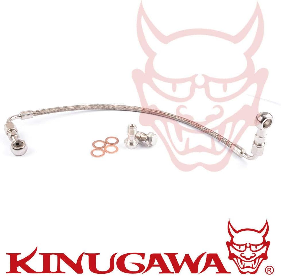

Here is a cutaway of the original fittings:
This is the replacement that I have ordered:
It would be only a bit irritating except for the 4 hours labour to change the part.
To make the design even better, the factory fitted a little heat shield, but instead of putting it between the turbo body and the pipe, they put it on the other side of the pipe, so that heat is reflected back onto it from what would have been the cool side.

The replacement you have ordered looks better engineered Mike...
Hopefully, once fitted, that'll be the end of your problems in this area...

The hose kit arrived and has been fitted. It is certainly no longer leaking at the top end, you can't see the bottom end (behind the catalytic converter heat shield), but there is no longer a smell of burning oil.
Tomorrow we are off for a short holiday in Invercargill and Queenstown, so a good run to test the oil-tightness.
