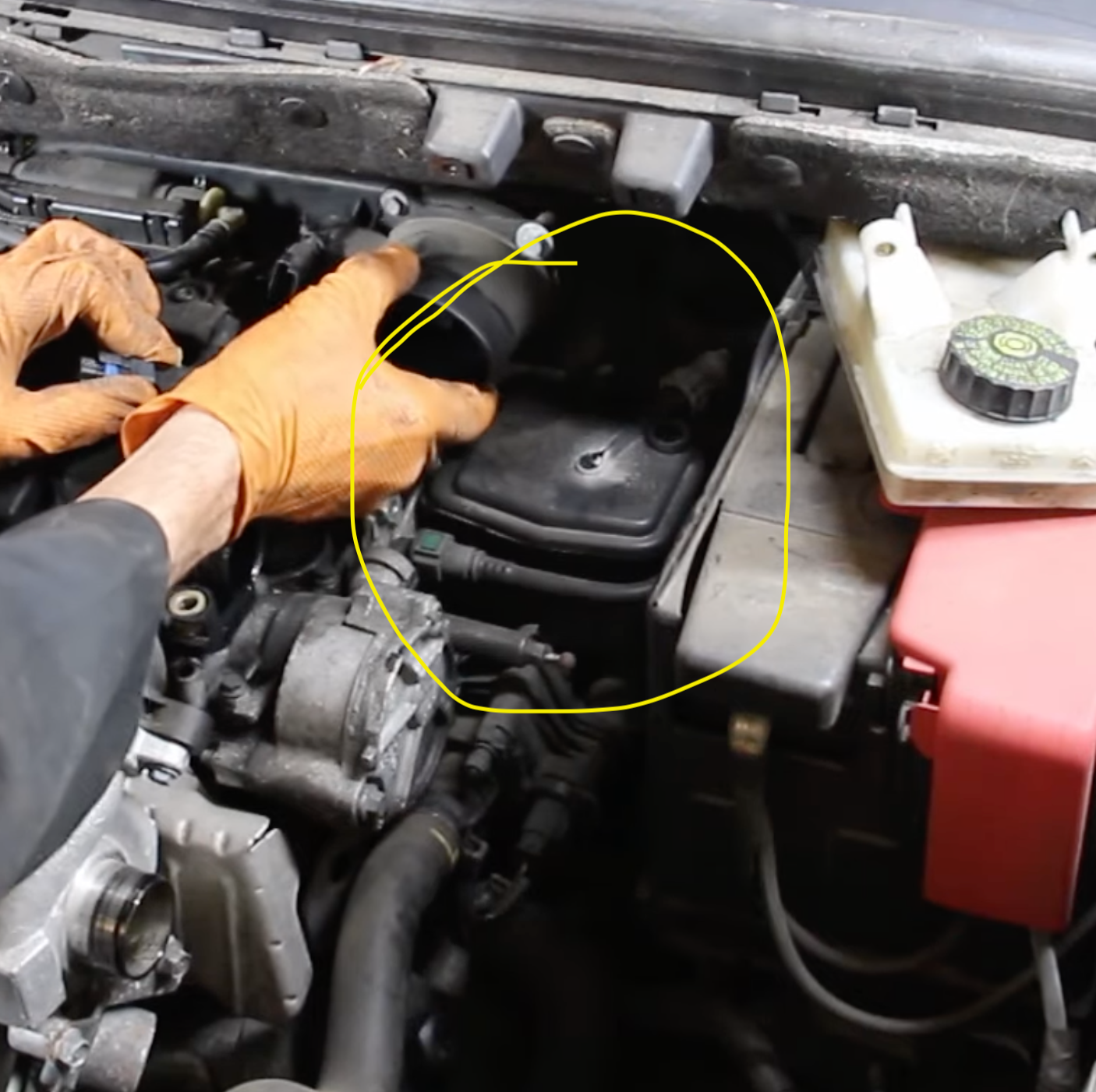

Question- what is the black plastic box? Circled in yellow in this screen grab from a video.
And does it need to come out?

Re: 1.6HDi not starting...
IThe black plastic box looks like the fuel filter, Some of the 1.6 diesels had them like that, there will be quick release fittings and then it slides oupwards from its locating slot.
Yes looks like the plastic box is a fuel filter.
I'm used to boat engines, this all looks very odd to me
Anyway I made some solid progress this afternoon. Finally got the battery tray right out (had to peel back the wheel arch liner and do the awkward bolt from that side. It won't be going back in!
Got the fuel filter jiggled out of the way. Didn't disconnect anything.
