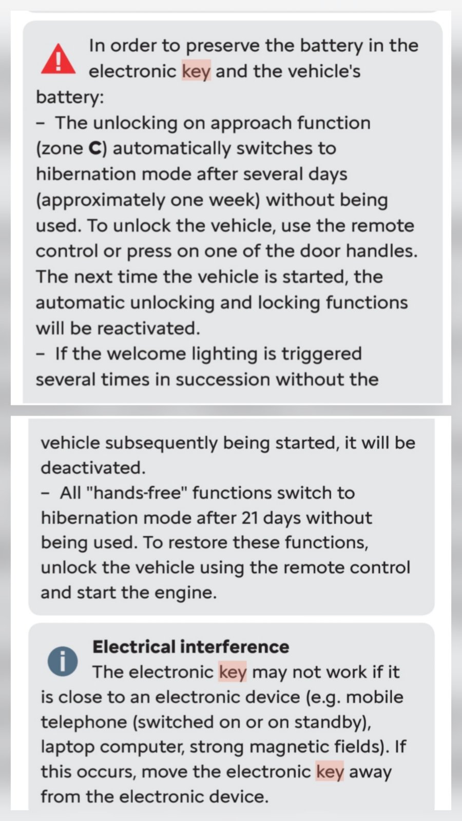

......you've just made me read the owners manual 😀 and found this in the locking section.
Not a section I would feel I would need to read.
Just thought I'd check my 'Spare' fob, and guess what, it doesn't work, so tomorrow I have to reinitialise the fob, may even have to replace the battery too.
So from the start of a small post I have found out something, and then had to do something else.......... :?

If it's gone yo deep sleep, >21 days it has to be reinitialised by holding it on to a sensor on the steering column and the car started.
And it works, carried out the procedure to day.
