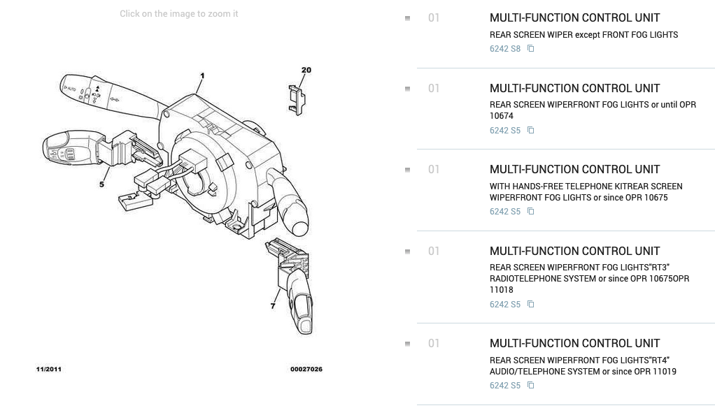

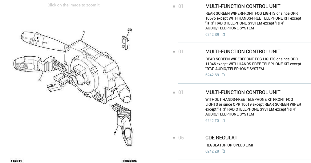

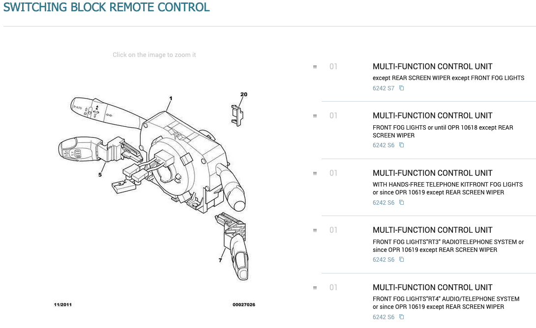

@Ross_K , i think that i can get away just with the stalker for the lights / indicators , at least if i can put com2000 back together
I'm already talking with some people that has that material for sale. Hope to have it in my hands pretty soon
