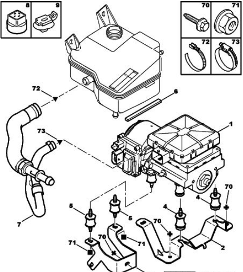

Item (1) BHI:
5277C9 (pre-configured) or
5277E0 (non-configured)
Both the above are for manual vehicles, NOT automatics.

With any luck (and a lot of twiddling) I may be able to just swap over the motor. It is only secured to the pump by three Torx bolts, and only has two simple cable connections (the complex connection is on the valve/pump section). I do not intend to swap the ECU, as the replacement is from a saloon car, with different ride characteristics/software.
If you look at item 1 in the diagram you may see that it is two items bolted together. The 'nearer' item with the box on top is the valve/pump side of things, while the 'further' item (below the shim and reservoir) is the motor.

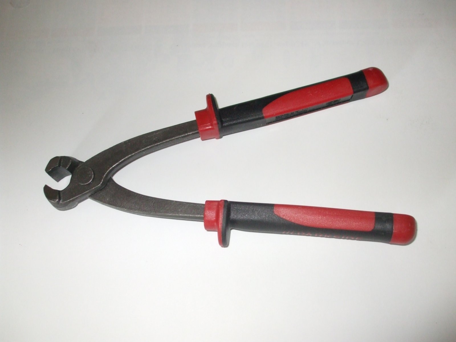

I believe it will be possible to replace the pump motor without having to take too much apart. However, it is very likely I will need to remove the LDS reservoir. There are three pipes that have the Citroen clips securing them in place. What tools do I need to open/close them? If they are not re-usable can I use Jubilee clips?

As you might expect James, there is a dedicated tool, the name of which escapes me.
Jim determined that although it wasn't the best tool, that carpenters pincers work to remove and refit them.
This thing below is similar but less chunky that pincers. Bought a couple of weeks ago in either Aldi or Lidl for not many quid.
No car at the minute and I don't know if it uses similar clips so can't test its usefulness.
