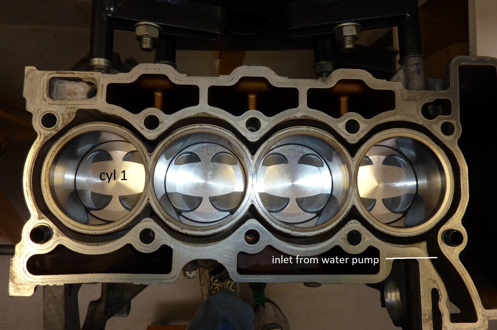

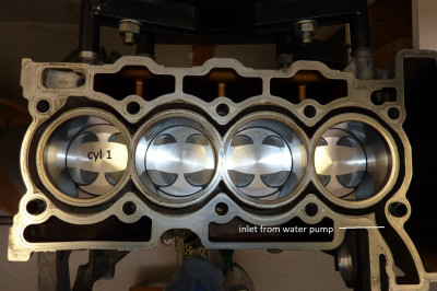

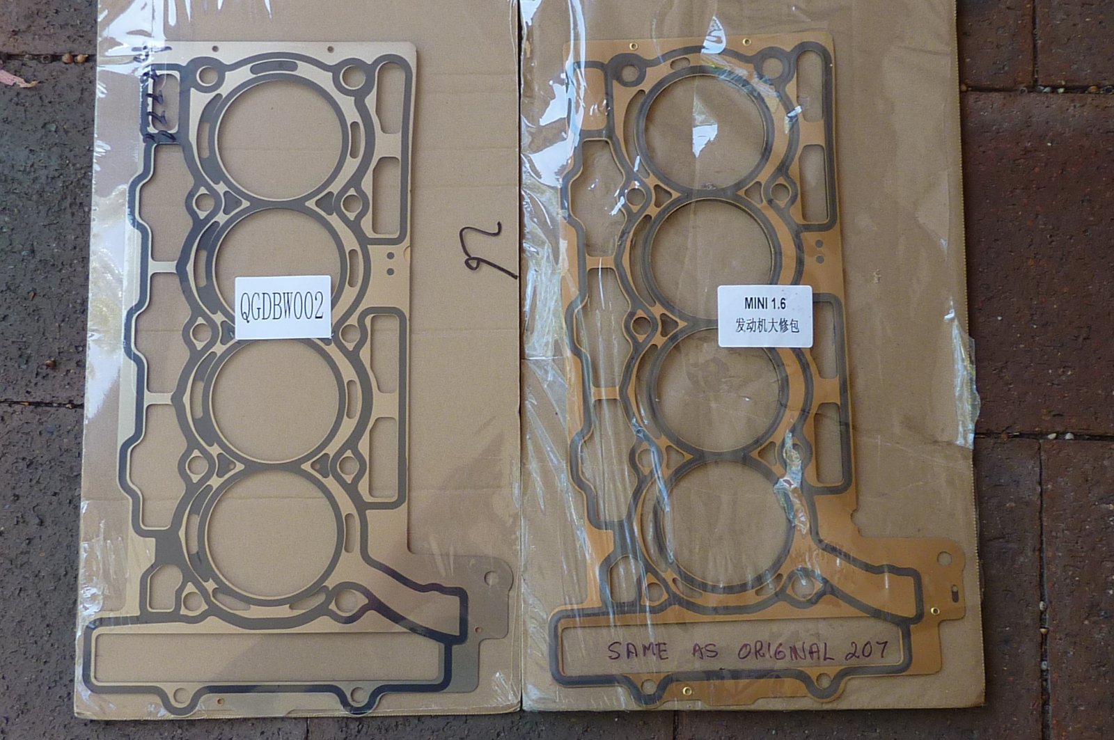

It was interesting that Marc showed that the oil pressure regime differs between the two engines, which I can only imagine involves a difference between the oil pumps in the two engine versions. I assume that your original engine ECU has expectations about what pressures it expects to see at certain revs and maybe it gets unhappy occasionally? Since the engine is running well I would be inclined to just monitor the situation over a few thousand miles.
I am also wondering if cylinder 1 (furthest from the water pump end) is more prone to problems because it runs hotter? In the block the coolant has to flow past all the other cylinders before it gets to the 'back' of the engine, and I can't see any design strategy to equalise the flow to all cylinders. I'm also curious that in the VTi engine the head gasket has openings on the exhaust side of the bores, but not on the inlet side, unlike the turbo engine.
