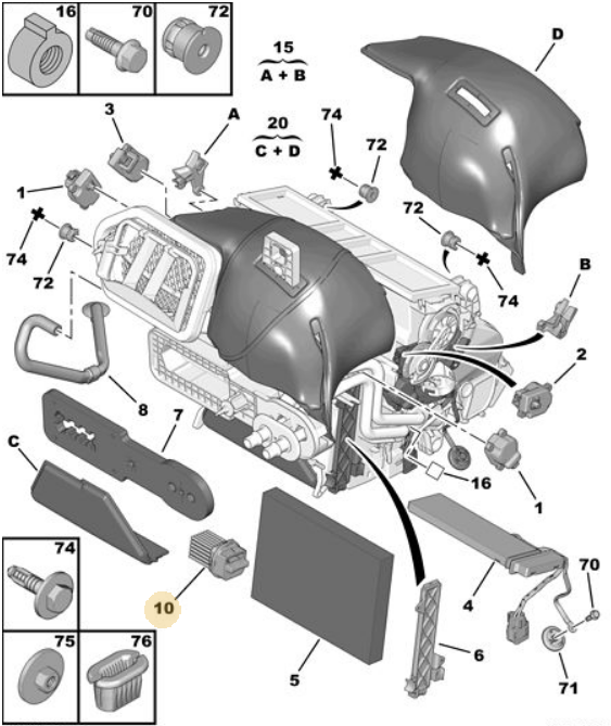

There are no relays you that you can access. The supply is managed by the supplies management (where Fuse 10 is) and the control and command functions are managed by the Air Conditioning ECU and the BSI.

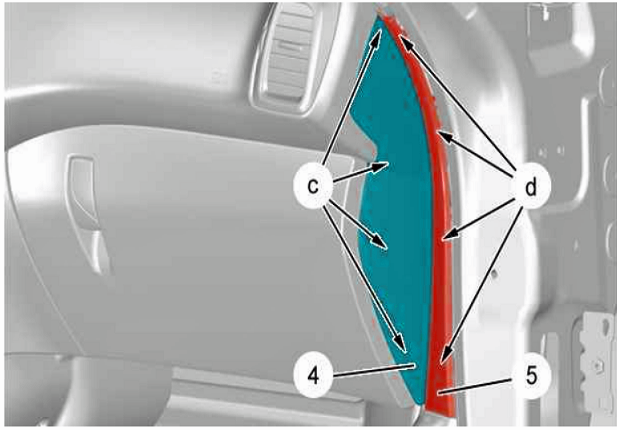

Here's how you get to the Blower Motor Control Unit:
You'll need to remove the glovebox trim first:

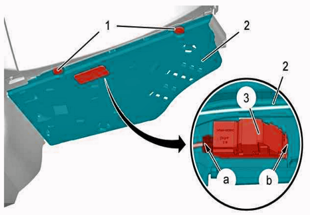

Remove the clips (1) using trim removal tools.
Disengage the trim (2) under the dashboard .
Detach the lamp (3) ( as "b") using trim tools.
Disconnect the connector ( as "a").
Remove:
  • The lamp (3)
  • The trim (2) under the fascia

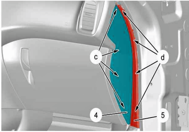

Unclip:
  • The dashboard side trim (4) ( as "c")
  • The front pillar trim (5) (Upper) ( as "d")
Remove:
  • The dashboard side trim (3)

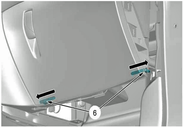

Detach: The pins (6) (Following the arrows).
Remove: The pins (6).

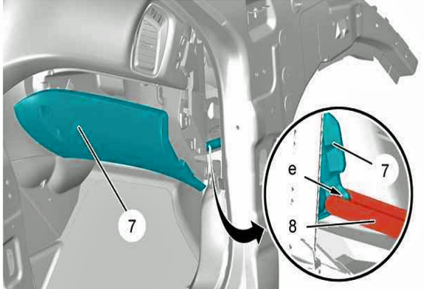

Open the glovebox (7).
Unclip strut (8) ( as "e") using trim tools.
Detach and remove the glove box lid (7).

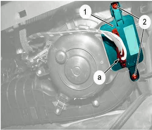

Remove:
  • The bolts (2)
  • The air blower control module (1)
Refitting
Refit:
  • The bolts (2)
Connect the connector (at "a"").
Refit the trim under the fascia.
Reconnect the battery.
Check the operation of the air blower.
