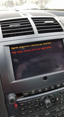

Hi
I ve updated the system from a new genuine 8.31 Peugeot CD....now the system does not function anymore. It asks for the Update CD and the process begins again
The error is : Error during flasher loading. The update was done with engine running ...no issues when it was in progress.
What do I have to do now ?!
It s a RT4 407 coupe , earlier version 7.01
- Posts: 42019
- x 6919
Re: Peugeot RT4/5 Update Problem
Whoops!
Ok, can you confirm if this is an ORIGINAL CD or a copy of the Dealer Firmware CD? It is my understanding that there is a security file that causes problems if making a copy of the original file - which will cause problems.
If you are 100% sure it is an original firmware CD, then you will probably find it is because of the problems between the major firmware updates and some incompatibility issues going from your version directly to 8.31. Many others go in smaller stages.
There is one possibility you can try - Carefully remove the unit. Make sure the upgrade CD is loaded. On the underneath of the unit, there should be 2 very small, white plastic switches hidden down one side of the casing. If you hold these in TOGETHER, with the CD loaded and the car running, it should go into 'Bootloader' Mode. This may work for you.
