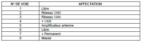

Input connector (8-way black)

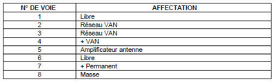

Connector outputs (white 8-way)

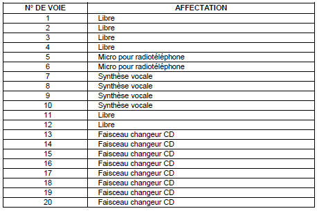

Connector interface compact discs 20 tracks
