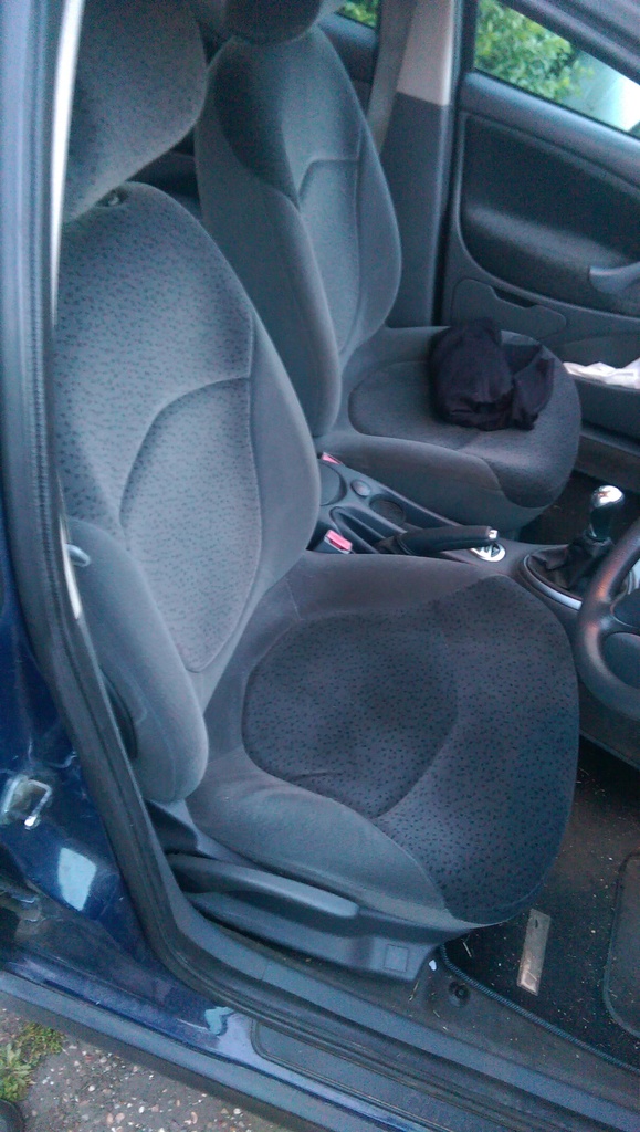

Front before;
Lifting the seat (passenger side) reveals the plastic loom guide and cover over the plugs for the seatbelt clip sensor/side airbags (plus obligatory Maccy D's chip
Under which are the connectors.
Blue is the connector ready for the electric seats, yellow is the airbag connector (which because I'm a rebel/lazy I just unplugged with the battery still connected but ignition off - I just couldn't face doing any BSI reset cobblers or potential ECU gremlins after).

Front before;

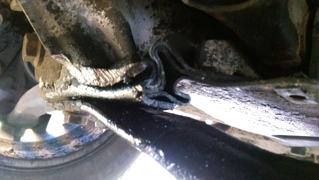

This is what I found when checking today in the daylight;
Cross-member bent down/back
Small scrape on the stiffener/skid bar
Passenger side sub-frame mount ok...
Same most definitely not true of the drivers side (the car would have hit with that part first);
As a comparison that it is not just 'superficial' type damage...
Passenger side;
Drivers side;
So, not well
Poor old girl.
Passenger side;
Drivers side;
So, not well
Poor old girl.
