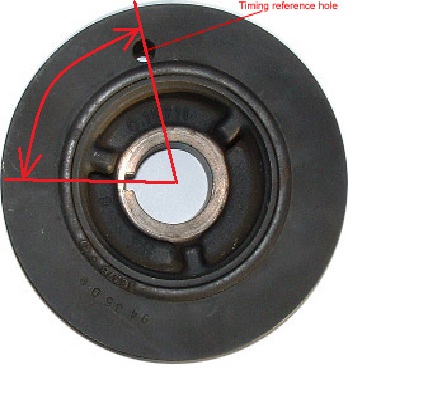

About to fit the timing belt and I have a question... I recently changed the damper pulley with a new (not original) one and I don't know if the timing hole in the pulley is positioned correctly. How do I do it without the pulley in place? Or if someone could tell me the angle between "pin" and hole...

Still trying to figure out how to time the camshaft without the damper pulley...
Anyone?

Well some progress in the research... I found this picture and it shows where to lock the flywheel. It's the same position as it should be on the crankshaft pulley. Yipikaye! 8-)
