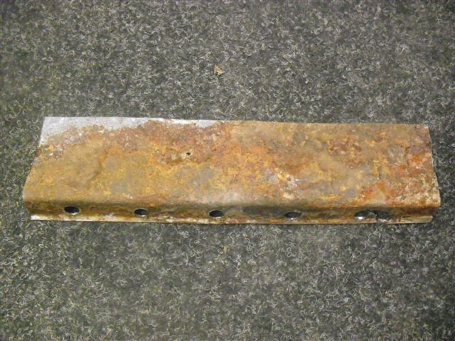

i just had another look at the picy's and it looks like the edge/lip/seam has been jacked on, as the bottom edge has been flattened,
this will cause/encourage rust to start as it breaks the under body/paint seal

CGATCX25GTITURBO
- Posts: 292
- Joined: 21 Nov 2010, 10:58
- x 15
Re: Xsara Picasso rusty corroded sills anti corrosion boast
well, this is what's going on inside the sills. Definately inside out rust, and been going on for a while.

It's being repaired at the main agents that painted my CX, the repair should be a good one, I'm not ready for blacked up sills yet. At least I know the car rather than buying another.
