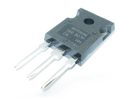

Closest match on RS-Components = http://uk.rs-online.com/web/p/mosfet/4857894/" onclick="window.open(this.href);return false;

IRFP064N

Thanks Clogzz. Have managed to place an order with RS-Components near where I live. Should be able to pick it up tomorrow, resolder and give it a go

And a thanks to Clogzz for putting me in touch with the IRFP064N which I picked up for pennies from an RS-Components store. I ignored you the first time mate (couldn't see the wood for the trees) but took you up on your second reference and you were spot on
So that's £70 saved (Citroen cost, or £60 eBay), another bit of knowledge to add to my increasing repertoire
and done just in the nick of time as the frost hits us all tomorrow for the first in the season. Today was bad enough - freezing this morning, and I had to keep wiping the windscreen down. Now we're all toasty again with no fogging misty windows.
I think I might get another couple of these power transistors just in case.

24 hours on and one frosty morning later and all's well. If anyone does do this, just one tip: the centre pin of the IRFP064N, being thicker at the component end, is a bit more stubborn to remove AND replace than the outer two. Perhaps it was my soldering iron being slightly underpowered and meant for more delicate electronics, but the majority of time was spent desoldering around the centre pin as I couldn't get the entire area fluid in one go. The other two pins went in and out like a dream, but the centre pin needed some coaxing and I did worry that the continual heating and re-heating around that pin might do some internal damage. However, I reckon the heatsink and thermal paste/glue does a good job at dispersing any heat away from the component even when soldering.

UPDATE :- Without trying to tempt fate <touches wood and references a plethora of other would-be superstitious omens and good luck charms>, this fix has thus far helped me through the worst of this winter (can it get any worse?) and held up well. Worth the time and energy to do - and not much more bluster than would be expended in getting 70-odd quid out of your wallet and chucking it at Citroen!!!!!!!!
Just remember - the solder connection in view of the large heat sink is meaty, so a commensurately large soldering iron would make matters easier than my light duty effort.

Lovely, another neat little job that Citroen hadn’t meant us to do.
Soldering transistors has kept me off the streets for a lifetime.
I use a 60W iron with a largish spade-shaped bit.
It’s heat transfer and sinking capacity, rather than temperature only that flows the solder.
Where there are large heat sinks, I put a piece of paper between the transistor and the sink, then screw it down loosely to properly locate it before soldering.
To unsolder, I twist the transistor off the sink with the mounting screw in the hole.

If the thermal capacity of the device / heatsink causes desoldering problems, it's often easier to clip the legs off, then desolder them.
