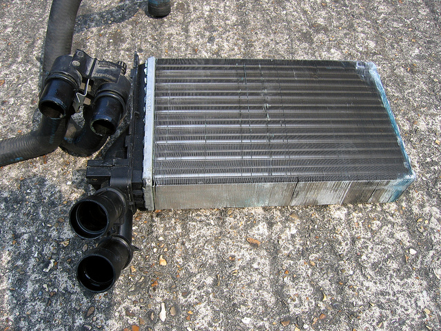

A sight to strike fear into any Xantia owner
this is the matrix and elbow connection when I changed the matrix in what is now Jim's Activa. Whilst these is white powder collecting at the bottom of the matrix it was leaking at the crimp joint between the plastic top and matrix, this has been the case on all of the three Xantia's of mine where I've needed to change the matrix.

My TD's matrix failed exactly as DickieG's did, at the top crimp joint between plastic top and matrix. No problem removing the elbow.
This happened when car 9 years old, so may not be long before has to be done again? And by then, memory so addled that I'll not remember how I did it first time

I've noticed all matrixes I've changed appear to be wet around the crimp joint but I've assumed, perhaps wrongly, that's just where leakage from the flange has collected and settled... I confess I've not probed deeper into it so maybe it's not just the flange O rings that go then...
One thing Xac and I noticed on the flange is a channel that's cut into it that provides a perfect leakage path when the O rings fail. Thinking on I do wonder if that's some kind of relief channel to protect the main matrix from going pop under excess pressure; a kind of safety valve...
