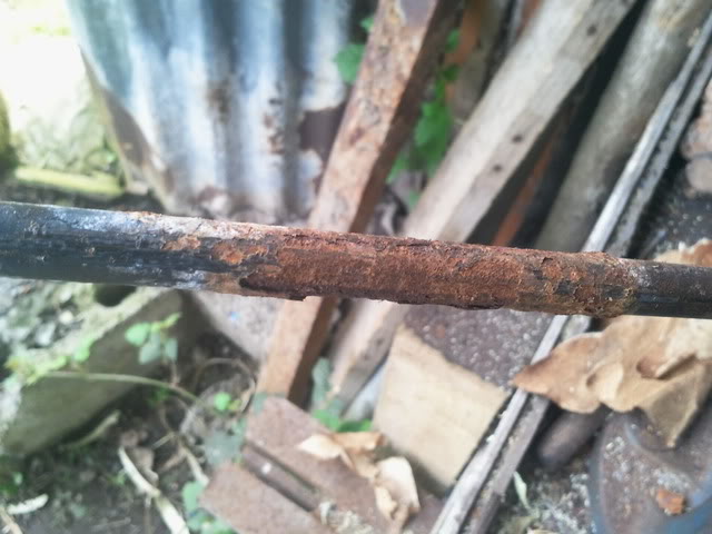

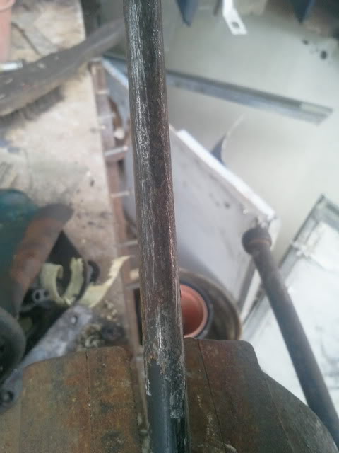

Managed to get the rusty Strut feed pipes off the car on both sides.. The Drivers one was not so bad.. had to disconnect the harness plugs on the inner wing, and unbolt the washer bottle filler neck.
The P Clips though 3 came undone 10mm nut, one didn't, so I had to cut the clip on the top of the P bit.. the rest of them no problem..
As for the passenger one, some may know that one runs along the front of the battery tray, then up the side of it, then UNDER all the main loom wires from the fuse box and up to the strut, it also has the two smaller Valve block feed pipes with it... so, off with the battery tray.. AH theres the Gearbox ECU under the battery.. and dismantle the Fuse box wiring... to loosen things up. It ended up not as bad as it looks to remove it, once wiggle jiggle the end under the wires and out she comes...

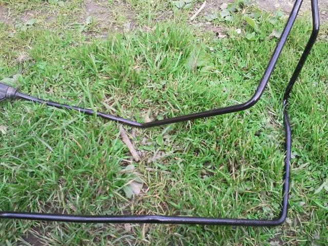

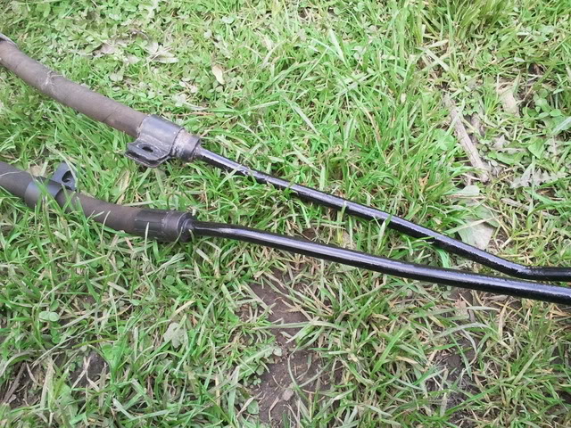

So heres a close up of them off the car...
However, after having them in the Vice, and useing an old HackSaw blade and emery cloth, the pipes actually came up amazingly well!!
They both came up roughly like this one:
So really pleased with that result as they were still thick enough and pleanty of life in them... so after a good rubbing down, I them got them painted black (As they were black coated orginially) they now both look NEW ready to go on..

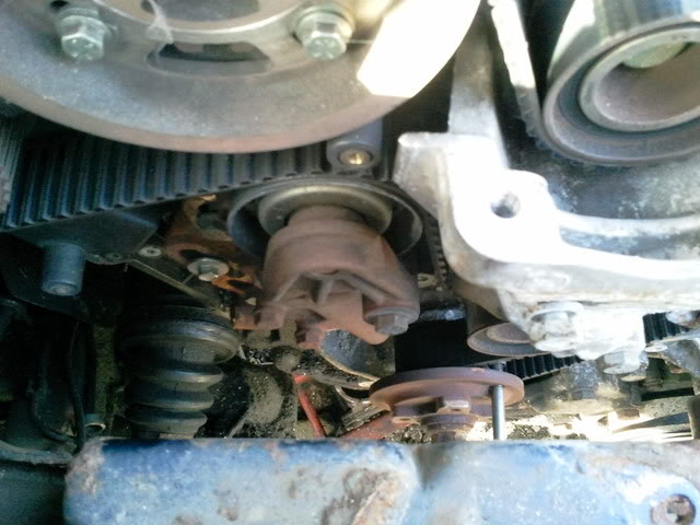

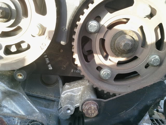

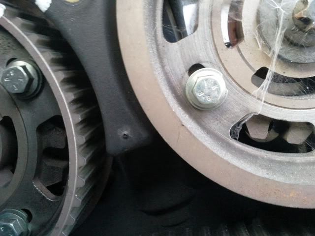

The next challange was Cam belt off...
Again, another easy thing, Im really impressed with the fact the centre bolt does NOT need removing to get the pully off... I undid the 4 nuts removed the pully, of course then removed the top engine mount, and removed the covers, and totally amazed to see they ALL lockup with pins!!
YAY...
So 8mm bolts all in there to lock them up, and one in the crank too.. this is mice and easy...
Now then, how do you... um remove that tensioner..
I slackend all 4 10mm nuts, to find the piston tensioned the thing up, so I screwed a nut in, and slacked it off and slipped the belt off..
To this:

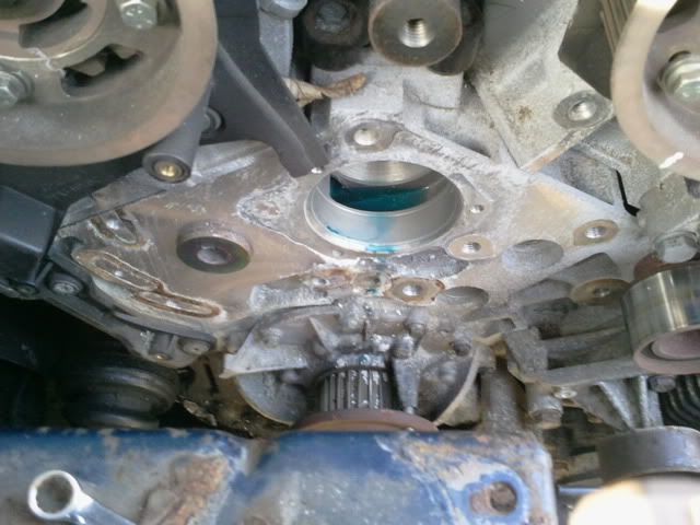

The belt was a recent one, the writing was ok on it, however, the water pump was the original, it had PR on it and 97.. and signs of leakage.. I did wonder were the water was going when I was useing her...
Right here:
I then also removed the HP Pump, it has a bad sign of leakage on it.. so Im thinking she needs a seal in the useual place.
YAY...

Pleased the pipes cleaned up well. Yes, they are thicker than they look...
