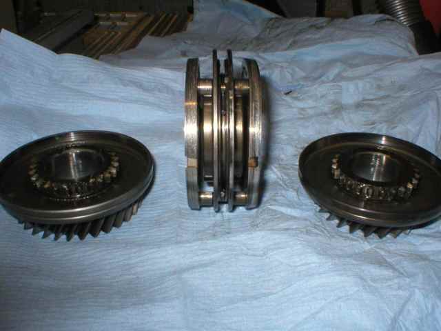

Here's the shaft I'm hoping to swap, they look identical (donner on the top, mine at the bottom):
I'm confused about the synchro hub. Thye both look the same. How do I tell a worn one from a good one?

Now, to tell if the hubs are worn. Ideally you need the hubs apart. Look firstly at the bit (the hub) in the centre of the picture below and look for the surface of the soft alloy being really shiny and possibly warped. On a good hub it should be possible to make out radial lines on the surface.
The second test is to check the mesh of the hub cone into the corresponding pinion. It should not push fully home and should grip the pinion very strongly. If it goes right in below the outer surface and does not effectively grip, it is well worn.
In use, the hub cone is pushed into the pinion to spin it up to speed so the dogs can engage easily. If the cone is so worn that it cannot effectively spin up the pinion before the dogs engage, you will hear a crunch.
You may also see "blueing" on the pinion where the hub has been slipping badly, leading to overheating.
Check too the "C" spring around the hub. this sometinmes breaks and results in a crunch.
The hub in the picture above is worn and your lower one looks worn to me.

I'm sorry Ally, I missed your pictures a couple of posts up
Now, looking at the top one, Look to the left of your red arrow to the tapered part that disappears inside the pinion plate. You can see some radial lines on the surface and this is an indication that side is unworn. However the opposite side looks smoother and shinier.
Can you get a photo of the right-nad tapered part. It needs to be in sharp focus...

I thought I'd replied. Adam, you are correct!
Yes, if you look at the second and third pictures, you can see the radial lines on the soft alloy hubs and this usually indicates they are unworn but the acid test is how far they go inside the pinion cups. If they go right in but don't grip well then they will work poorly. They should, even when pushed hard in, have a tiny bit of the taper face still visible. Compare with the fifth gear assembly, which should be unworn.
A bad hub will be shiny smooth on the face and maybe warped too.
This is the full guide to checking a BE gearbox from an old 205 BoL. It is based on the BE1 but this is the same 'box apart from the lift-up reverse by first gear.
It is a big file and will take a couple of years to download on my slow link but it covers well the preload check and so on. You may find it useful but be patient!
