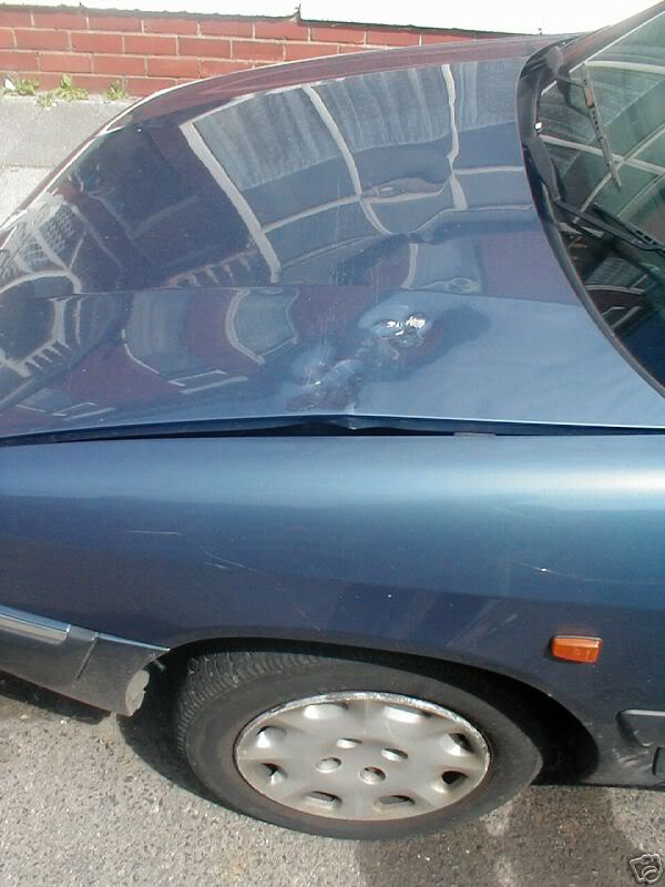

Well, I did say there'd be more seen soon...
1994 CITROEN XANTIA SX TD BLUE Spares Or Repair ebay item number: 4651992643
"In the ten months we have had to replace the front suspension struts due to the last ones corroding
This bent the bonnet slightly but thats all we have had to replace"
Hohum :?
