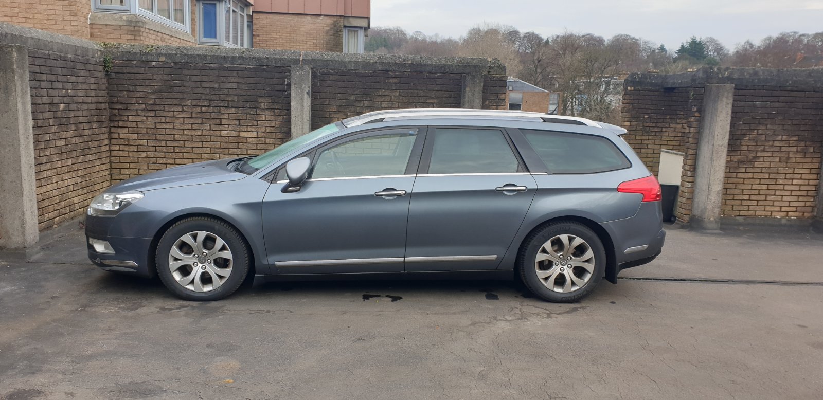

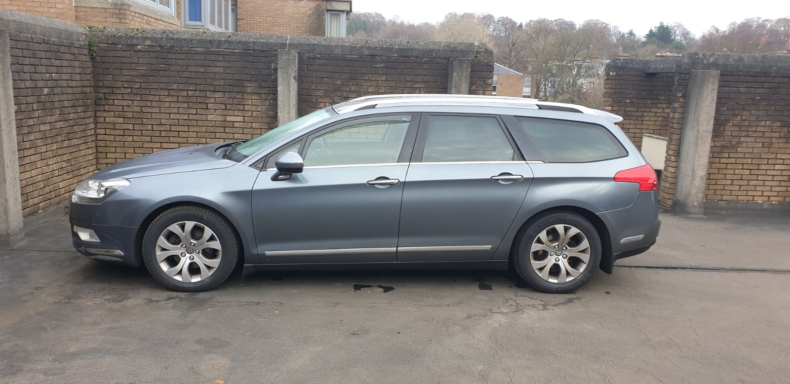

Here's a picture of the beast. This is how it appears after an overnight rest- the front suspension height is lower and when I open the locking it always raises up a bit before even getting in. Does this appear very low to anyone? It seems to ride fine.
1.
1.
After unlocking:
2.
2.
It appears barely any higher but it certainly does raise upon unlocking
