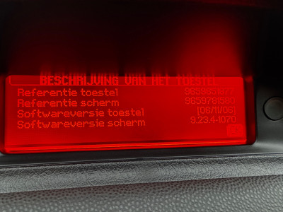

Hello again heres a screen shot

@Sandking: Very important, as you have a VAN version of the system and this requires a specific firmware, so link below:
RT3 552-773.rar
You will need to use 7-Zip (make sure you have the latest version) or other utility to extracr the RAR file and create an ISO file that needs burning to a CD-R and finalising before you can use it.
1) Do not burn at more than 4X Burn Speed as this can cause file corruption.
2) Be aware that Windows may not burn the image properly - suggest using Daemon Tools, Nero or another utility.
3) Use a CD-R and finalise the Disc afterwards.
Once you have the CD, when changing the language it will ask you to insert the CD you have just made.

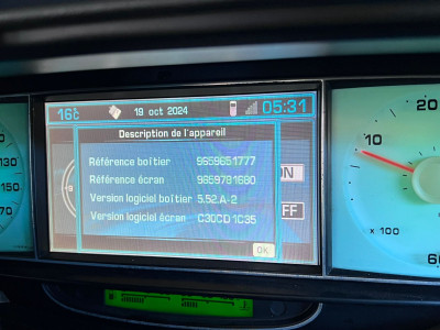

Hello from Lithuania :)
Maybie somenone can help me wiht english language on my citroen c4 gp thans.

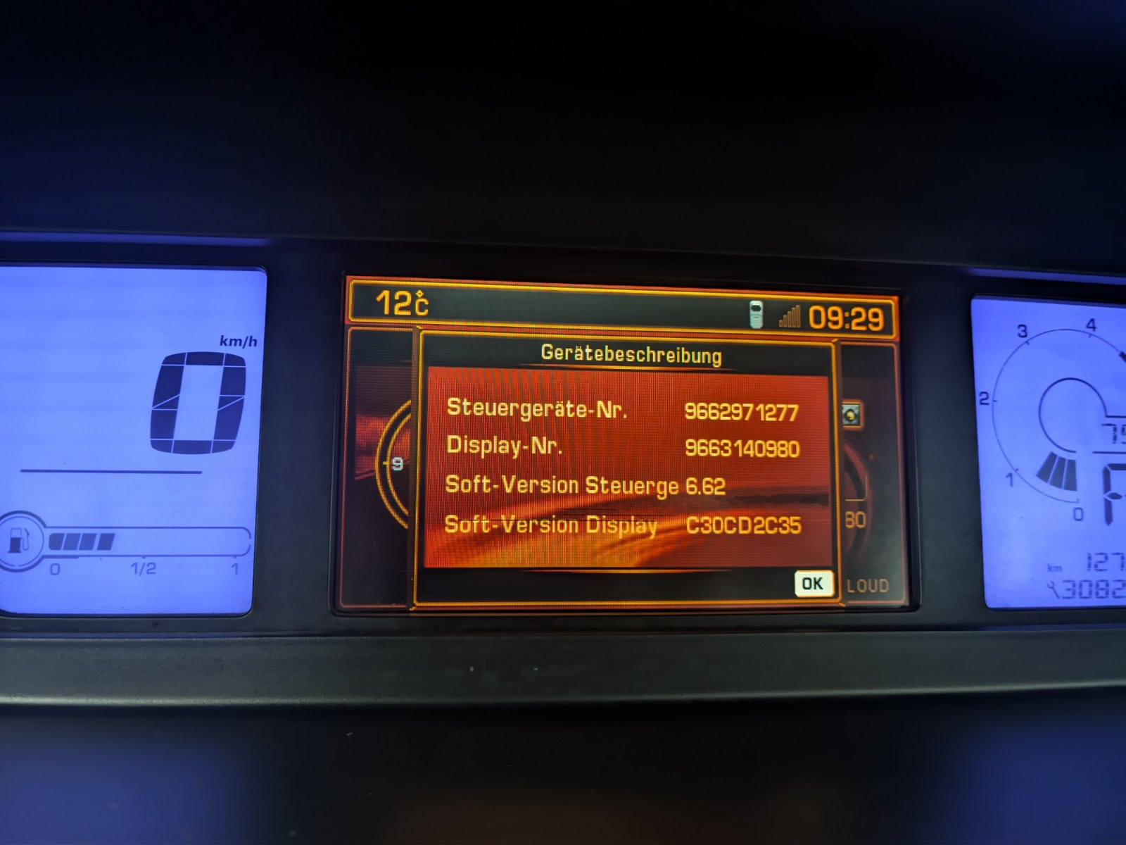

Hello, the menu language of my 2006 model Peugeout 807 is German. I want it to be in English. It wants a CD. I am waiting for your help.
