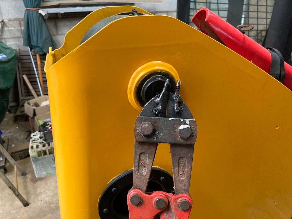

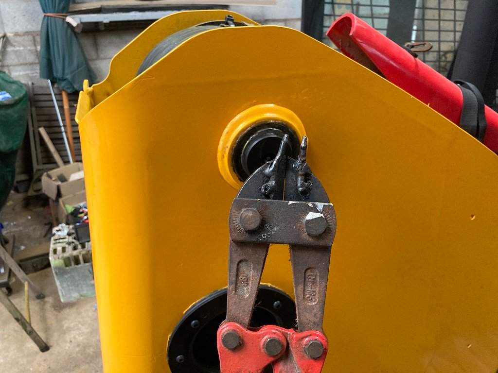

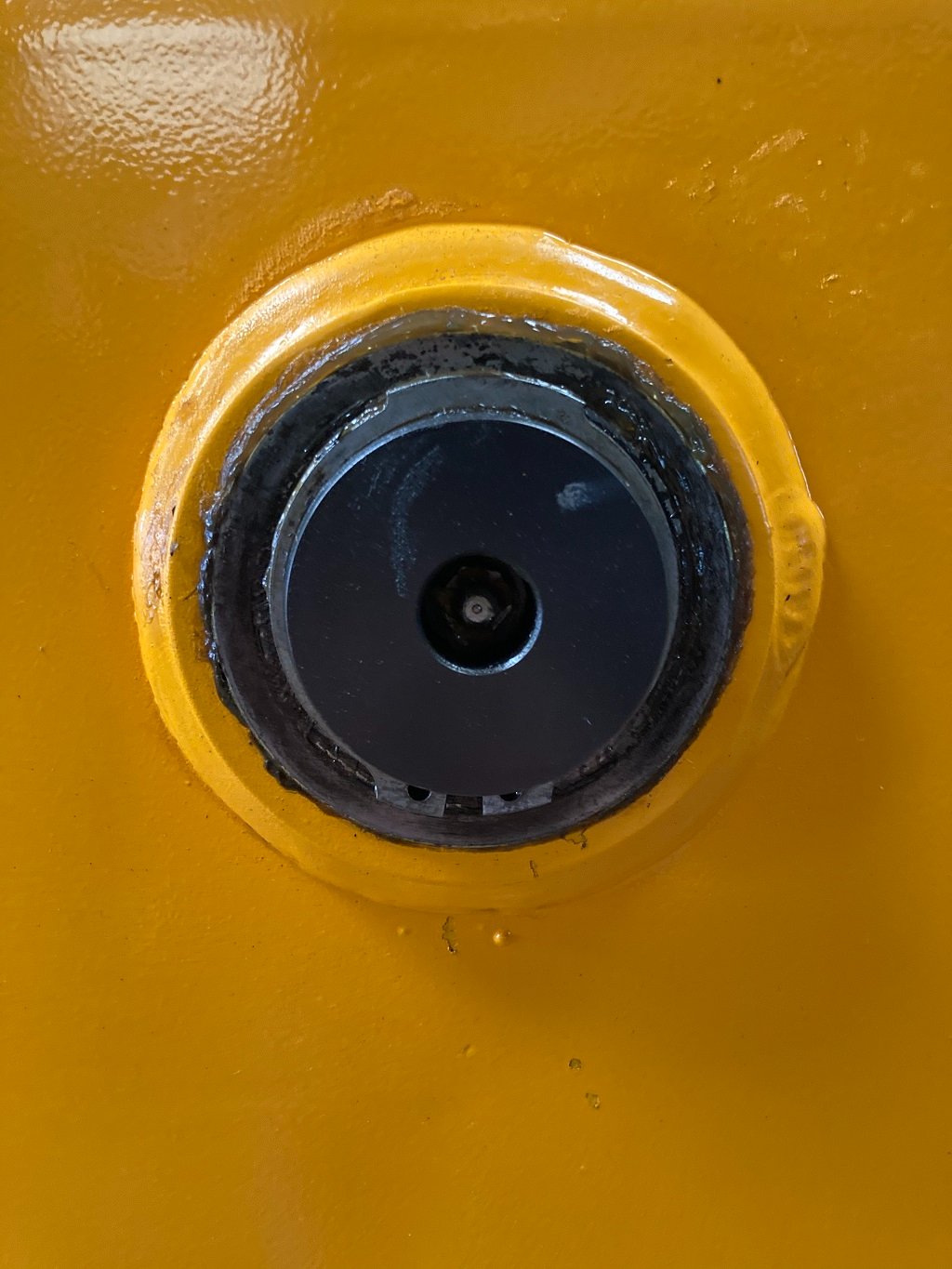

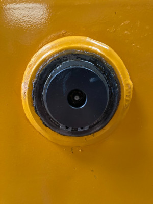

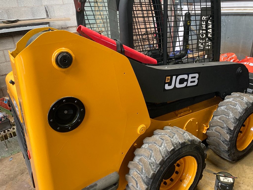

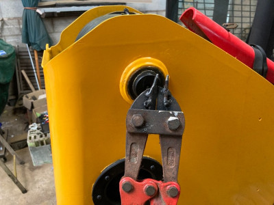

Monster circlip remover
Our JCB 'Robot' needed to have the rear pin changed due to wear. It was retained by a formidable looking circlip visible at the bottom of the pin.
I looked online for tools to tackle such clips and there were some very impressive mechanisms.
In the end I opted for a less high-tech solution:
A screw and a nail welded to the jaws of these bolt croppers just about managed to open the circlip enough to get a screwdriver in.
It did bend the nail due to the strength of the clip. Let’s just say that the full leverage offered by the bolt cutters was required!

I have a pair of identical bolt croppers in my workshop... Only used them once in 20 years to chop battery clamps off their cables but reluctant to dispose of them...
They survived my most recent cull/workshop declutter!

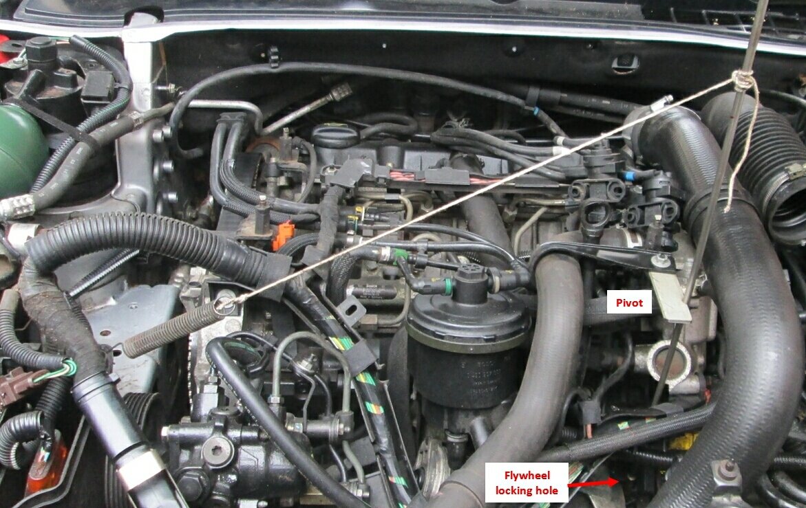

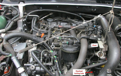

If you've seen my other posts, you can tell I like to over-engineer things, usually as a displacement activity to keep me from doing the job I ought to be getting on with.
So, today, the task in hand was doing a cambelt swap on my Xantia HDi.
This requires the crank to be turned slowly with a breaker bar until a hole in the flywheel aligns with a hole in the block and then inserting a locking pin.
Easy if there are two people, not quite so straightforward when you're single handed.
So, just to prove that I can sometimes embrace quick and dirty, here's my solution.......

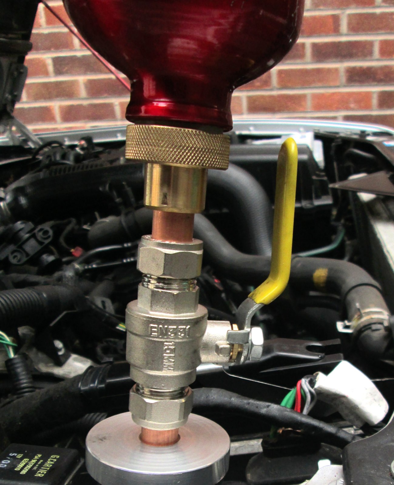

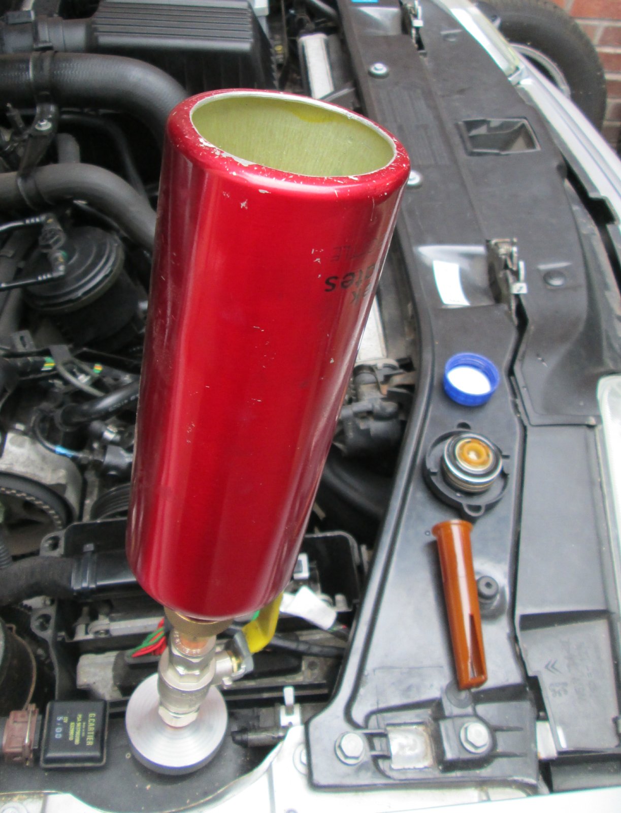

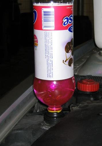

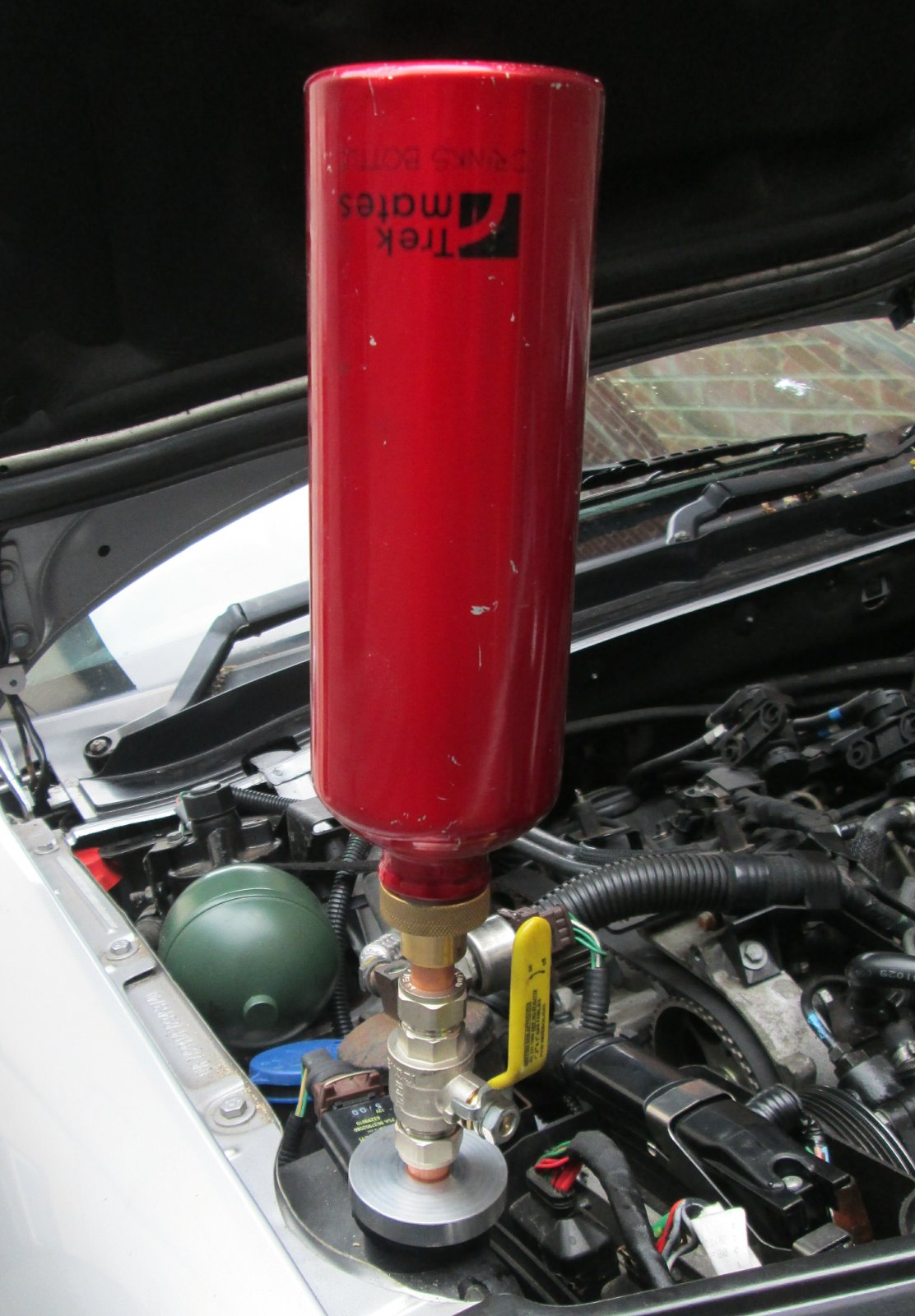

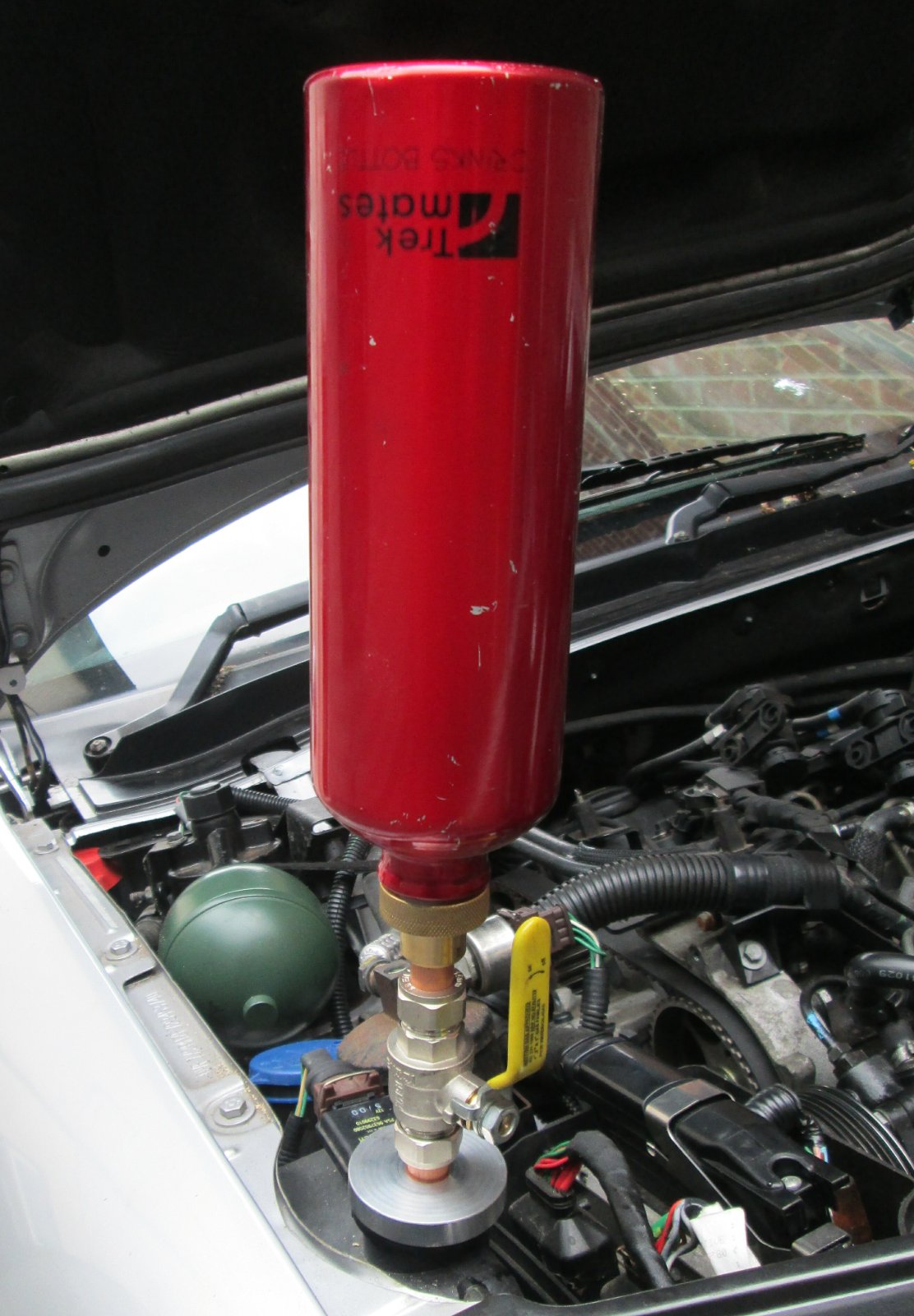

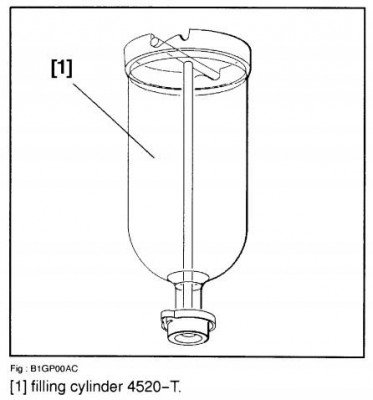

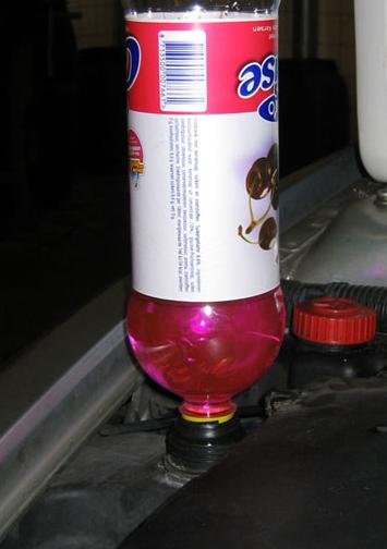

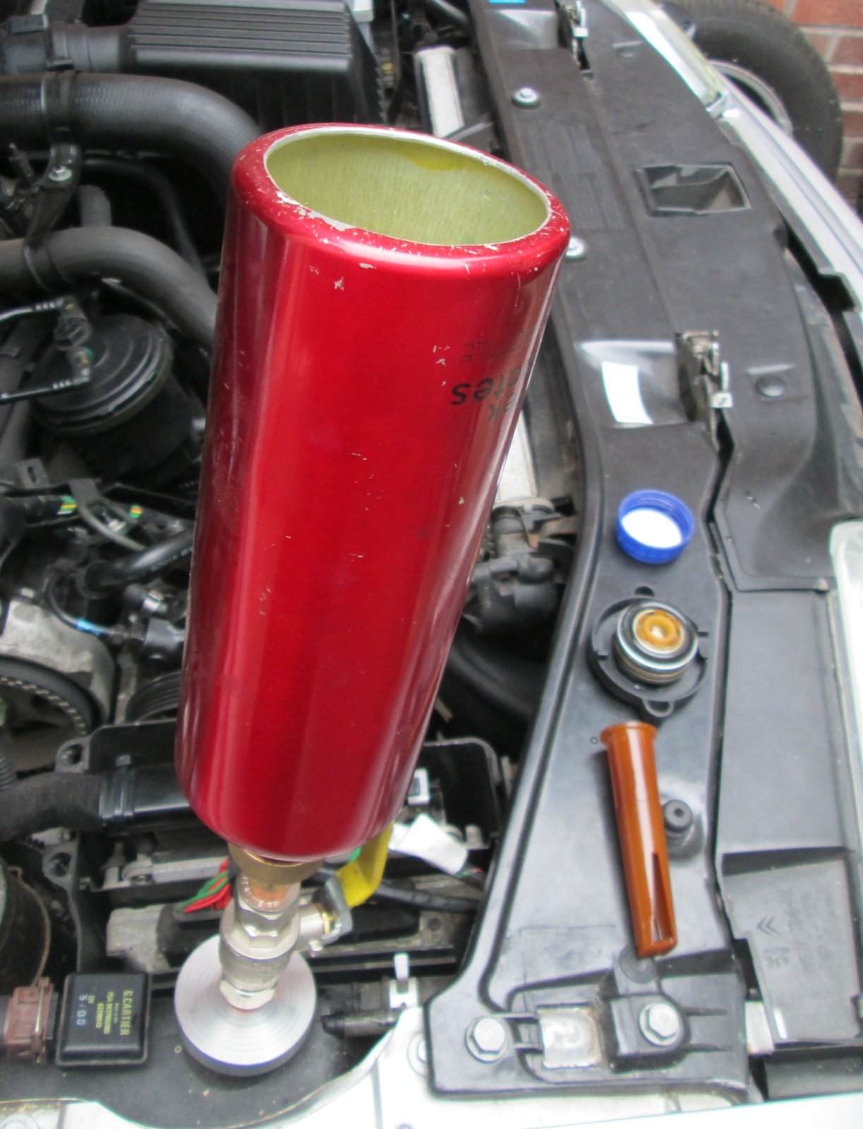

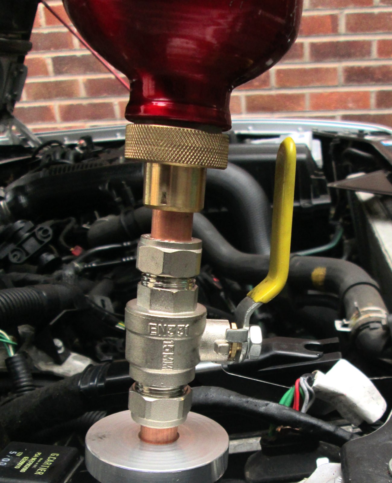

When refilling the cooling system on your favourite Citroen, you can
1) use the official Citroen tool, 4520-T 2) find some random plastic bottle and use that
3) make something hugely over complicated, but that makes you smile when you use it No prizes for guessing my preferred solution
- Posts: 54674
- x 8143
Re: Toolbag Tales-Homemade and improvised tools
Wow! That is just simply awesome

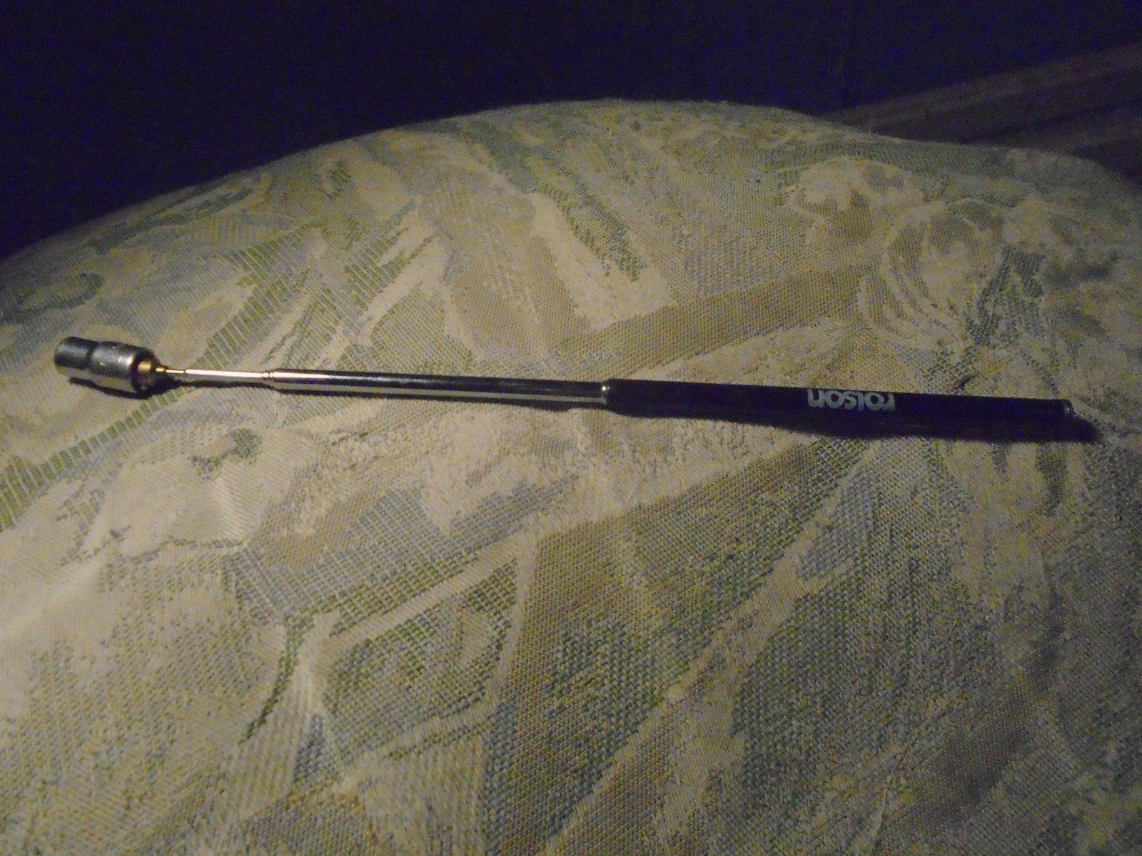

I improvised this tool today, but inexplicably two times in a row, pressed the release lever on the mole grips and down disappeared the teeny weeny 6 mm socket into inaccessible places. That's the time to call for the magnetic pen

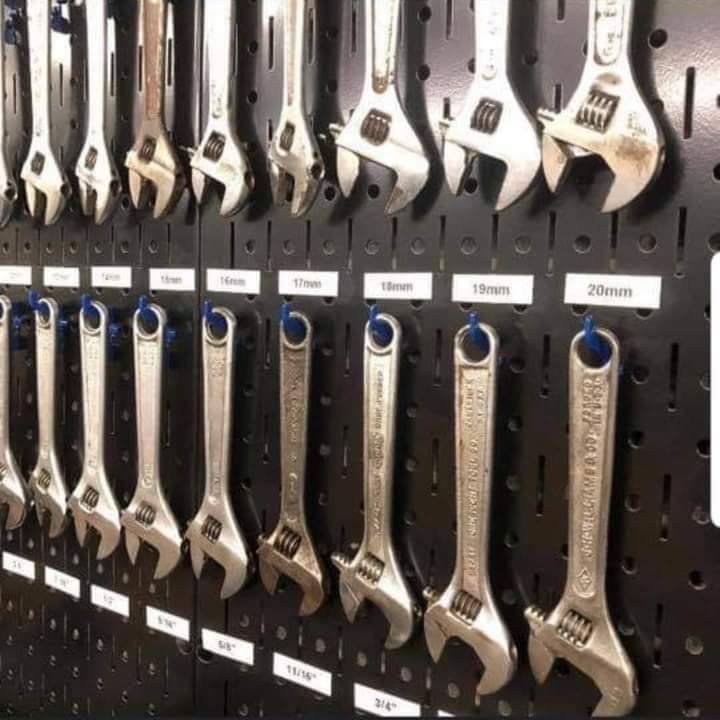

Where the adjustable ring spanners?
