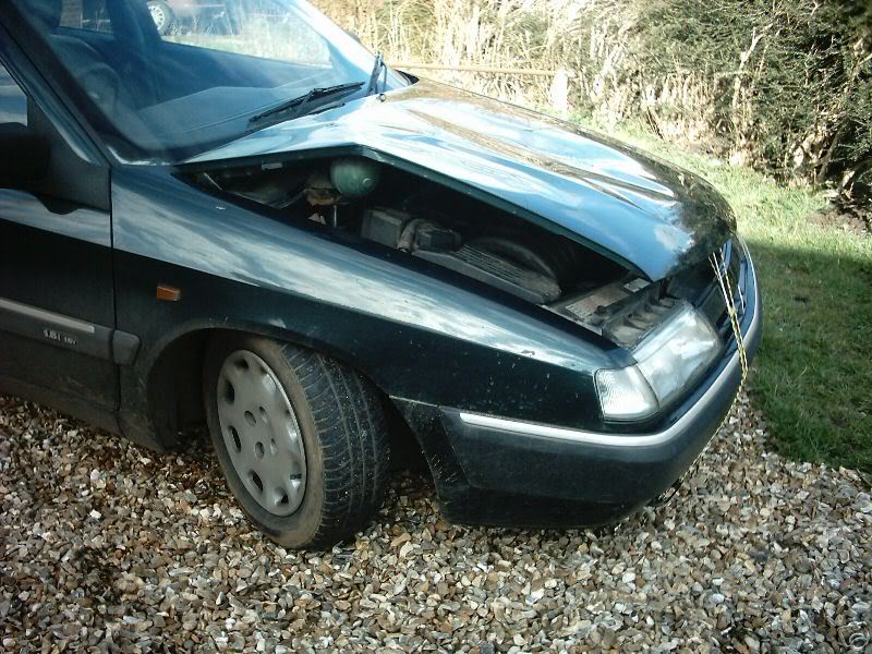

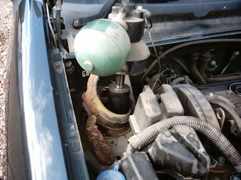

Hohum - another one;
http://tinyurl.com/yzyrar
"citroen xantia SX TD mot till august 25th 2007 spares or repairs,
must see very good car needs front strut!!!"
Ebay item number: 170067847576
Andrew

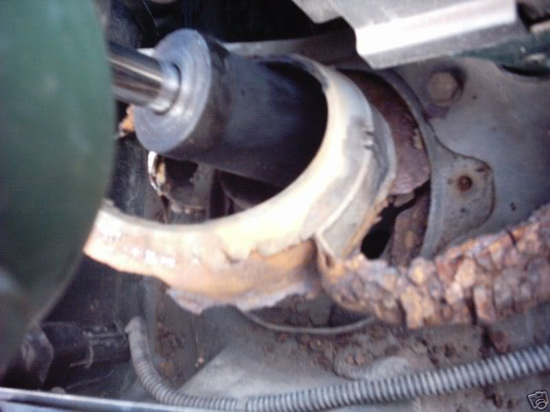

as fare as im aware there is no diferantsas,what normaly kills them is the rubber which is moulded all over the metal parts of the strut top perishes and let the wet in between the rubber surface and the metal,rots the metal away,bongo your stut shoots its self up through your bonnet
regards malcolm

I wonder how long it takes before someone actually gets badly injured or worse when one of these lets go in a big bang forcing Citroen to actually do something...
The car's YET ANOTHER on ebay - this one's only covered a modest 64k miles too! Do other non Cit cars' suspensions fail this badly!?
Andrew

all of these i have fixed its been the metal parts inside the rubber which have rotted through,what i have seen so far is the rubber perishes water gets inbetween the rubber and the metal rotts and bongo,i also belive this could happen at any speed and direction,even in a staight line
regards malcolm
