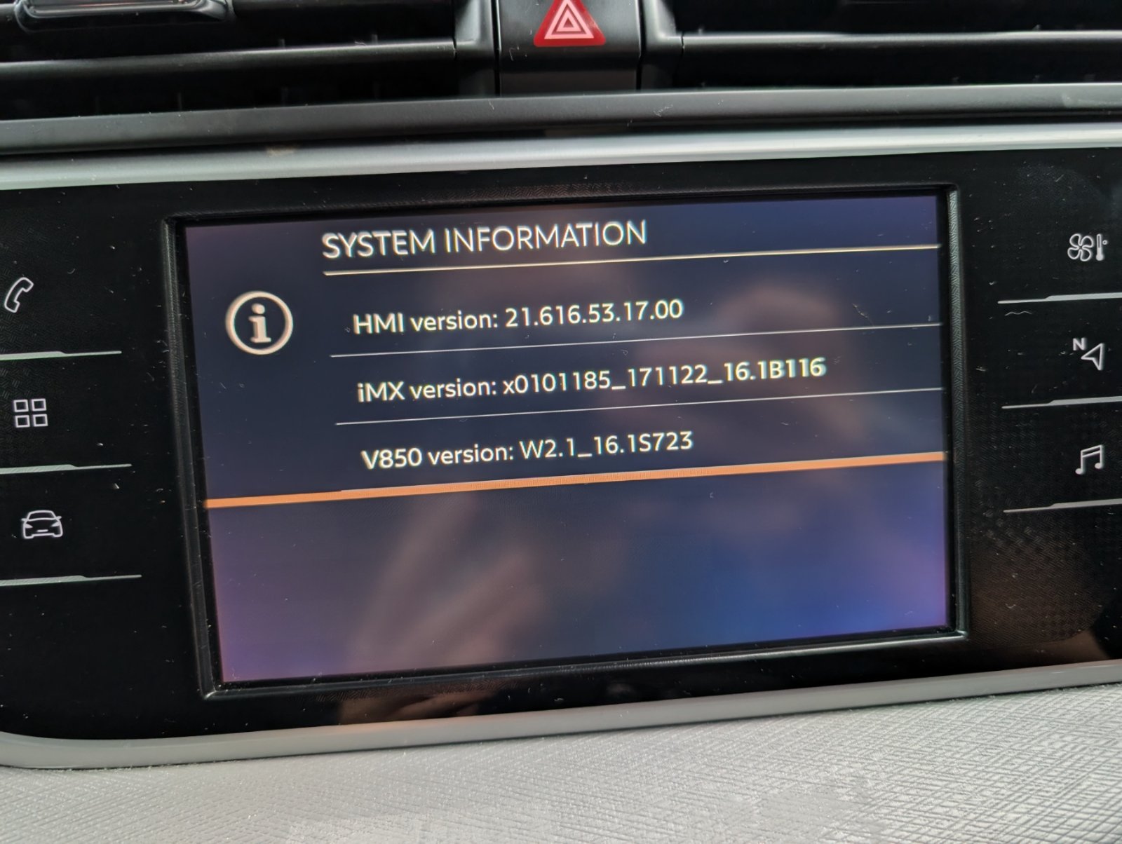

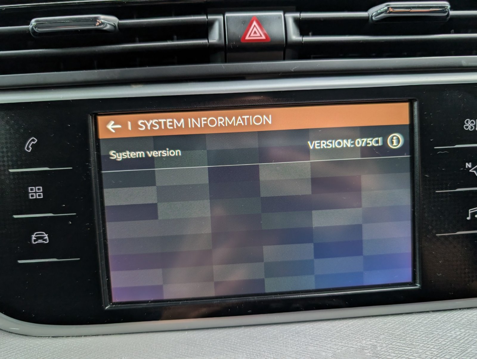

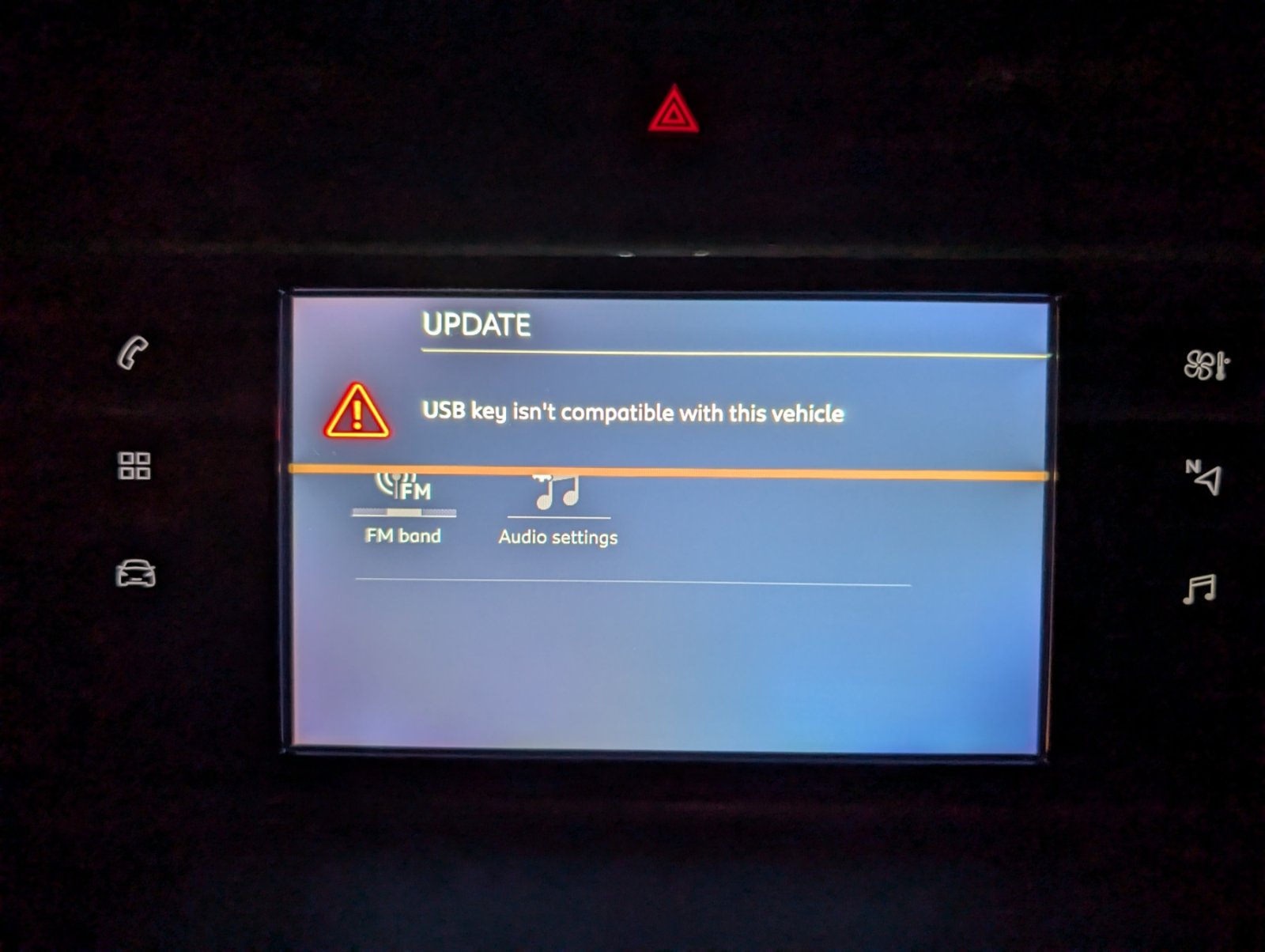

Hello, I am from Japan
I followed this step [Updating NAC or RCC Firmware, Maps, Licences][viewtopic.php?t=81259]
This is my system version But I got this error I tried with 3 different flash drives, still have the same error message.
